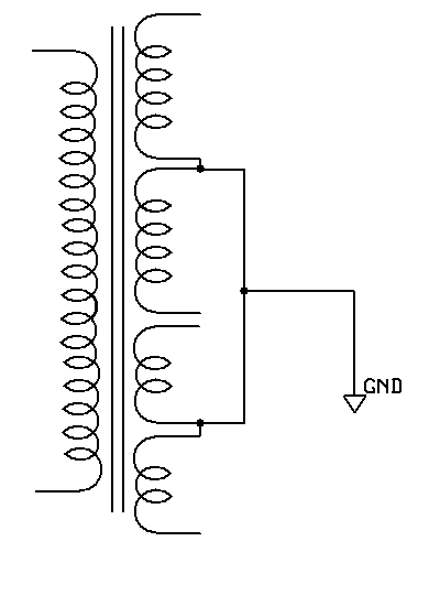

I want to make a power supply for my work bech.
I make this circuit which is below.
I request to Experts, Plz check it and find the errors.
It will work OR not??

Why do you connect your common output terminals (floating grounds) through resistors back at the winding output?
I didnt trace out the schematic for errors but why do feel the need to do any switching with relays?
Best way for connecting
I thinks it is the good way for connecting both common output terminals together for making ground but i don't know why.

I also wan to ask that which is the better way for connecting both common points. Pictures are below.

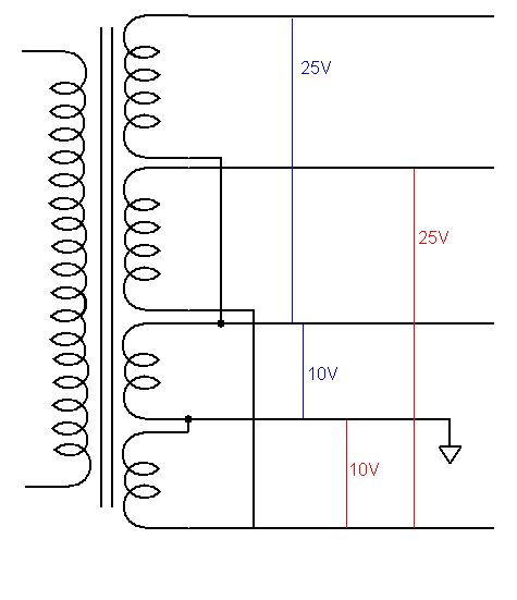

Why are you using two seperate winding?
Why not one with two 11V taps either side of 0V like I suggested in the other thread?
I had rewind my transformer already before reading ur that post. And now i cannot reopen my transformer for rewinding.
Below is the picture. I want to ask that it will work.. If it will work then where to add bridge and capcacitors in it???

There is no problem with stacking windings the way you do (from the transformer side of things) but it depends on what kind of performance you are after. It is not the way I would do it.
Also, you may want to consider reviewing your transformer and design _before_ you wind it and put everything together.. otherwise, whats the point in asking if you cant change it?
