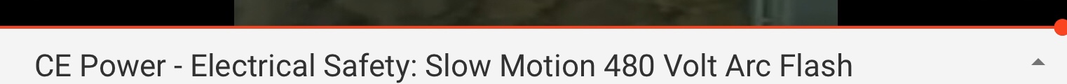

No, working with 120 VAC on a bench or in test stands gloves were not required but don't get caught working on a buss less the required gloves. Electricians very much do wear gloves. Oh wait and let's not the arc flash face shield requirements. Gone are the days of just a T-Shirt also, NFPA 70E has that covered right down to long sleeve shirts and right down the line. Then too, they may have a bit of a point. This is a 480 volt arc flash clip I always enjoyed.

we had an electrical panel that rusted out at a plant in Houston. The accident investigation claimed a piece of rusty metal fell across the 480v terminals and caused an explosion similar to this... (about 1/4 the size sine our guy in hard hat, leather/rubber gloves and fireproof coveralls only had molten metal droplets on his upper body - he was ok).
Video below is also 480v, the title gets clipped unless you click the YouTube link at the bottom of the video.
