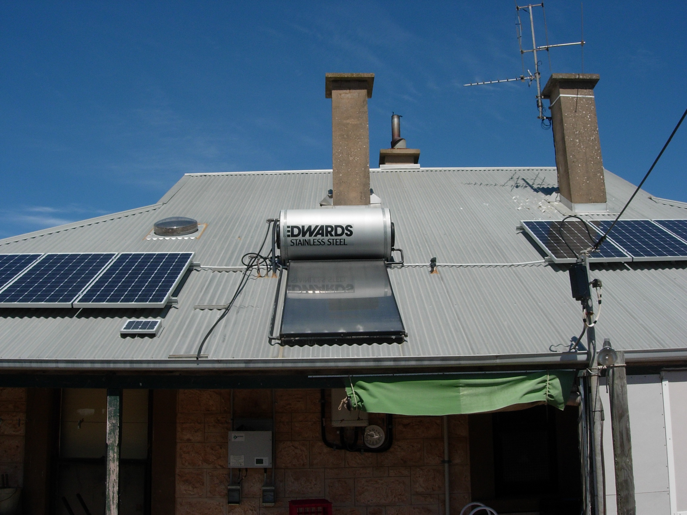

This may be of some help in Solar hot water. Current temp outside is 37 degC average summer day at 3.00PM. This system is Thermal Syphon, the inlet pipe is 48 degC & the outlet pipe is 58 degC. Water out of a hot water tap 55 degC. This system is a mains pressure system & has a pressure relief valve set at 100PSI. At the moment if no taps are turned on the pressure can rise to 100PSI & the valve will start driping water. This solar system works well in the summer, but in the winter it barely takes the chill of the water. So free hot water during summer months. Winter use LPG boosted heater. Hope some of this is some help in your study.
