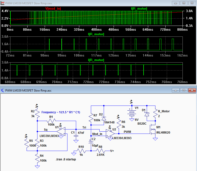

Here's a LM339/393 PWM circuit to generate a turn-on ramp.
It uses a logic-level MOSFET that will work at 6V.
The ramp time is determined by the R7C2 time constant.
For the values shown, it goes from full off to full on in about 0.7s.
R7 or C2 can be changed as needed with a ramp time ≈0.7*R7*C2.
The middle plot shows the startup pulses, and the bottom plot shows the ramp end pulses.
But it may be more complex than the OP would want to build.
  • PWM LM339 MOSFET Slow Rmp.asc
That would certainly do the job.:)
Presumably you would use one of the two approaches in post #17 above to generate the PWM signal.

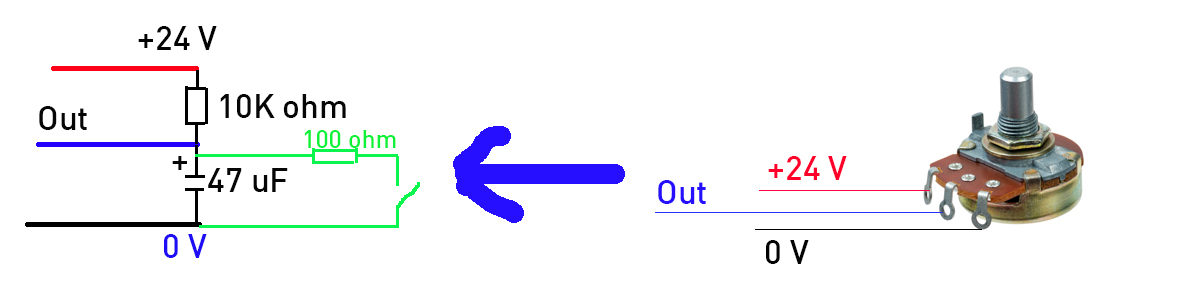

Hi, I am looking for something similar for a child electric car. It has two motors (24 V DC) and a simple on/off pedal, so it "jumps" when it starts.
I would like to add some circuit that makes the start softer without using any potentiometers for the "gas pedal".
Did any of you "solve" this?
Cheers
I'd experiment with something like this, replacing the speed pot with a resistor and capacitor so it ramps up to full speed over a second or two each time it is started.
Depending how it works, you may need to use a relay on the start pedal to switch the start circuit on that and short the cap via a low value resistor to "reset" the soft start each time the pedal is released.
Thanks, I will look into that! So, when pressing the start pedal it should engage a relay that opens the short for the capacitor and powers/enables the regulator/output, right (a relay with two switches, one NO and one NC)? The resistor in series with the capacitor? And two systems/regulators, one for each motor (the motors need opposite polarity)?
It depends how much current they draw - if less that 20A total, you should just be able to wire them in parallel but wires swapped on one.
Everything else sounds OK, though I've never used one of those modules so it's part guesswork.
Just for clarity, the resistor would be from put clockwise terminal wire to the wiper wire, then the cap from the wiper wire to the anticlockwise / minimum terminal.
Try something like 10K and 47uF to start with, and eg. a 47 or 100 ohm resistor in series with the discharge contact to prevent high current spikes on that.
Thanks rjenkinsgb. Not sure if I understand completely the wiring scheme. Can you please explain in more detail?
I just want 100% all the time, so will it be OK to remove the potentiometer, or do I need to have it in place?
Thanks.
Remove the pot and replace it with the capacitor and resistor.
I used the the pot terminal identifiers relating to what connections the wires originally went to, to try and clarify what connected where.
Ok, thanks. I made a connection diagram - does this look OK? Going from the original on the right side to the modified version on the left side?
Schematic wise, exactly right.
(Though the pot V+ may well be a rather lower voltage, eg. 5V or 10V).
The relay contact would be normally closed. Common symbols for contacts, for reference:
For info, you have the pictorial pot connections reversed - the wiper sweeps all the way around the "back" (in that view) as it's turned clockwise, so the near terminal is the max speed voltage connection to it and the far one is the ground / 0V.
