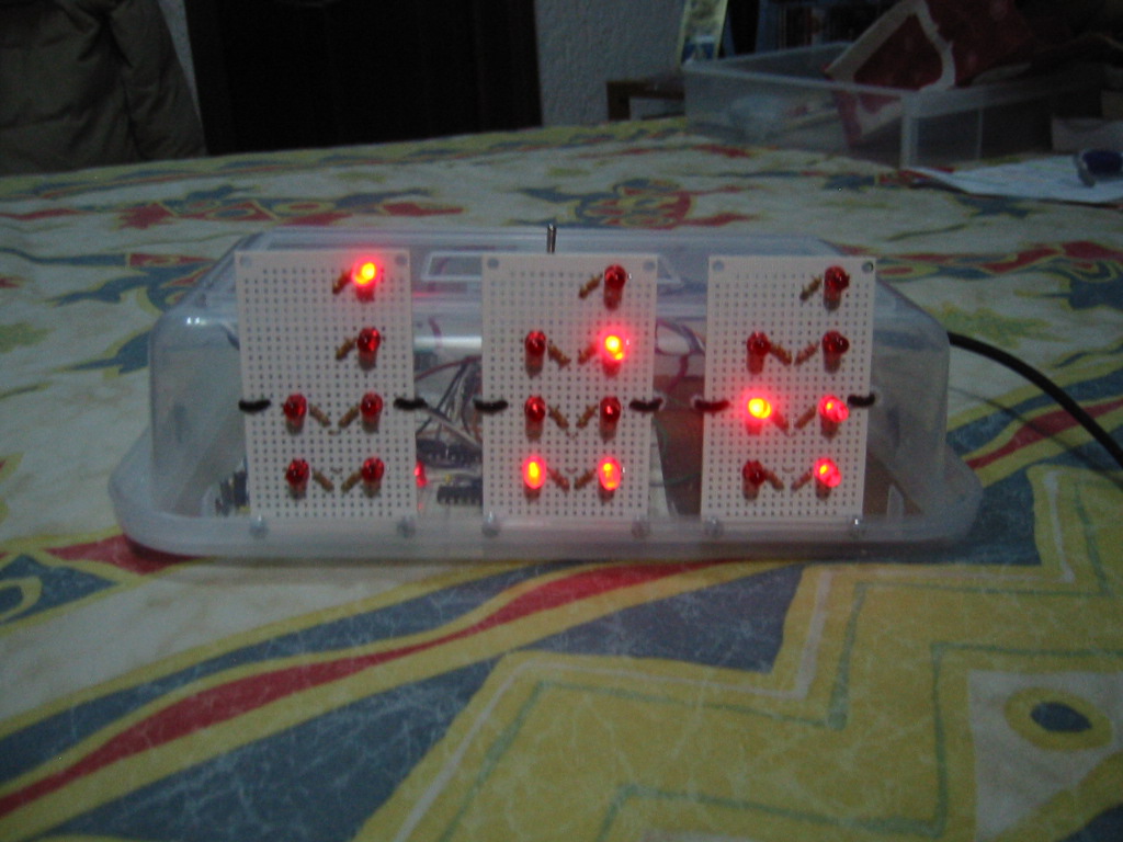

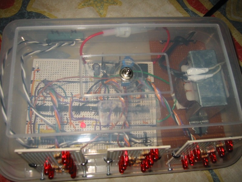

Ok, It took QUITE a while but it's finished.
I know it looks like your granny's old (and I'm not talking about the case only) but TTL gates and that sort of stuff is all the technology I know so far.
Sure someone can pull this one out in micros (or something more advanced) but not me, not until next semester at least!
It takes a while to assemble and you need extreme care so that you don't mix up any connection...
And DON'T take a leaf out of my book, I only passed wires over the ICs because the cables already cut were like that on my protoboard and I had no time for measuring, cutting and stripping new ones!
I'll be watching this topic so... any questions just post!

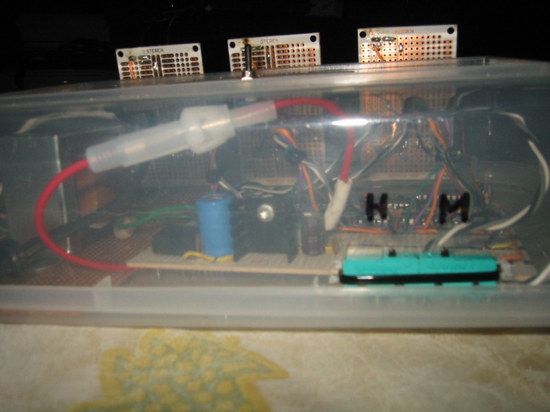

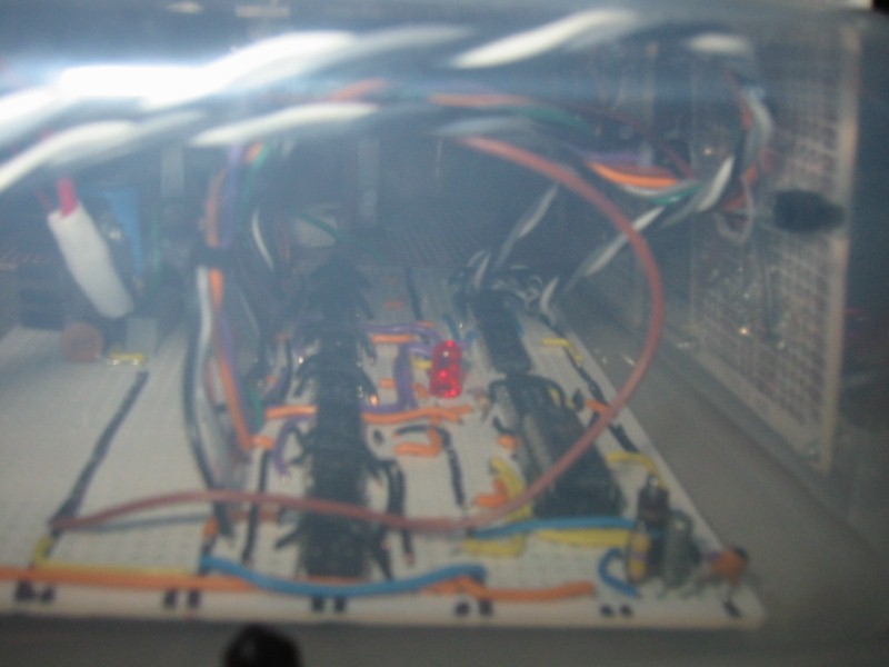

More Pics...
More pictures...

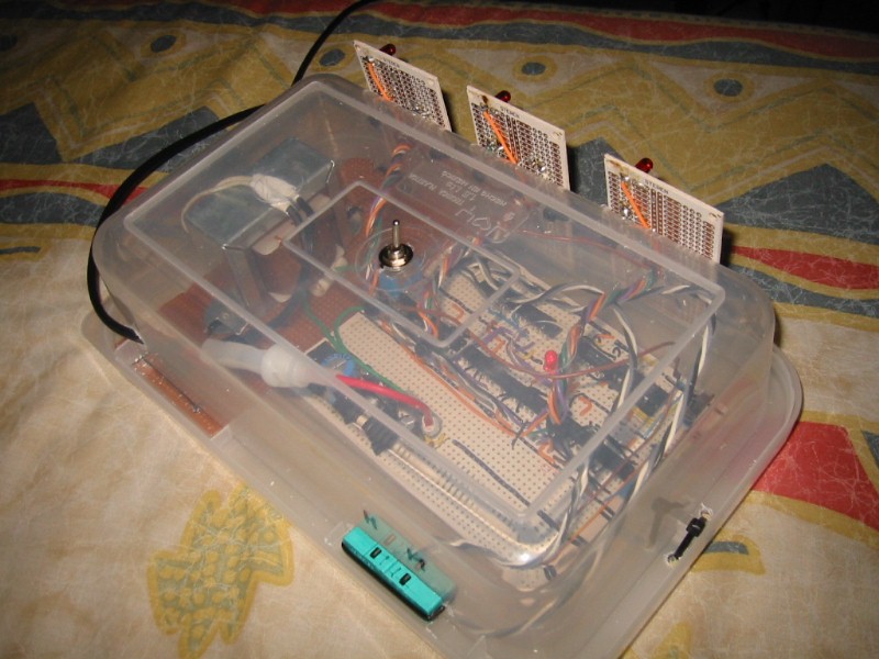

Notice I added an additional switch that turns off all the leds (except the inner one that blinks every second) just in case you can't sleep with all that mute rave on your room. (Obviously time keeps running while lights are off).
I usually like the back-to-the-future see-trhu look so don't go on thinking that I was short on cash and raided the kitchen. This is brand new tupperware technology! :lol:

And many thanks to the people from tupperware and the duct tape that holded it all there for me wile I worked...

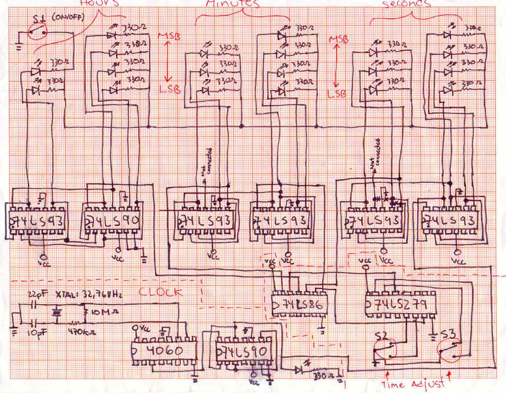

Important!
***Don't overlook this!***
Notice there is one 7490 among those 7993's
I couldn't figure out another way for the last "digit" to be reset when it needed to. :?:
So I included a decade counter (not a four bit counter like the others). 7493 counts to 16 (15 actually) but 7490 is reset in 9. (That's right is it not?)
And also check this: 4060 is CMOS technology so be careful you don't want to zap it while handling I even used a IC socket so that I didn't have to solder teh IC itself.
In case you're wondering, the 7486 is an XOR gate, I'd explain what I used it for but that would be an awful lesson of logic systems coming from me... I'll just leave it on: It helps you adjust the time without interfering with the clock running on its own.
And the 74279 is a latch used to make a bounceless switch (I think that's what it's called) so that the time advances only one minute or hour for every time you press the button (it would go two or three, several times en every push because of the mechanical oscillation that occurs when you push it...)
Last of all, notice those switches are momentary SPDT.
Let me know of any comment (not concerning the technology used, for I already said that I know it could have been better and more power-effective and smaller, but not with my science, I haven't gone so far yet... maybe next year).
And if you build one post some pictures for us!
Good Luck!

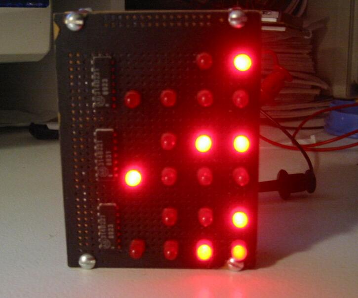

So the clock on the image where you can see the leds on reads:
08:15:13
:arrow: thanks to mechie for the correction, it should read: 08:15:23
Hope I made myself clear...
Good luck again!
08:15:13
08:15.23 ?

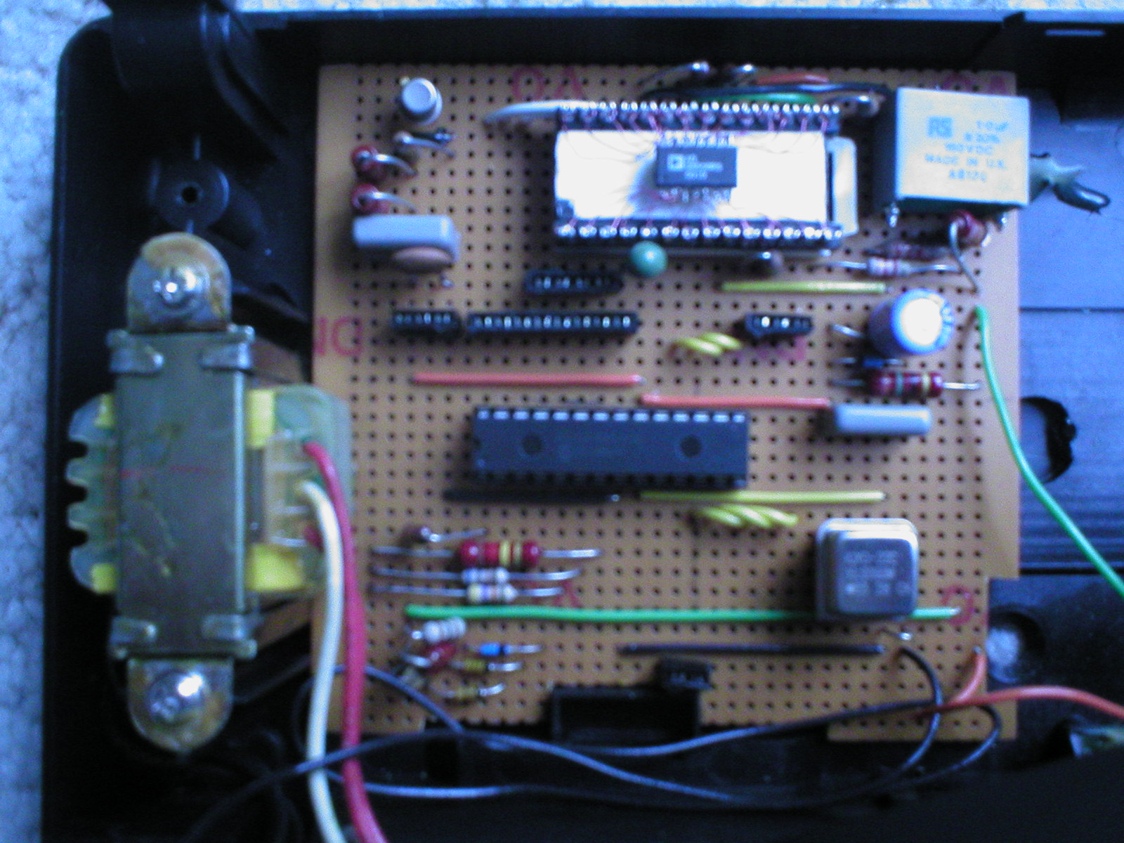

This is excellent! I love to see someone taking an idea and sticking with it to completion, the photos really make a difference in understanding what you have achieved.
As for your method of construction, I see nothing wrong with it - I prefer to get a project working first and 'pretty' later (if at all !), wires jumping over ICs add to the drama, a neat printed circuit board makes things look much simpler (less scary for people not 'in the hobby').

errata
My mistake,
Mechie is right, it is 08:15.23
I thought I'd made at least a mistake with all that...

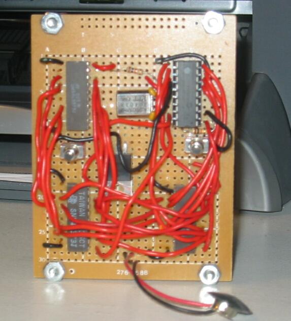

I was interested in making a binary clock and this is what i ended up with. I does not track time as good as it could because i ran out of time and interest at the end. I loses about 2 minutes everyday, but is fun to watch. I built it using a 16f628, (3) 57ls373's and a few resistors. The top 2 rows show the hour in bcd 24HR format and the 2 middle rows show the minutes and last 2 rows show the seconds.
It's very nice! (And it doesn't take up the space of the refrigerator!)
Time base is no problem, really, just a couple extra components... (Check the bottom-left part of my schematic)
I'd be very interested in seeing your schematic if you have it and are willing to share it.
Greetings!

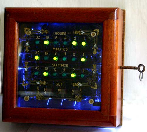

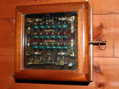

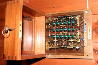

This topics a bit old now but here's a few pics of a binary clock I built a few years back.
The display is on sheet of clear plastic sheet. The main cct board is mounted behind and is lit by blue LEDs. The wooden box has a glass front so the wiring and components can be seen fron the front.
Brett.

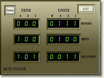

Desktop Binary Clock
Here's a link to my windows binary clock **broken link removed**
Its only a tiny file about 100k. It does not need installing just run the single file from where ever you extract it to.
This is made to simulate my ideal binary clock using 7 segment displays rather than leds. This may be a bit expensive to build in real life!
Brett.

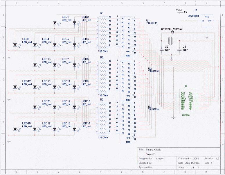

In the above sruger's circuit, the idea of using 3 additional ICs, 3 resistor packs and all the wirings for driving LEDs seems strange to me as we are using a PIC here. It can do the job perfectly all by itself.
Just arrange the LEDs in a matrix and scan the row using the port lines. With only a max of three LEDs ON at a time the 20mA pin current output of the PIC can easily drive high efficiency RED LEDs without the need of extra transistors. One therefore needs only 4 resistors for all the LEDs.
There you go. A working binary clock using a PIC, a 4MHz crystal, LEDs and a few capacitors and resistors. Don't forget to add push button for adjusting the time.
Yes, I was surprised to see so much components on what seems to be a pretty simple PIC project. But if it works...
It just goes to show that some of us are more comfortable in software and others in hardware. The best of us have probably learned when to use both together efficiently...

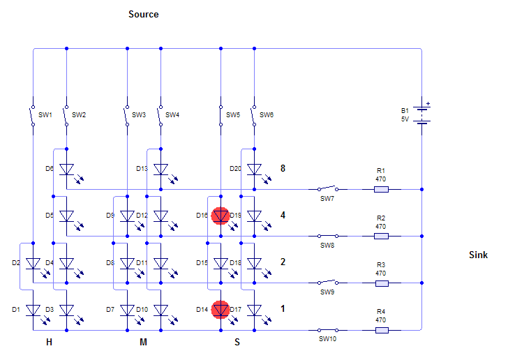

See attached schematic. It is roughly what eblc described, or at least that's what I was aiming for ;)
Each SPST switch represents a PIC port pin. I used resistor values to let ~7mA flow through each LED, so that I don't need transistors.
Now, is there an easy way to get dimmed LEDs for zeros? I tried a lot of ways, but it's probably out of my reach for now, because I ended up with blown LEDs, blown resistors, or randomly lit LEDs at every attempt I made. I initially thought that using the right resistor values to kind of "bypass" each switch would do it... it's probably not that easy. Am I at least on the right track?
