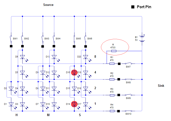

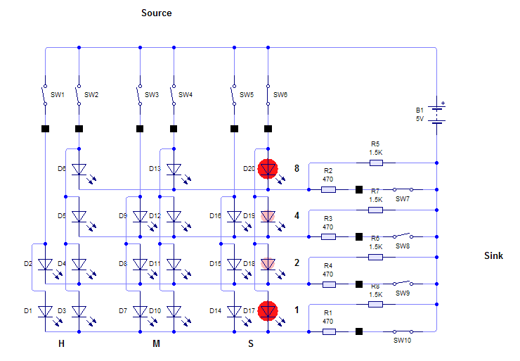

The port pins can only switch to HIGH or LOW, so I amended the circuit.
If you want a dim LED, you can consider adding high value resistors(only one shown in drawing) directly bypassing the PIC control resulted in dimly lit LEDs . See circuit.

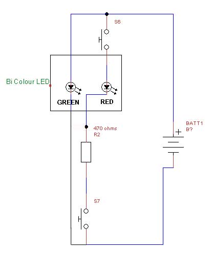

I've had an idea using Bi Colour LEDs. See pic normally the Gn Led would light showing 0. When S6&7 close the Red led would light and Gn would go OFF due to the higher forward voltage of the Gn LED showing 1.
I pesume you could reverse this by swapping LED connections and adding series diodes on the Red Led.
Brett.
Brett.
Nice. I'm not sure which idea I prefer, dim & bright or bi-color. I'm affraid 2 colors would be hard to read?... unless the 0 (green) is made a little dimmer and the 1 (red) brighter?
Interesting idea of using the slightly lower forward voltage of red LED to turn off green LED.
Only one problem though, those bi-color LED never exists. :shock:
You have made separate connection to all four legs of the bi-color LED but the actual one I have seen all have the common cathode connected internally(3 legs) or connected back-to-back(2-legs).

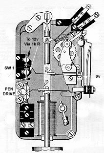

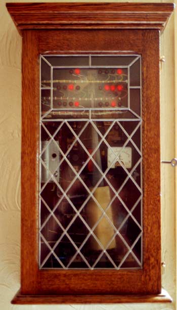

Pendulem Controlled Binary Clock
Here a pic of a Pendulem controlled Binary clock I built around 20 years ago. This clock had a half second pendulem that operated a change over contact once a second.
The clock is around 2ft tall and is wall mounted.
The pendulem was energised by a hip togle switch every 14 seconds.
The binary clock drive was connected to the change over contact by a noiseless switch.
Brett.

That's correct. I included the extra LEDs to keep the display balanced.
I did a similar thing on my binary clock on page 3 of this post. The last LED on the hours display is never used.
