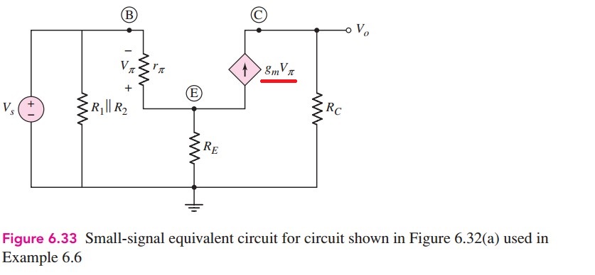

I study basic BJT amplifiers ,
but there is problem in AC analysis circuit in figure 6.33 very difficult for me :confused:
please can you help me how I can see the circuit and analysis?
thanks,

A transistor will not work with its collector resistor connected to ground like that.

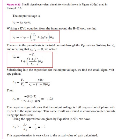

thanks sir,
thank you for homework...
I not understand more for this homework because I steady first time amplifier......
please can you explain how I can analysis same this (in red square )?

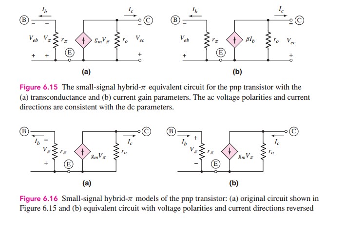

I have small question, what different between (gm v-bi) &(B ib )?
what meant by transconductance ?
when I use (gm v-bi) and (B ib ) in circuit?
is mean the (gm v-bi) = (B ib ) same in calculation?

The small signal AC model is a linear model that does not consider DC biases. Thus the collector resistor is connected to (AC) ground for the purpose of the analysis.
