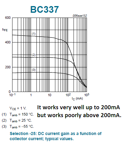

Do not operate the BC337 transistor at its maximum collector current because it works poorly above 200mA.

A
graph in the datasheet shows the current gain.

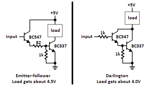

You want the BC337 to turn on and turn off but its base needs about 50mA of current for its collector to saturate with a load current of 500mA.
Your signal does not provide 50mA, it has only about 20mA or less
Then a common-collector (emitter-follower) NPN transistor can be used to provide 50mA when its base uses only 5mA or less. Its collector MUST BE POSITIVE or connected to the collector of the BC337 to make a darlington pair. When the input signal to the base goes positive then the emitter follows and also goes positive but at a diode voltage drop (0.7V) lower.
A PNP common-emitter transistor and a series resistor can also be used to drive the BC337. But it inverts the function.
I do not know why you do not show a clear and tidy schematic like this:
EDIT: Hee, hee. the forum's new software does tricks when you insert a schematic!

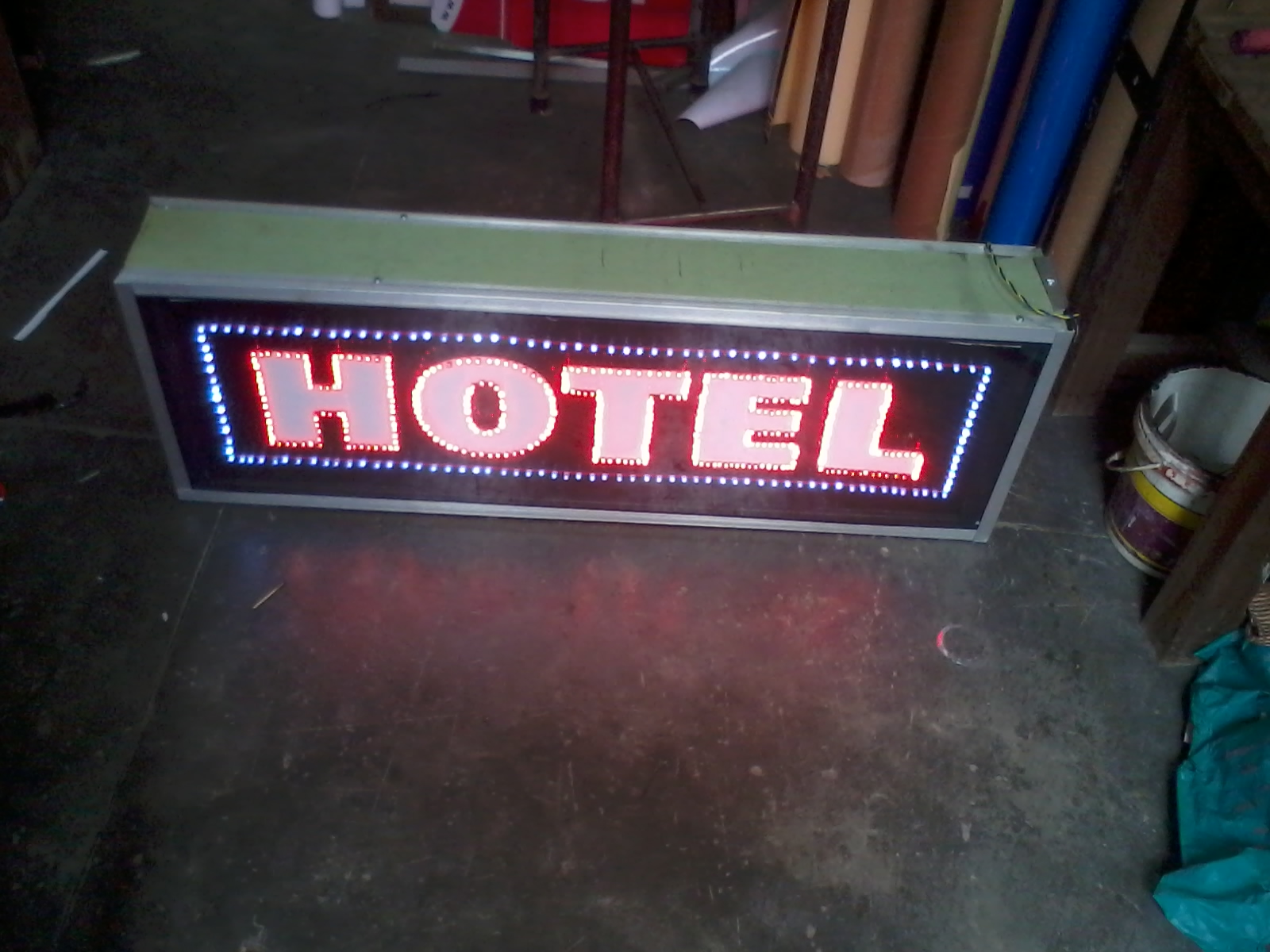

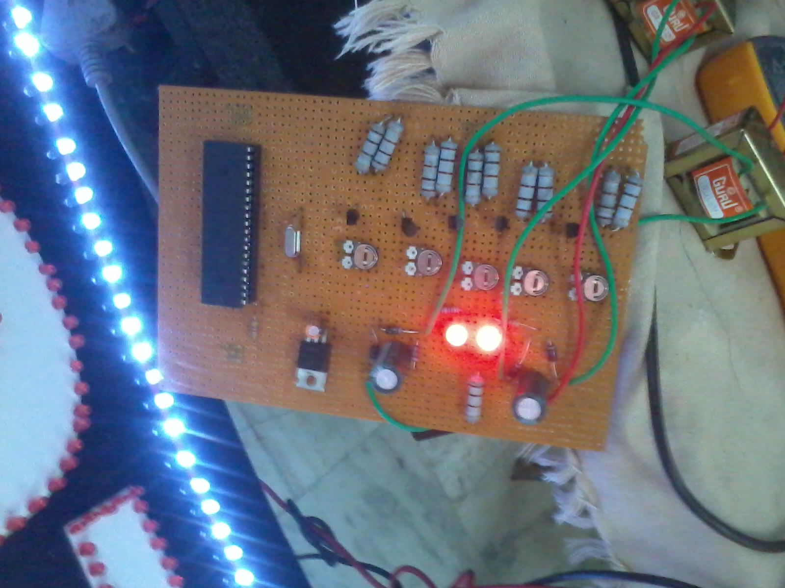

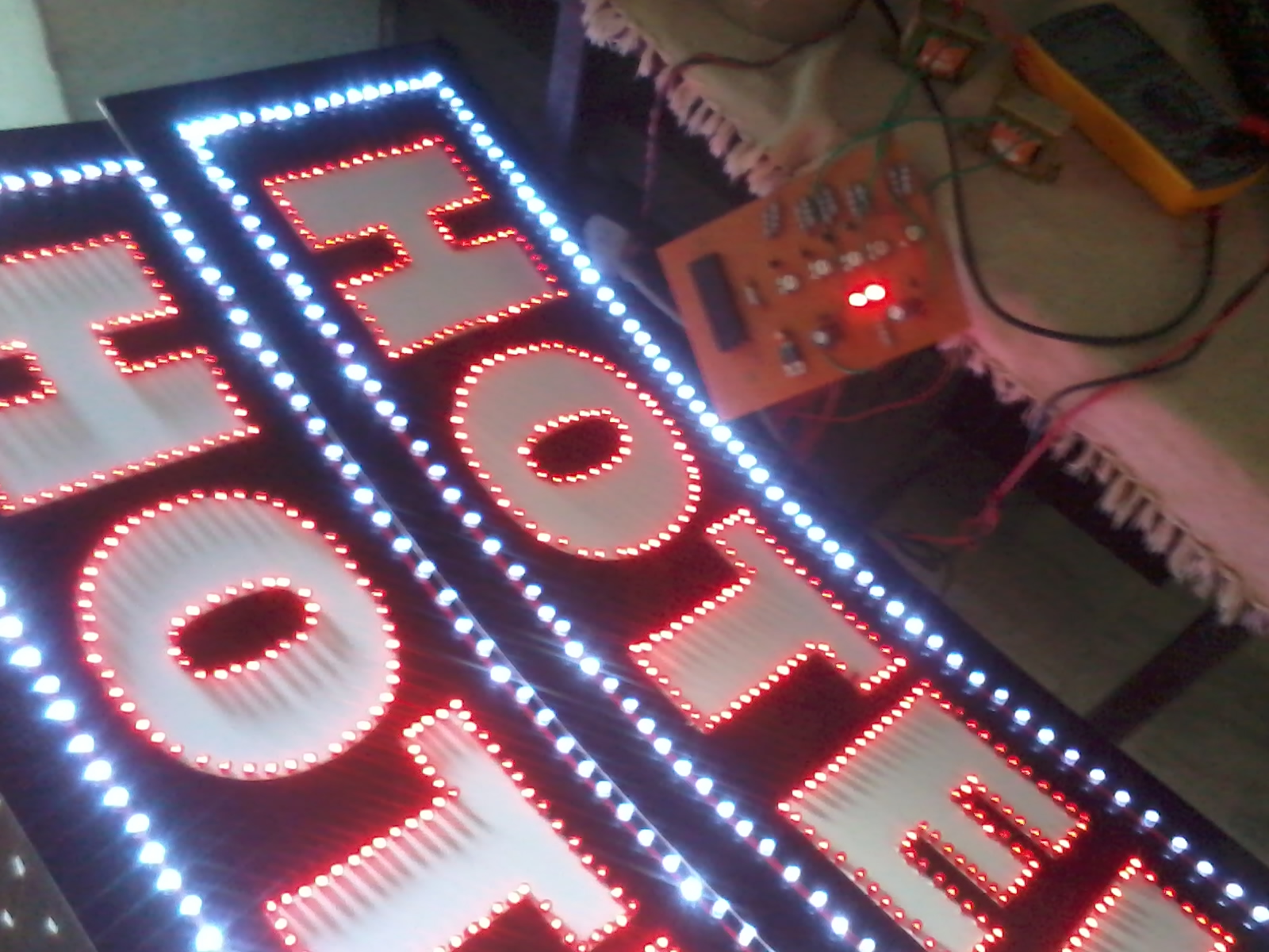

Hi, here is the result...

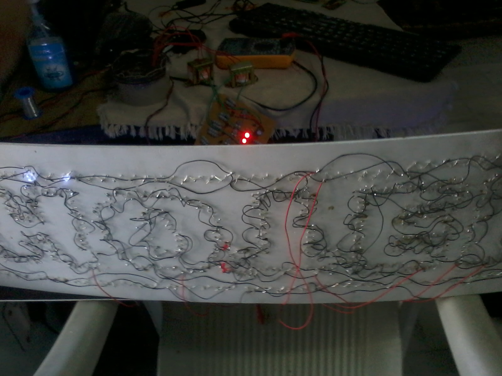

It is obvious that each LED has a different brightness. Some LEDs look like they are turned off and other LEDs look like they are ready to burn out.
Just like we told you!
the viewing angle problem, anyway how to make equal?
how to make equal?
LEDs in parallel MUST all be measured then only the few with IDENTCAL forward voltages can be connected in parallel.
LEDs in series all operate with the same current and will look the same brightness. But each series string might have different brightness.
Chinese flashlight companies pay somebody almost nothing to measure and sort LEDs into groups that have IDENTICAL forward voltages.
