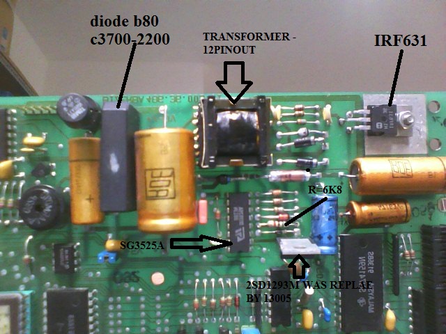

dear all!thanks for helping.

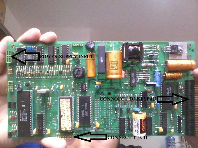

i have not experience about this circuit. when i received this circuit it have error. i connect it to power supply, and then i touch on each component, when i touch on DIODE B80 3700 2200, suddently 2sd1293m burn. I replace 2sd1293m by MJE13005, i checked all of resistor, resistors are good! i checked irf631, it good too! then i connect the circuit to power supply and the circuit still not working, i checked voltage on each component and share with everybody. so that what i done before i come with you!

So what you have been trying to say is that you are measuring 33.6 volts at the collector of the TIP122?
yeah!at first, i replaced 2sd1293m by tip122, but, Mr.ronsimson reminded me that 2sd1293m is npn transistor, not darlington transistor. then i replace tip122 by MJE13005.!
Check diodes in the bridge rectifier with power off.
Look at output of bridge rectifier with scope.
You may have shorted AC to the DC rail.
Replace driver chip,
and now all other silicone parts are suspect.
..... all other silicone parts are suspect.
