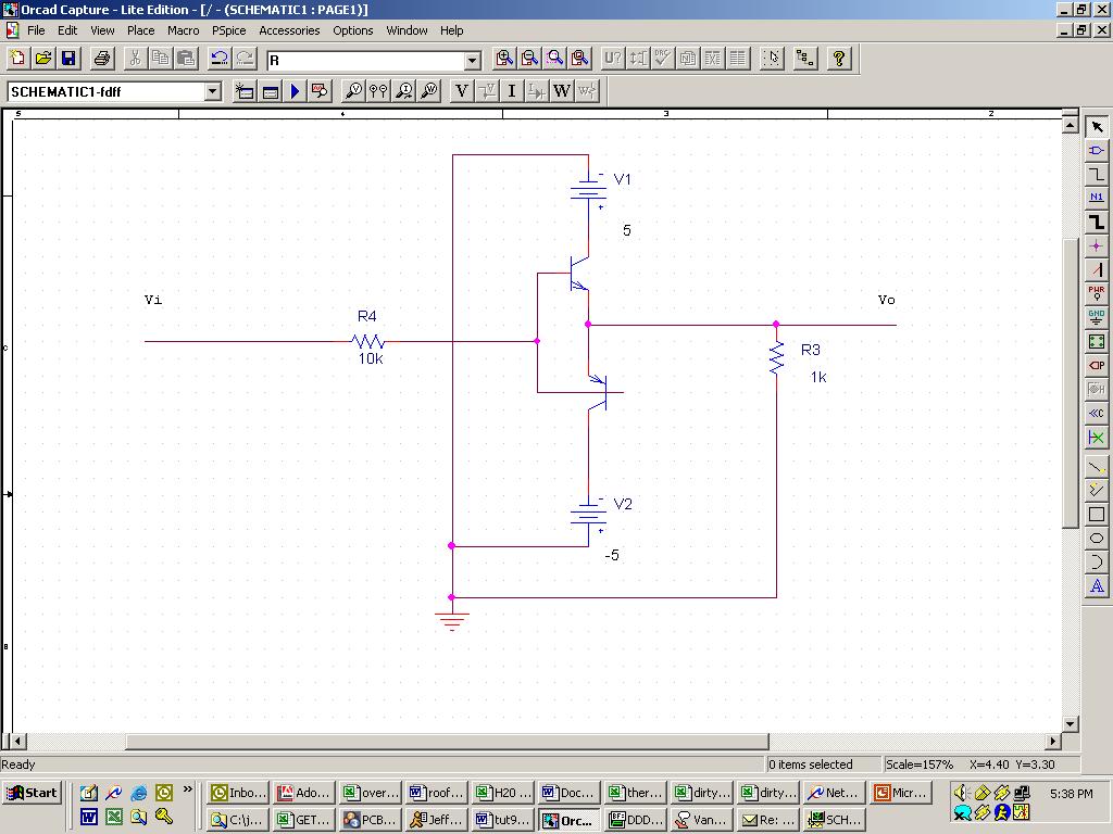

how do I modify a transistor in pspice to behave like the simplified models that I'm using for my calculations?
What's the deal with this circuit here: we are supposed to solve for Vb (in between the bases and the 10k resistor) and Ve (shown as vo) when Vi= -5 and -10V.
Are the transistors in saturation mode? (atleast for the -5V case?) I remember building something similar to this in my circuits I class, we used op amps to make an audio D/A converter, and this was on the end to give enough current/power to the speaker.

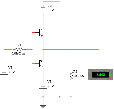

Sam, something is hosed in your sims. When the input is -5v, the PNP acts as an emitter follower, and the emitter voltage should be about -4.1v. The base will be at about -4.8v (both these values depend on PNP beta). When the input is -10v, the PNP saturates, and the emitter will be at about -4.9v. The base will be a Vbe drop lower, or about -5.6v. The NPN never turns on, so is not a factor in this circuit.
Simulators can be very misleading - although I ran this on SwitcherCAD III and got results very close to those I predicted.
Jrz126, this is a push-pull emitter follower, but it only works well for analog signals if you keep the input signal range well within the collector supply voltages (+/-5v in this case). It will have significant crossover distortion unless it is embedded in a feedback loop containing a fast slew rate op amp. As a stand-alone circuit, it is good for driving heavy loads with digital or switching inputs.

anyway, why doesnt the NPN ever turn on ????
The NPN remains off because the load resistor (1k) is returned to a voltage (GND) that is more positive than the base voltage, so the base-emitter junction is never forward biased. The B-E junction must be forward biased for the transistor to be on.

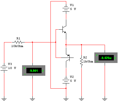

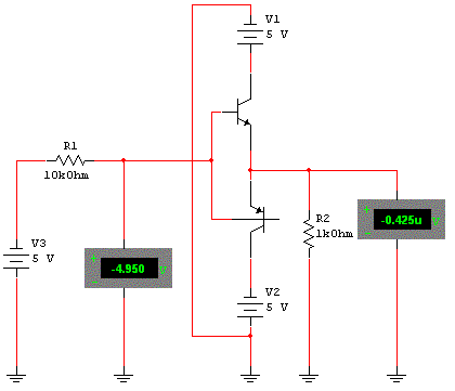

i know that this is a very old topic that i am replying to. but today i was looking at a simillar circuit (the one in the book Microelectronic circuits which jrz pointed out). i remembered that multisim gave me wrong results for this circuit. so i simulated this circuit again on multisim and saw the output. but i was still getting wrong values. and there were really strange things happening with other circuits i had. so i did a reinstall of Multisim and voila!!!!!! everything works right now. the following are the results that i got after simulating this circuit in multisim. the results are simillar to those predicted by Ron_H
so just to set the record straight here are the results that i got
