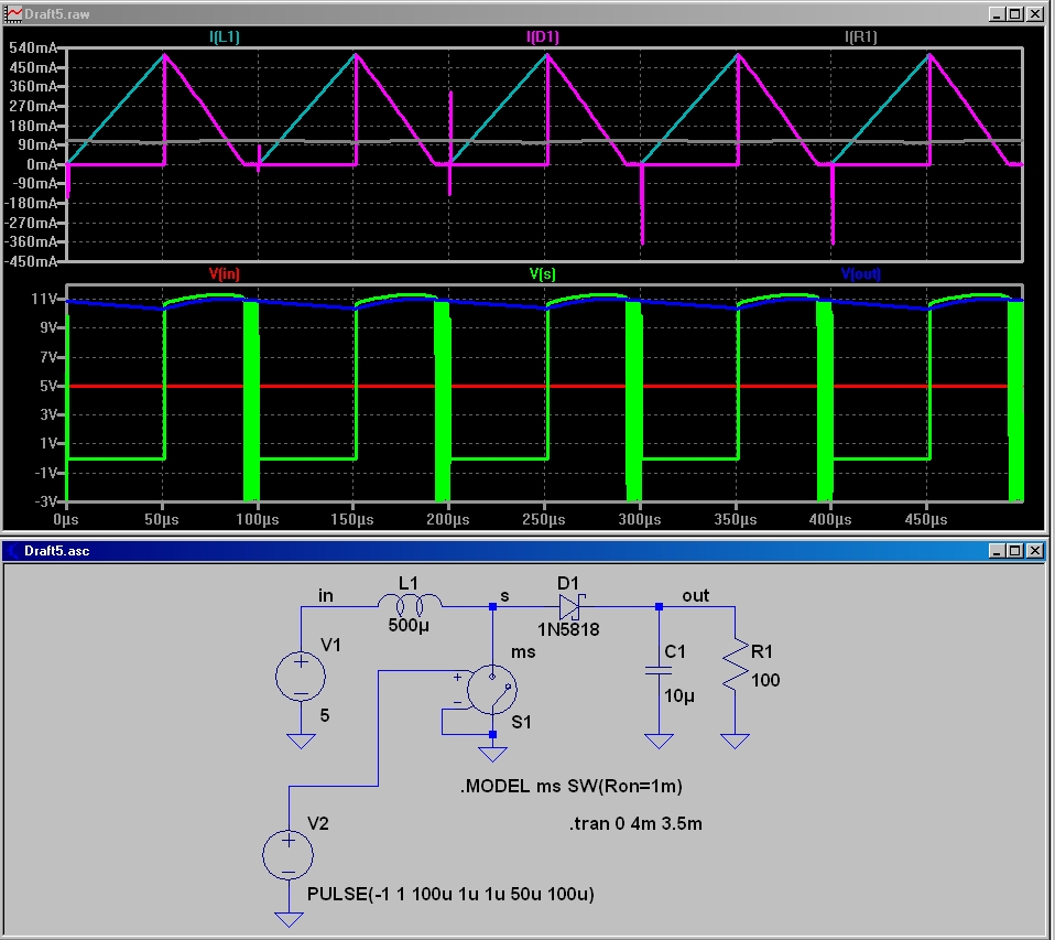

First we prove by construction that such a periodic state exists. I've discussed it for a simplified situation where the resistance of the inductor and the voltage drop across the switching element are neglected. The article linked by indulis covers the more realistic case as well as continuous vs discontinuous modes.
Then we examine whether this state is stable or not, i.e. when you are away from this state does the system want to return. The key here is the equation:
Ldi/dt = V1 - Vd - Vc
Vc is also the output voltage and controls current delivered to the load, iout = Vc/R. The integral of iout over one cycle plus the change in the charge of the capacitor over the cycle must equal the integral of the current through the inductor while the switch is open. In the periodic state the charge on the capacitor does not change over a cycle.
Now suppose Vc is higher than that for a periodic state, then the integral over the cycle of the current delivered to the load will be higher that the case where Vc corresponds to the periodic state. On the other hand the current through the inductor will decrease more rapidly than in the periodic state with the result that the integrated current through the inductor while the switch is open will be less. Thus the output from the capacitor increases while the input to the capacitor decreases and the capacitor discharges and Vc decreases toward its periodic value.
By a similar argument if Vc is lower than that for a periodic state it will tend to incease toward its periodic value.

In a switching regulator there is feedback, of course, that detects the output voltage and adjusts the "on" period of the switch to give the desired output voltage, increasing the on-time to increase the voltage and reducing the on-time to reduce the voltage.
Look at this:

Good catch. The integral of the inductor current is only over the time the switch is open since that is the only time the diode conducts. The integral of the load current is over the full cycle.
Your solution to the differential equation for current is incorrect, but that's not relevant for this discussion.
The simple equation for Vout as a function of Vin and duty cycle is only valid for continuous mode operation. When the load current drops below a critical value the mode of operation becomes discontinuous and the formula for Vout becomes more complex. This is one reason for using feedback. If the "on time" is not reduced for low load currents the Vout will not obey the simple formula and will rise too high. Also the simple formula is only an approximation for the continuous mode, and feedback will permit the controller to adjust the duty cycle so that exactly the desired Vout is produced. The converter will reach a periodic state without feedback, but the output voltage may not be what is desired.
Ripple is reduced by using a larger capacitor and/or a higher frequency. Higher frequencies also permit the use of small value inductors, while maintaining continuous mode operation.

Feedback has no significant effect on ripple. It's to maintain a constant output voltage independent of a varying input voltage or output load.
MikeMl's simulation output is steady because the input voltage and output load are constant. It has reached an equilibrium point for the particular input voltage, output load, and duty-cycle he selected.

The voltage source is in series with the inductor so the current through the inductor is the same as the current through the voltage source at all times. When the switch is open this same current flows though the capacitorand load with it splitting and part going through the capacitor and part through the load.
Neglecting losses due to the resistance of the inductor and the voltage drops across the diode and switch, the power supplied by the voltage source must equal the power delivered to the load. Therefore
Vin*Isource = Vout*Iload
or
Iload = Isource*(Vin/Vout)
where Iload is the average current supplied by the voltage source and Iload is the average current supplied to the load.
