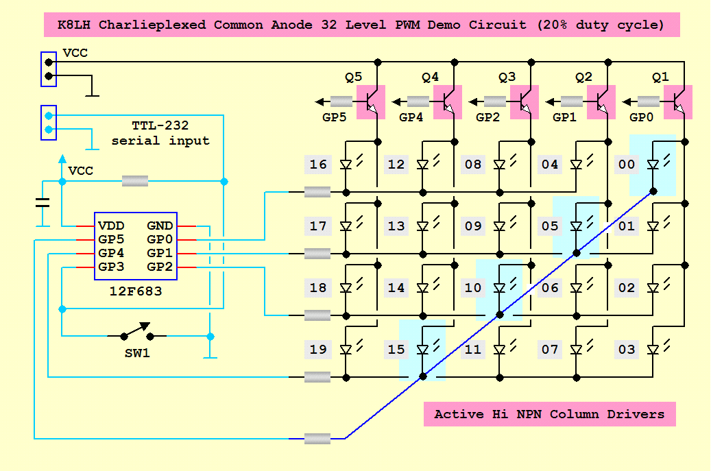

Sorry for the confusion guys. I installed a push button switch on my board to use within the program for selecting different modes. Then I suggested that you don't really need the ICSP/RUN slider switch because the push button switch is normally open and it won't adversely affect PICKit2 programming operations.
OK, now I'm really confused. :p Doesn't the programmer need to hit VPP with 13V to program the chip? Or does it both connect VPP to ICSP and change modes at same time when pressed?
EDIT: Oh. It's connected to VPP until you press the button? That makes sense.
Well I don't have an ICSP jack on my board but if I did the switch would always be connected to the VPP pin on the ICSP connector so you would have to make sure you didn't press the push button while you were programming the PIC.
I suppose if I were to put an ICSP connector on the board I would just use three jumpers to isolate the GP0, GP1, and GP3 pins and ICSP signals from the rest of the circuit.
Again, sorry about the confusion.
Also updated my drawing (below) to show the new push button switch and to show the RS-232 connector which has been on the board (but not included in the schematic).
Mike

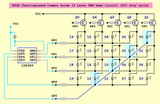

Mike please help me I have a problem.
I’m confused with the duty cycle & the refresh rate in a LED matrix system.
Are they are two different things or one?
In your schematic it says 20% duty cycle. Does it means each LED driving on 20% duty cycle? 20% means almost 1/5 from the brightness, which is too dim.
If I have a matrix of 5 columns & 8 rows is there any formula to calculate the best delay in between the columns? So I can display it nicely without flickering & with a decent brightness.

They are two different things.
Duty cycle is the amount of time in a period that an LED is lighted. In that 5 column display each column is updated one at a time and so each LED in that matrix can be lighted for 20% or 1/5th of the time.
Refresh rate is how often you light each LED in the display over time. It's usually expressed in Hertz (cycles per second). In that 5 column display each column is lighted for 3.2 msecs and so it will take 16 msecs to update the entire 5 column display. The refresh rate is therefor 1 / 0.016 seconds = 62.5 Hertz.
Yes, each LED can be lighted 20% or 1/5th of the time. A 20% duty cycle is pretty good for a multiplexed LED display.
The duty cycle pretty much determines 'peak' current requirements to light an LED to full brightness. To get a brighter display you can increase the duty cycle and/or increase 'peak' current available to the display.
My understanding is that a refresh rate of less than about 60 Hz may cause an LED display to be perceived as flickering.
If you're updating your display one column at a time and you'd like a 60 Hz refresh rate, then;
1/"number of columns"/"refresh rate" = "update interval"
1/5/60 = 0.00333 seconds (3.33 msecs)
You can also use that formula to test different interval timing;
1/"number of columns"/"update interval" = "refresh rate"
1/5/0.002 = 100 Hertz (when using 2 msec update interval)
As I mentioned, to improve brightness you would increase duty cycle and/or increase 'peak' current available to the display.
