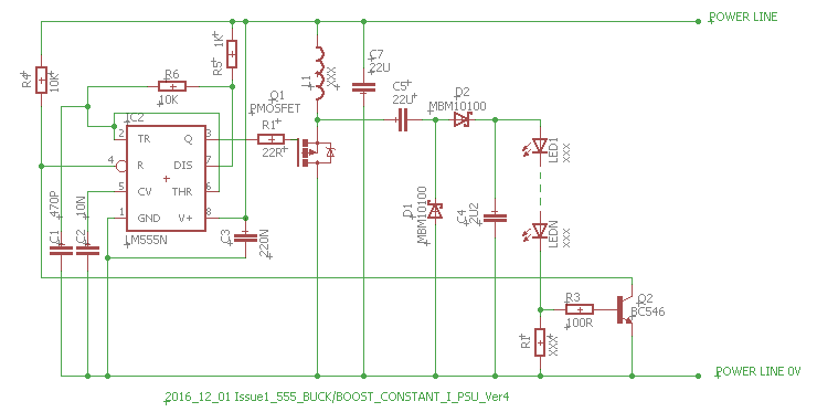

Buck Boost with 555
I don't see how. :confused:
If the MOSFET turns off for any length of time, then the output will charge to the supply voltage minus the diode drop.
How can the output go below the supply voltage?
That's what I was trying to say in my post (#8)
Can anyone pls explain how the circuit in post#4 will behave as a buck-boost.
Yes, my error. The inductor needs to have a secondary winding. I had transposed from an inverting buck/boost inverter, using a PMOSFET, without realizing the consequences.
As it stands, the circuit of post #4 is a boost controller only.
spec
Modifying Mr. Spec's drawing:
If you want the output voltage to be more/equal/less than the input voltage then:
L1 kicks up through D1 to produce a voltage on the LEDs. (note the LEDs are not on ground but the supply)
When the LED current reaches a point it will turn on Q-PNP. (Base is on supply. When the Emitter is above supply by 0.65V the transistor will turn on.)
When Q-PNP is on it will turn on Q1 and turn 555 off.

Probably should make R4 (bottom right) a 10k resistor. OR Make R4 (top right) a 100 ohm resistor.

I also updated the circuit of post #4 to make the converter buck/boost (I hope).
spec
You could configure the 555 as a monostable, and use the reset i/p to form an astable oscillator based on current sensed on the o/p, similar to a current mode switching controller.

Below is the outline circuit I started with (timing components and decoupling capacitors not shown), but then got a bit careless transposing from a PMOSFET to an NMOSFET.:banghead:

Hi all,
I think the circuit below may do the job (buck/boost with NMOSFET)

I'm designing a buck-boost converter using 555 ic
So this project is to make a 555 do a job it was never intended to do. Thanks to Mr. Spec's cleverness it works.
A buck/boost is hard. The idea of any input voltage and any output voltage is what makes it hard(er).

Great circuit, using a well known 555 timer chip. Can you give some instructions (calculation formula) how to calculate the inductor value? I'd like to drive 4 CREE XML T6 (~12V output) with 210-300 mA. The input voltage varies between 6-12 Volts. Thanks.
Ron Dekkers site shows you how to design a very similar circuit, only he uses the control input instead of the reset, the circuit doesnt have the constant current driver as its a high voltage supply, but it can easily be adjusted for lower voltages.
https://www.dos4ever.com/flyback/flyback.html
Note Ron' s circuit is a boost, I've used this circuit for either buck or boost.
