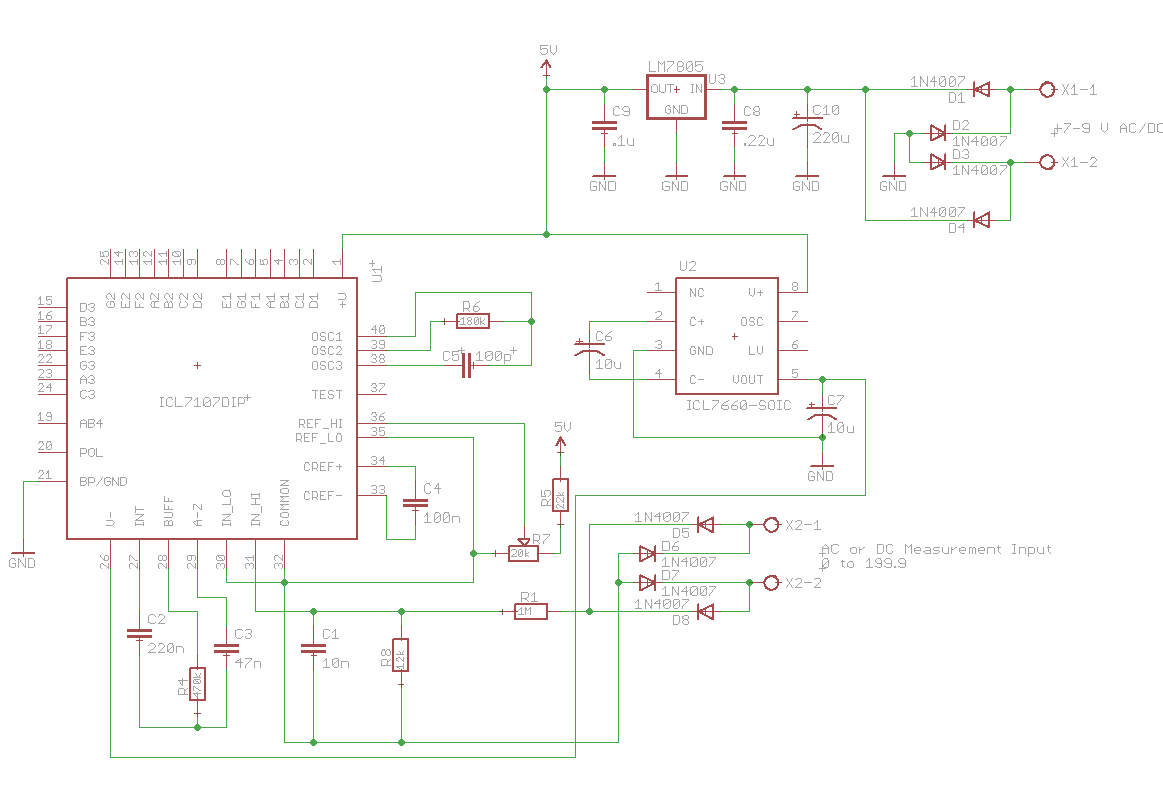

Because I don't really want to add another voltage regulator or change the configuration I have, my only option is the last one on this link (the one based on the OPA2237) as it can operate with 5 Volts.
My circuit runs from a 5 Volts regulator and I am using an ICL7660 to generate the -5V needed for ICL7107.

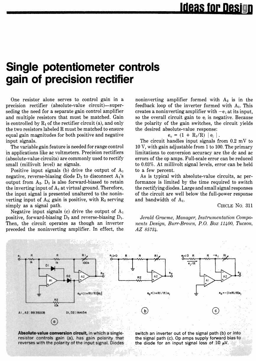

I am wondering if I will be building a precision rectifier out of this OpAmp, can I not increase the gain at the same time?
Or will I need to add a second OpAmp to increase the voltage in which case I am hoping the OPA2237 is adequate?
Mike
Below is an article on a precision rectifier with adjustable gain. You could use that to get the rectification and gain. Remember that you need a negative supply for the op amp to handle the negative part of the sine-wave.
If you want to use only a single supply, then you could use a precision rectifier such as shown in Figure 5 of this ap note. For that you would need to add another op amp with the desired non-inverting gain. You could do all that with one quad rail-rail op amp.

In the mean time I am feeding 126 VAC to the ICL7107 but I am getting a lot of fluctuation. It is not possible to fine tune but if I try to get as close to 126 VAC as possible I can observe fluctuation going from 126V to 120V in about 3 seconds and then back to 126V in another 3 seconds and so on...
I understand I should net get accurate measurements but I would like to resolve the fluctuating readings if I could.
Any clues?
