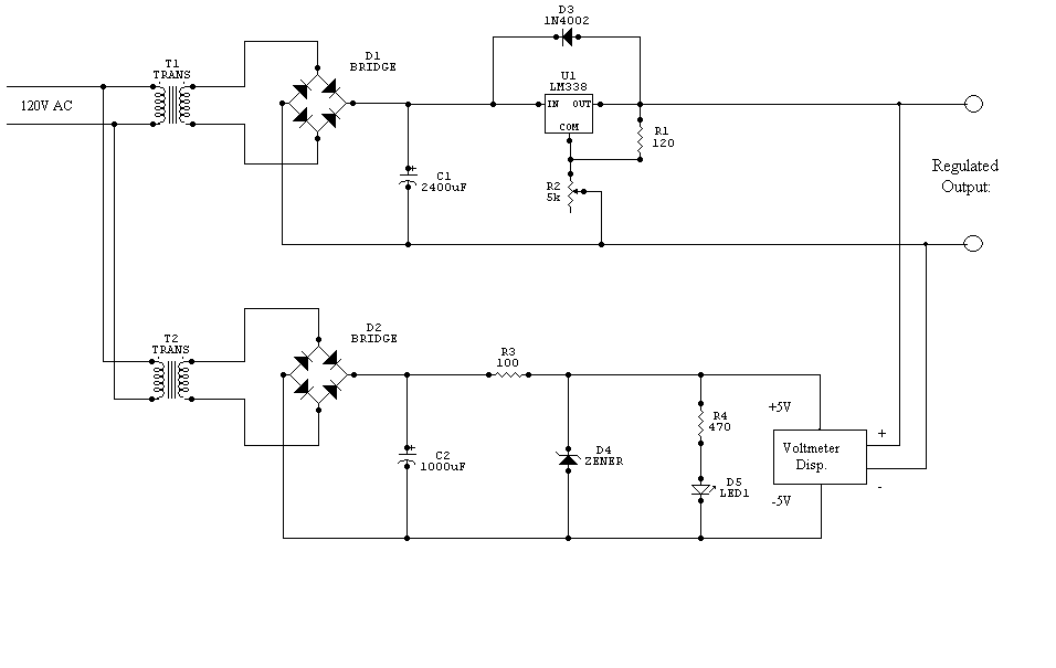

I built my own PSU awhile back, a linear design using the LM338 regulator. I think you could squeeze around 5A out of it, but even I haven't used that much current yet.
Take a look at the link below or a better description:

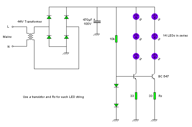

Here's how I'd do it.
Use a transistor and a sense resistor for each LED string.
The current will be about 18mA per string of LEDs.
I haven't shown all the LEDs for simplicity's sake.

That looks easy enough to do. So what are the Diode values that are immediately to the left of the LED strings? For the rectification, would most any full-wave bridge rectifier work so long as the PIV is rated high enough for the 44V coming off the transformer's secondary?
It appears to me in the schematic that the base of each transistor is connected. Is that correct? I'm not sure how I'd do that if each LED string is planned to be its own separate board with no electrical or mechanical connection to another string, aside from the connection to power and ground.
What I've envisioned, if it's even possible, is: a board 1.5 inches wide by 21 inches long, as an example (haven't settled completely on the viewing angle of the LEDs so length/width of the string module hasn't been finalized quite yet), completely self contained that would snap into some kind of power buss distribution system. I'm wanting to reduce where possible the total number of wires running through the housing box.

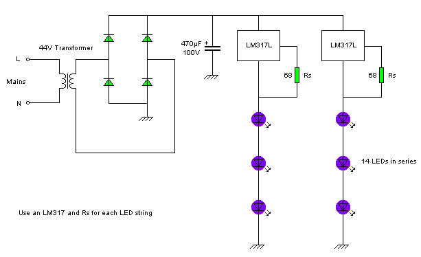

Ahh, so for best voltage regulation, the LM317L should be individually in series with each LED string? Am I reading that schematic right? That looks really easy to do. Thanks a lot for the suggestions! As a matter of curiosity, so I can make this a good education point instead of merely feeding off the work of others, what is the calculation for figuring out the Rs resistor value?
Yes, that's right.
Sorry I've just realised I didn't label the pins.
Use Ohm's law, the voltage across the sense resistor is always 1.25V.
I = V/I = 1.25/0.02 = 62.5R, the nearest E12 value is 68R.

Just one word of warning: the LM317L is only rated to 40V.
This isn't a problem as the LEDs will drop 46V so the voltage across it will be within the rating.
The voltage on the filter capacitor will be 44√2 = 62V minus the rectifier losses, plus 10% to 20% is the current drawn is below the transformer's maximum rating.
In other words don't operate the LM317L with too few LEDs in series, otherwise its maximum voltage rating will be exceeded.
