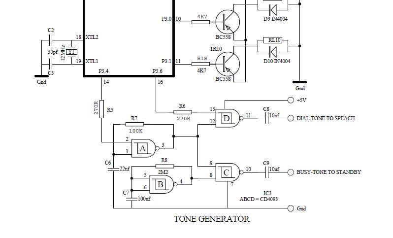

AT89C51 conversion
HI
Thanks for your replies....
By doing some research I found someone building a similar circuit using the Atmel AT89C51
Would It be possible to convert this design into use with a pic?
See attachment..
thanks
HI
See attachment..
thanks
That appears to be using external gates as oscillators, so would work with anything.
