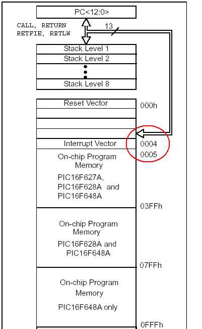

For first two tables it need 200 lines if I place table3 also in the org 0x300 origin it will not enough because its remaining only 56 lines.So I must goto origin 0x400.
Then my TABLE3 I must start from org 0x400 but this is interrupt origin.
Suraj143 said:
Thanks for your replies.I'm using 628A.
Now TABLE1 is ok.its starting from org 0x300
Interrupt origin is 0x0004, isn't it?
a-gif.13528
Oh I see.Interrupt is 0x0004.
