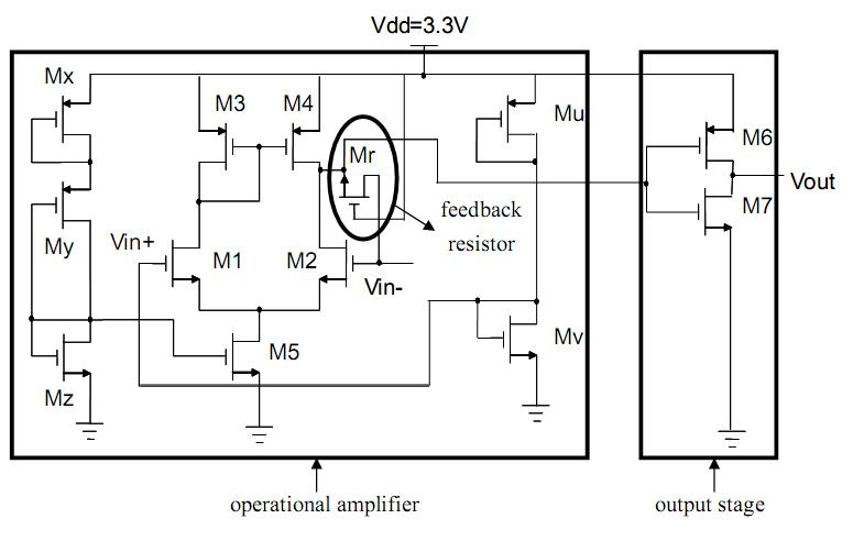

Seems to me you only need to bias the one you already have. You need to have both devices silghtly on when the input is zero. Otherwise, you'll have a huge deadban in your output.
