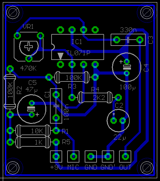

can you have a look at my eagle board layout - the Guru's mic amp
The DC output of the opamp has a max output of 1.2V to 7.8V when its supply is 9.0V. The output DC voltage is 4.5V without a signal.
If the opamp's output is capacitor coupled to an ordinary diode that feeds a filter capacitor and a load resistor to ground then the max output to the encoder is only +2.65V.
But since the encoder needs an input of 5V then a DC amplifier must be used. A TL072 dual opamp can be used and its second opamp can be a DC amplifier. Its input must not be less than about +3V so level shifting must be used.

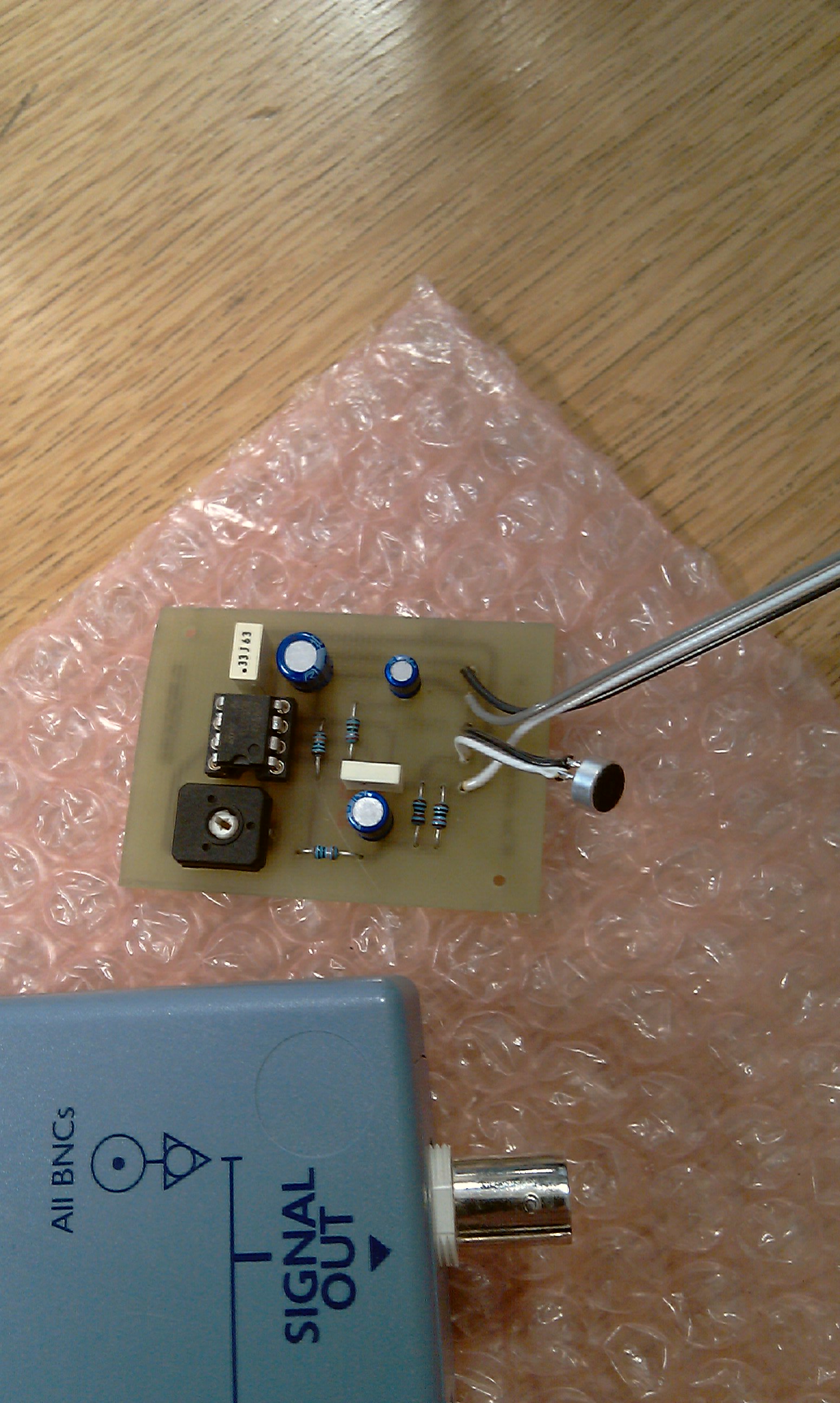

sooo, its built finally and ive just tryed to test it. ive got 9v on the board, and I put the scope on 500mv and can see some movement in the signal from the mic on pin 3 of the TL071
I appear to be getting 0v out of the opamp on pin 6 even when blowing into the mic.
any ideas what the problem could be or what to look at next?
thanks!

Pin 6 of the opamp should be at half the supply voltage with audio causing it to fluctuate above and below a couple of volts.
Did you correct the polarity of the two electrolytic capacitors that were backwards?
Do you have the opamp plugged in backwards?

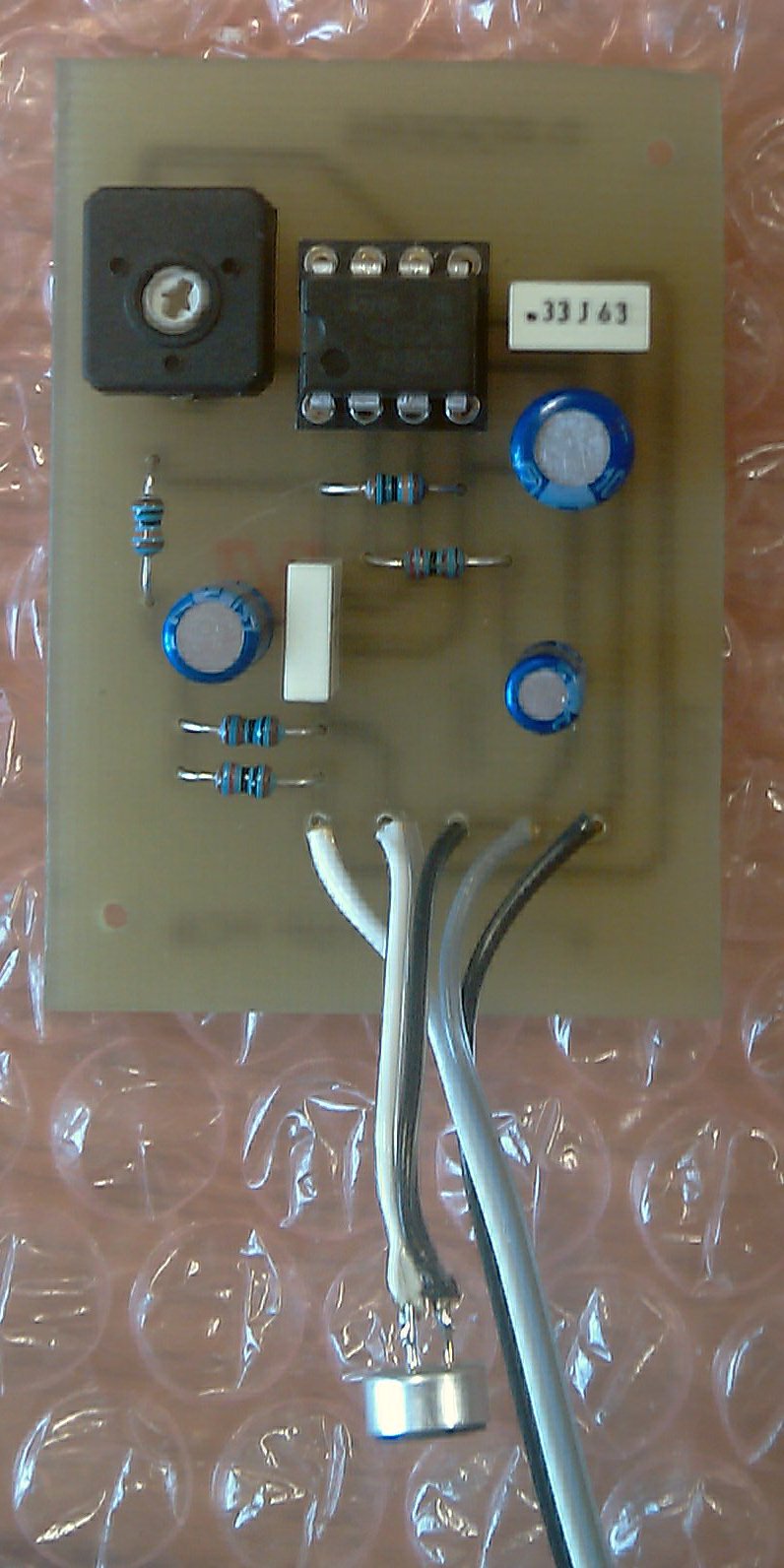

Doesnt seem to be anything coming out on pin 6 :( the
I think i built the circuit correctly, not sure if you can see from the picture? I followed Bonuk's layout design and as far as i can tell its ok.
when i connect to the output pin, after the 33uf polyester cap, im getting a capacitive voltage, ramping down from about 3v to 0v
The pcb is correct.
Maybe you connected the electret mic backwards. The ground pin also connects to its metal case.
Maybe the load at the output is less than about 2000 ohms.
Is pin 6 of the opamp about +4.5V?
The voltages might be too low if the 1k resistor is 10k by mistake.
