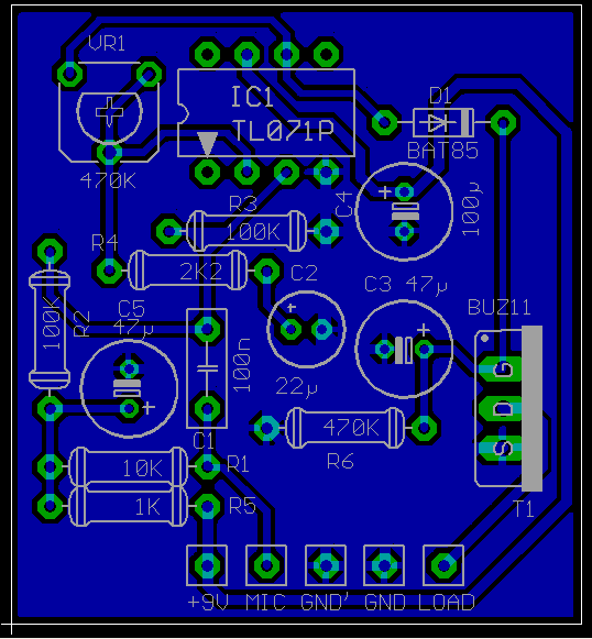

can you have a look at my eagle board layout - the Guru's mic amp

Hi Dan,

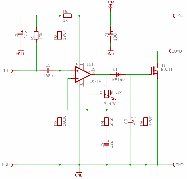

here is a modified circuit acting as sound activated switch.
The amplifier output is rectified by D1 (BAT85 Schottky diode). The output voltage charges C3 and if the voltage level is high enough the MosFet transistor (T1) conducts and switches on the load. If no more sound is present R6 slowly discharges C3 and the transistor turns off.
For C3 and R6 experiment with different values to suit your needs.
T1 is located at a position to fit a heat sink if necessary.
Boncuk

Hi guys. Its making sense now how the output stage will work :)
Bonuk, thanks for drawing that up! You are very skilled at routing, I dont seem to have that creative streak.
One thing i'm unsure of, is that I need to switch from 5v to an input on the encoder im using. From your schematic I don't think that would be possible would it?
But could I simply connect T1 between my 5v+ supply and the pin in question on the ic, and when its activated, the connection would be made?
once again thanks all, you are great :)
The Mosfet output goes to ground with a high current possible but the encoder you want to drive needs a +5V input at a low current. So the Mosfet is not needed. You need to limit the output of the rectifier to no more than +5V to feed to the input of the encoder. With a 9V supply and a schottky diode, the rectified output will be about 7.4V which is too high for the encoder. This voltage will drop as the 9V battery runs down.

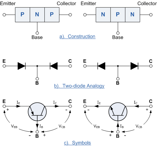

Guru, could you kindly explain what you mean when you say a transistor as a switch would invert the signal?
Is there not a way to have the input signal terminating at the transistor or making sure it doesnt go above 5v, but when high enough making the emitter and collector pins go short?
its the schematic of a PNP transistor that kind of makes me think that

an NPN transistor as a switch has its emitter connected to 0V and a resistor from its collector to the positive supply. Its base has a series current-limiting resistor.
When the base resistor has a 0V signal then the transistor is turned off and the collectore is at the positive supply by the collectore resistor.
When the base resistor has a positive signal then the transistor conducts and its output at the collector goes to almost 0V which is the input signal but inverted.
You can use an NPN transistor as an emitter-follower that does not invert the signal. But its emitter voltage is about 0.7V less than its base voltage.
EDIT:
A PNP transistor also inverts. when the base voltage is high then the output is pulled low by the collector resistor.
when the base voltage is low then the transistor turns on and makes the output high.
