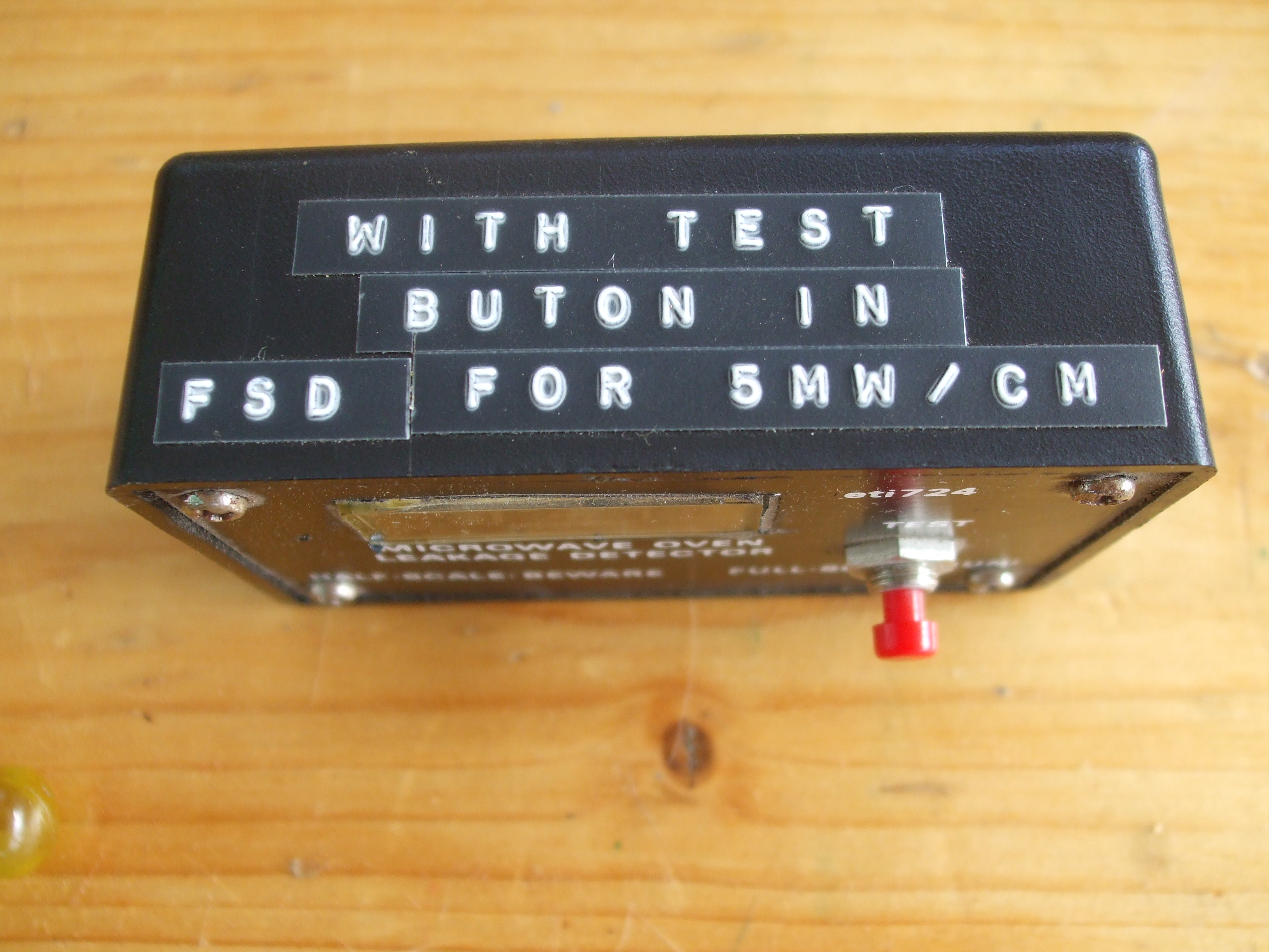

The transmitter detector circuit with 1 LED now has a diode. I tested it on my 65KHz induction heater it works. I tested both detector circuits on our kitchen microwave oven the LEDs do not light up there are no leaks. Both detectors work good with no diode in series with the LED. I'm not sure this proves anything.
A test at 65KHz proves nothing about working at 2.4GHz.
Yes all microwave ovens leak but they must be below the safety agency power density at a certain distance.
Initial designs were cautioned against users with pacemakers until they learned how to shield their designs better.
I have an e-field meter to prove it if you want data. But the LED is a good tool with a ferrite coil. The Faraday cage is pretty good too but not nearly as good as a Lingren EMI 2-stage copper gazebo cage rated > -120 dB that can block all radio signals below a threshold.
Considering that a 65 mW LED at a rated current of 20 mA when dim they only draw < 10% of this power so it is more or the same as your Wifi Router antenna. (don't stare at it in close range for along time to prevent glaucoma and cataracts. )

I would say it suggests plenty of RF radiation.
5 mW/cm FSD is about 10% brightness of a 5 mm 65 mW LED with a 1cm diam ferrite coil proving LED's can be useful if calibrated like this meter was for peak power(?) but that is 500 mW/m right? NO "near field" is not linear farther than multiple wavelengths and is inverse squared lower.

Why would you think that?, much more likely is the magnetic field from the transformer - in the same way you can walk under huge pylons with a fluorescent tube and it lights up, no RF there.
It's another classic example of supposedly 'testing' leakage, when you're doing no such thing at all.
As I've said all along, unless you're using a properly designed and calibrated leakage tester, then you're completely wasting your time - and it's EXTREMELY unlikely that a microwave oven will leak (above that legally allowed) unless there's severe physical damage to it.
Unless it's accurately calibrated, and used correctly, then it's completely useless. As I recall, our professional (calibrated yearly) tester at work had to operated 50mm away from the oven - to facilitate this, it had a cone on the end, and you ran the end of the cone along the door seams etc. ensuring the correct distance.
