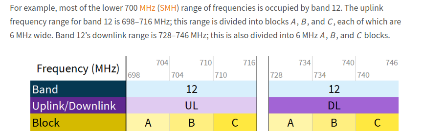

How does that demonstrate mobiles use 2.4GHz?
A quick screenshot,
As I stated above sub 1GHz.
A quick screenshot,
