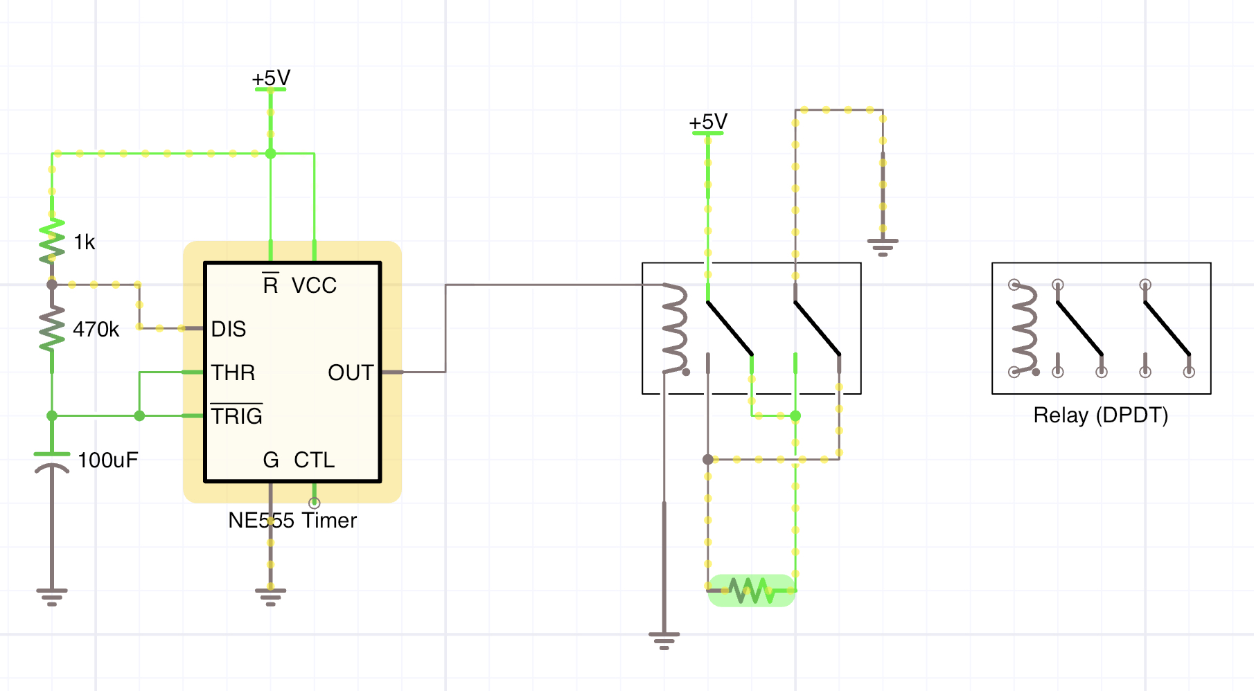

Can you provide me a polarity-reversing diagram for colloidal silver maker?

the next step is why areyou trying to use an electrochemical process rather than a simple chemical reduction?

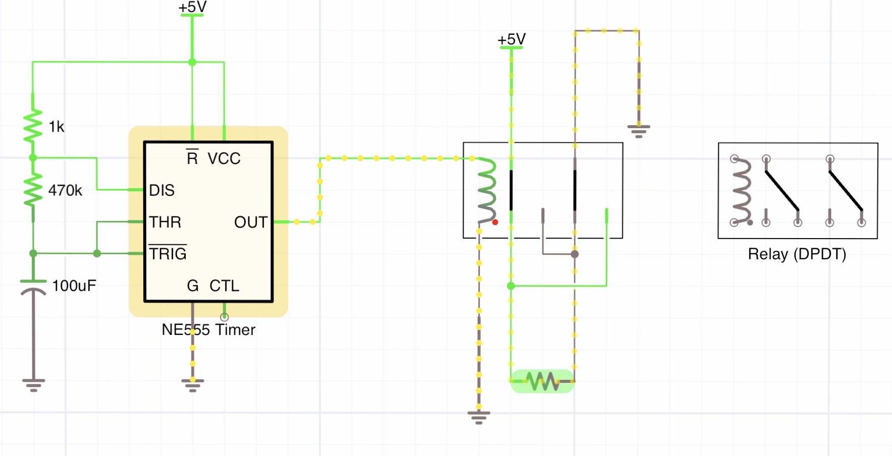

here is a circuit that will change the polarity of an electrode. Your electrode is shown as a blue-highlighted resistor.
the relay toggles between two states and that reverses the current flow.
two photos show each state.
the 555 timer turns on 30sec/off 30sec to activate the magnetic coil on the relay and toggle the switch.
Obtaining CS by a simple chemical reduction? How? I think the electrolytic method is said to produce the best (finer and more effective) pieces needed; silver ions and nano-particles.
Thank you very much for the circuit. I might be able to use it but I'm not sure if it is specific/finished enough for me because otherwise I'll probably fail to build it on a breadboard in a working way due to my current lack of knowledge. Will the circuit in its current form produce a 30-volt and 0,5 ma power output? Or did you assume I'd be able to handle that? Unfortunately I can't :( I need a ready/finished circuit with each part and each connection defined/shown specifically. Then, I thought, I might later be able to experiment only with pots and capacitors to test some adjustability.

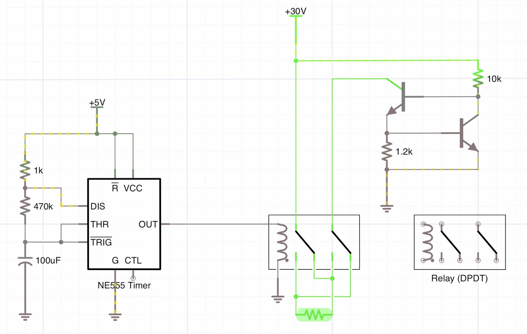

Where did you get the 30v 0.5mA spec?
A guy considered to be reputable in this subject named Peter A. Lindemann says "The very best voltage for the reaction is 30 volts because the electrodes run the cleanest at this voltage." Bob Beck, who's considered to be the inventor of CS production by electrolysis, suggested 27 volts (3x9v batteries). By the way, when I was checking Beck's data a minute ago, I noticed that a website says Beck later suggested 33 volts. I'll try to examine this later. I remember reading Beck advising very very small currents (0.1-2 ma?) for the colloidal parts to be as fine as possible.
Another guy that attracted my interest is someone called Les Banki. The documentation of one of his CS devices used approximately the values I seek now. His explanation and the picture of the device can be seen here.
In fact, I'm not so sure if there is a single optimum current. Adjustability and testing seem to be important as well. And many of the devices and people I come across around web use much higher values of current. But this is said to produce too big pieces that may be ineffective and riskier in terms of argyria etc. Smaller currents provide finer and probably more effective sizes of silver but then the electrolytic process gets longer and tiresome.
Just get a relay that can handle 30vdc. Add the two transistors to limit current.
If you have two npn transistors available, you can do this
otherwise this if you have two PNP transistors (second image).
Image 1
Image 2
If you want to control the voltage only and adjust the spacing between the electrodes is a simpler option. Closer for more current flow broader for less. Also, you can adjust the concentration of the dissolved solids in your solution to control the current flow. So many options!
Do you think this dpdt relay is ok? It says "operational voltages of 5V, 9V, 12V, 24V, 48V, 220V" and "operational currents of "1A-40A" in its explanations.
Add the two transistors to limit current. If you have two npn transistors available, you can do this. otherwise this if you have two PNP transistors (second image).
Oh, I I have some PNP and NPN transistors at hand because before coming to this website I had tried to use a polarity-switching diagram provided in another electronics website. The leads going to the motor would be for silver electrodes instead. I obtained all the pieces shown and tried to build it on a breadboard but probably because that circuit wasn't specific to my needs (or due to faulty connections on my part), it didn't work and I didn't (and don't) know how to modify it to my needs. I emailed the guy for help about it but didn't receive an answer. So, I have the transistors shown in that diagram including: 2n3904, 2n2222 and 2n2907. But if they aren't the ones, I can also obtain other transistors that I need for this purpose.
So, the two unspecified transistors in each of your latest diagrams will either be two PNP or two NPN transistors.
Does this circuit use 5v input and will transform it to 30v?
And, I don't know how I'm to connect those ground-symbol leads. Do all of them need to be connected to the negative supply of power?
If you have a 30v power supply, use that to power the transistir + relay portion. Positive goes to where I have 30v and negative of the power supply goes to the ground symbol of that side of the relay.
then use a USB power supply to power the 555 timer side of the circuit. The 555 is one of the most common integrated circuits of al time so it is not impossible. There are thousands of "how to" videos online for the 555.
this 555 time side of the circuit is very flexible. You can power it with what ever voltage the coil of your relay needs up to 15 volts. So, many modern relays are 12 or 5 volts. Just make sure the coil doesn't draw more than 200 mA.
Thank you very much for your help, gophert. I'll do my best to build it based on your instructions.
