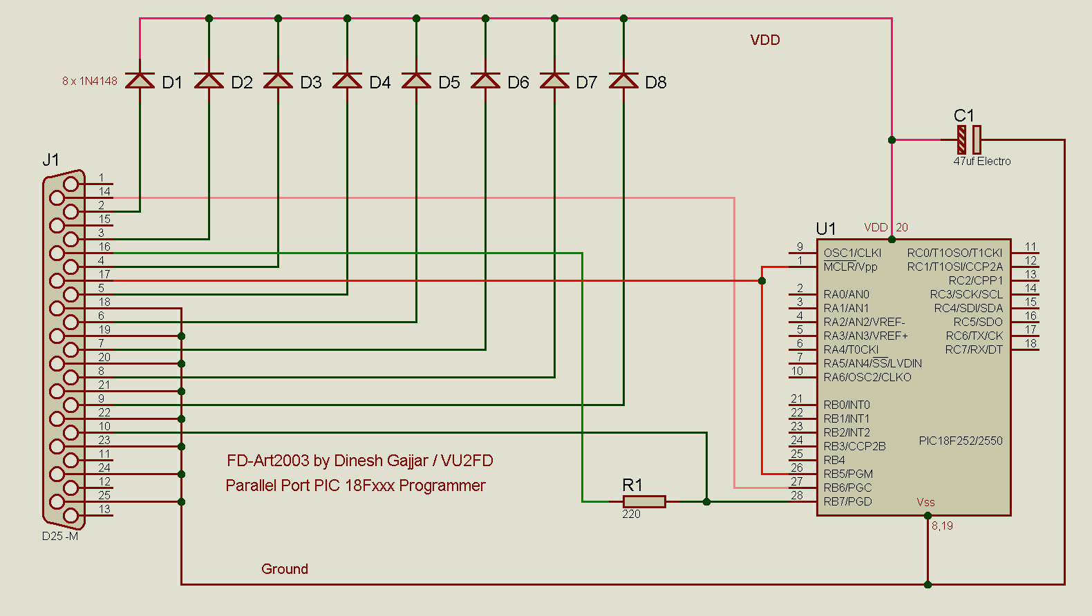

Attached please find the ART 2003 programmer schematic in ZIF. It is a parallel port programmer. The designer specifically says that he made this to program 18F2550 for use in PICKIT2 and another 18F2xx chip. I only wonder, if this can program 18F25xx, perhaps PICKIT2 becomes redundant.

Hardly, it's a really poor LVP programmer, dependent on a custom program running on the PC - the PICKit2 is in a completely different league, and is a debugger as well.
the designer says he used winpic600 in conjunction with ART2003.
I experimented a lot with ART2003.
ANY PIC WITH LVP CONFIG can be programmed with it.
I tried 16F628A,18F2550,18F876A
But sometime programming fails strangly....maybe due to my poor veroboard layout.....
