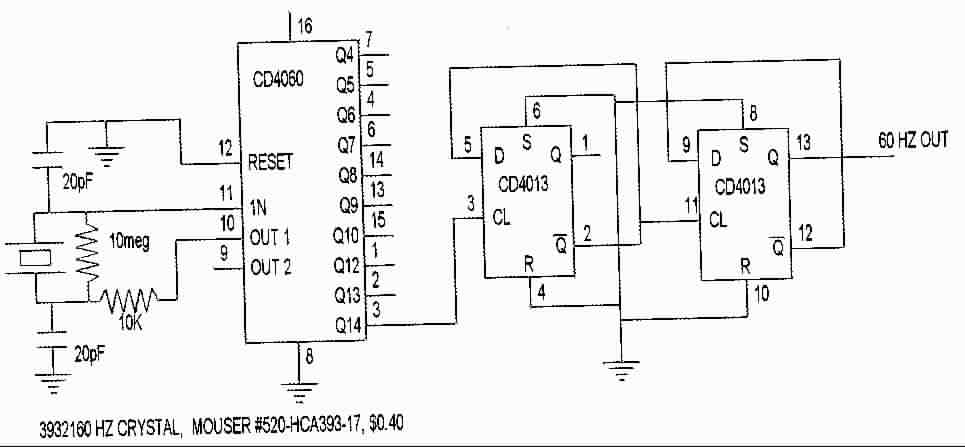

I'm about building a digital clock, and I have read that I need a 60Hz Oscilator, but I cant seem to find oscilators that low! Every oscilator is rated in MHz not Hz. I only find 60MHz , do the producer mean that 60Hz and 60MHz are the same? Can I use a 60MHz oscilator instead?

Or use a MM5369 IC as the 60 Hz source, these are very accurate and use a commonly available 3.58 Mhz TV colorburst crystal.
For a stable 60 hz use this circuit:

if you live in the states, you can get the 60Hz from the outlet. edison doesnt guarantee 120V, but they do guarantee 60Hz. with a bit of circuitry, you can get a 60Hz squarewave. if you live in an area that supplies 50Hz, then perhaps a 555 timer with a trim pot would work for you. some companies used to have 60hz time-base generator ic's. may have discontinued them. perhaps you can find a place that specializes in hard to find ic's.
nope, I live in Norway, here we have 230v 50~60Hz , not accurate. But thanks A LOT for all the help i have recived, I have learnt incredibly much from it.
