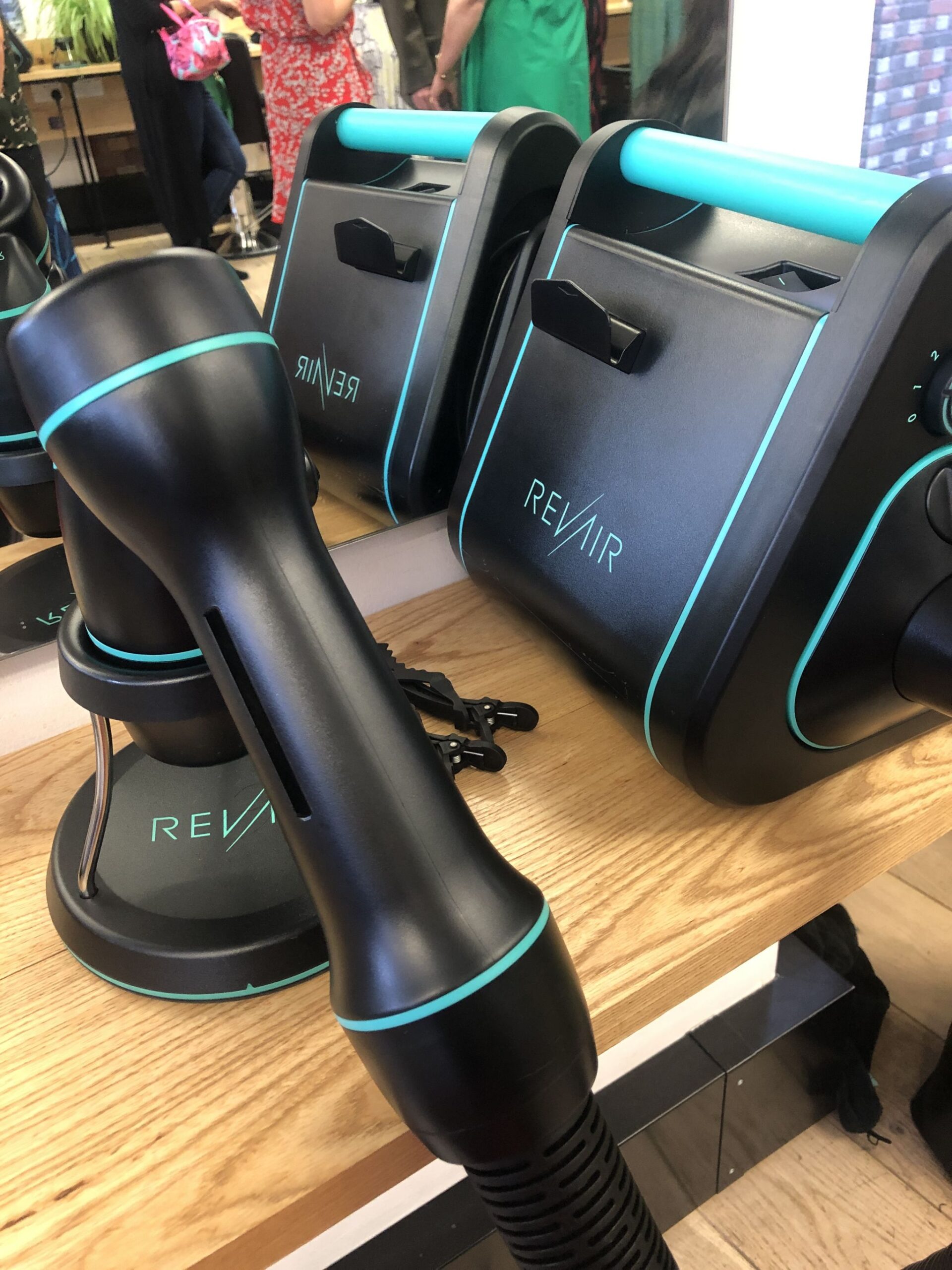

Hi friends, hope this is the right session where to post this thread..
first of all hank you so much for the opportunity to write here:)i'm looking for a solution to make it work in Italy an USA air dryer.The air dryer is compatible with 120V/60hz 15amp, in Italy we use 230V 50HZ. I am looking to design my own frequency converter / circuit even rewinding he motor, Another option is to make it work with an inverter which should still provide the correct voltage & 60Hz frequency sinewave output.
as you can imagine i am looking any way possible to make this air dryer work in italy, i really need his particular model to work in Italy and implement it in my wife air saloon.:D:cool:
Thank you really in advance everybody that give me any support and even willing to work with me on his project
Best regards Andrea
The mention of a Salon makes this a HAIR Drier.
The frequency difference should not be a problem.
All you actually need is an appropriate transformer to reduce the supply voltage, to the appropriate level.
Induction motors will naturally run slightly slower on 50Hz than 60Hz, but that is not generally a problem and many types are marked with ratings for both frequencies.
If it's a "Universal" motor (brushed with series field) then they are not frequency dependant - 50/60Hz does not matter, just the correct voltage to set the speed.
Some hair dryers use DC motors, where the DC is full-wave rectified from a section of the heating element. They certainly won't mind a different frequency of mains.
Some hair dryers reduce the power for the low settings by adding a diode in series with the heating elements on low power.
I cannot see any need to keep the waveform as a sinewave for a hair dryer, which is a difficult thing to do.
The entire scheme is flawed - all that's needed is a simple (and fairly cheap) auto-transformer to correct the voltage, the frequency will either make no difference at all, or very little difference.

Sorry everybody for replying late, i really was watching email entering my phone of you all people replying me, i was full of appreciation but still couldn't make to rush on the computer. i was over busy the past 24 hours had to fix some expiring documents
i went online to check for the best communities to help me solve his problem , and i didn know most of you join both of them i really appreciate you all !!
please don't be angry with me
if i can briefly give some info about the hair dryer which i miss in my main post and i apologize for that
so here is The link of the product https://myrevair.com/products/revair
as you can see in the Tab spec of the product it is clearly mentioned :
“RevAir is compatible with 120V/60hz 15amp outlets only. The device will not operate with the use of a power converter, adaptor, or transformer”
now i have read online that people have imported this product and tried with a step down voltage inverter but it was no sufficient as they have melt the hairdryer.
so i really don't know how to get a solution for his i googled for a hz converter and they are industrial type super expensive (i even found product like this https://www.polskieprzetwornice.pl/...500w/?osCsid=bbdc511bb2e293282eab07181f9b9cee but the limit is 500w), anybody that is willing to help me i'm willing to pay because i'm serious about his project
sincerely Andrea
Worse yet – cross-posts to a number of different forums, and ignores all replies.
The cost for each unit to power one drier would be far more than the cost of the driers.
For absolutely perfect power, the only practical solution I can see would be a motor-generator set with high enough ratings to power whatever number of driers were needed.
It could be with the weird design of those revair units that the slight reduction in airflow from running them on 50Hz rather than 60Hz is enough for them to overheat and have problems.
A quick search shows that they did have some form of "UK Release event" (in 2019?) - so units designed for 230V 50Hz - but no sign that they were ever actually sold, from what I I've found so far.
As the makers site says that use outside of the USA voids the 30 Day warranty (!!!)* it could well be that the machines were either not sufficiently reliable, or not compliant with EU safety requirements, so makers were unable to get the CE marking qualification for safety etc. to allow them to be sold?
It's obviously untrue that the hair dryer won't operate with a transformer, because all premises that are supplied by the electricity grid have the power come through a transformer.
However, the hair dryer is rated at 60 Hz, 13.5A and 120 V so that is quite a lot of power to transform and there's no such thing as a travel adaptor that will transform the power correctly.
A site transformer will be fine, but the output will be 50 Hz. The one linked to is around 18 kg so RevAir will be assuming that no-one will be using one of those.
The hair dryer contains heaters and electronics to run the motors. The heaters will work just the same on 50 Hz as on 60 Hz, and I think that it is highly unlikely that the electronics will be affected by the frequency.
You could buy a 2 kW petrol generator made to American specifications.
If you're prepared to open one of the RevAir units up, and show us what is inside, we could better advise what you need to do. It might be possible to feed the heaters from one power supply and the electronics / motor from another one. The electronics / motor might not like 50 Hz, but would be small enough to run from a good quality frequency inverter. The heater will be able to run from a transformer at 50 Hz.
