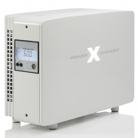

The manufacturers have no interest in suggesting a voltage converter as there doesn't seem to be anything that can supply that much power that is vaguely portable, and even if there is, there's no easy way for a non-technical potential customer to recognise which ones are suitable.
It's not the sort of appliance that customers will want to take on vacation, so very few people will want to use them outside of the country that they are sold in, so there is almost no commercial advantage in advising customers how to run them from 240 V, and it would leave them open to claims if they did say it could be done.

The price, size and weight of those shows that converting from 50 Hz to 60 Hz is not practical for a hairdryer. Revair be worried about their image if they suggested a $1500+ converter for a $400 hairdryer, even if it would work.
as it would be a simple 'fix'.
