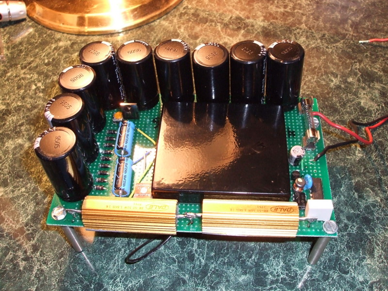

we are only restricted to DC voltages...i'm already using two car batteries connected in series giving me 24 a VDC input..and adding more batteries is not the most practical way in doing it...that's why the title of this thread is capacitive discharge because we need a circuit that does this and charge at no waiting time...24 VDC to 110VDC output...
Like I said above, you need an inverter to convert the DC to AC, a transformer to up the voltage, then a rectifier to convert back to high voltage DC to charge the capacitor. You need to build a powerful enough inverter to charge the capacitor quickly.

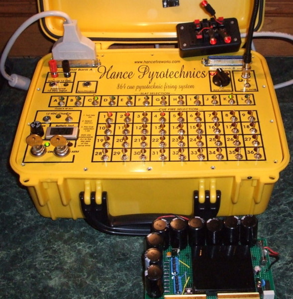

I am trying to build a power supply to power my 864 cue firing system to allow me to fire multiple front locations.
To do this I needed a higher voltage sytem to carry the low amps current through the 1000' of 22ga wire to ingnite several ematch in parellel.
Ematch require 75ma to ingite, but using a high voltage low current (150ma) system you can do this with several ematch in parallel and an even greater amount in series. As seen on my web site.
http://www.hancefireworks.com/864panelpower
Ematch is constructed of a bridge wire or nichrome wire that heats up to ingnite the pyrogen head (match head) usually without breaking the bridge wire until explosion of the shell, Allowing for several milliseconds to ignite more in parallel or series.
This picture is a power supply I have built that will do this, it is a step up converter that converts 24vdc to 200vdc at 150ma, voltage can be dialed in using the 10k pot from 0-210vdc. Each capacitor will fire banks 1-9 on the firing switch's for a 0 wait time for the capacitors to charge.

This is the 864 system I am building.

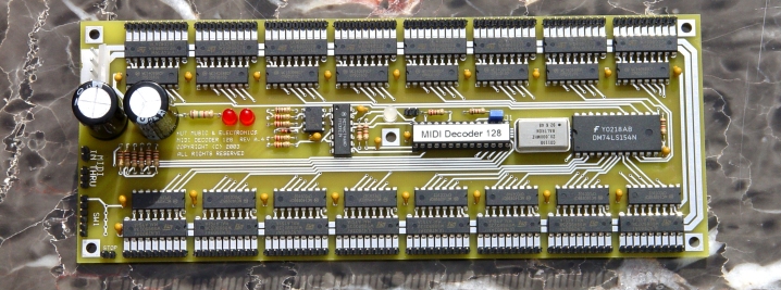

I am seeing others using mididecoders to build firing systems such as this board. It is a 128 midi board which will connect to a computer to allow for computer controlled fire.
This is not my area but it seems to be a way of communicating with a relay based slat system.
This would make a great 128 cue firing system.
Midi is just a form of serial interface, specifically designed for use with musical keyboards - although much other midi equipment has since appeared. The chip that has 'Midi-decoder' stuck on the top is probably a PIC, or other micro-controller. Because it was designed with music in mind, it specifies an opto-coupled input, in order to prevent earth loops and hum.
I can see it would apply well to your application, because it already does much of what you want - allowing you to have just a couple of wires from your firing position, and individual control over many channels.

Any thought as to expanding this, 128 seems to be the largest boards I have seen available.
Or any other suggestions as to using micro-controllers to do computer firing?:)
128 may well be the largest number Midi is designed for?. But as you're not planning using it to play music (presumably?) you could extend the format easily enough.

What ways are available to expand these boards or will new boards have to be designed and built? Or can one board be built to controll several of these 128 boards?
I would like to build a system that is computer controlled but with a larger number of cues than 128. I beleive I could build one with this board and low voltage relays.
