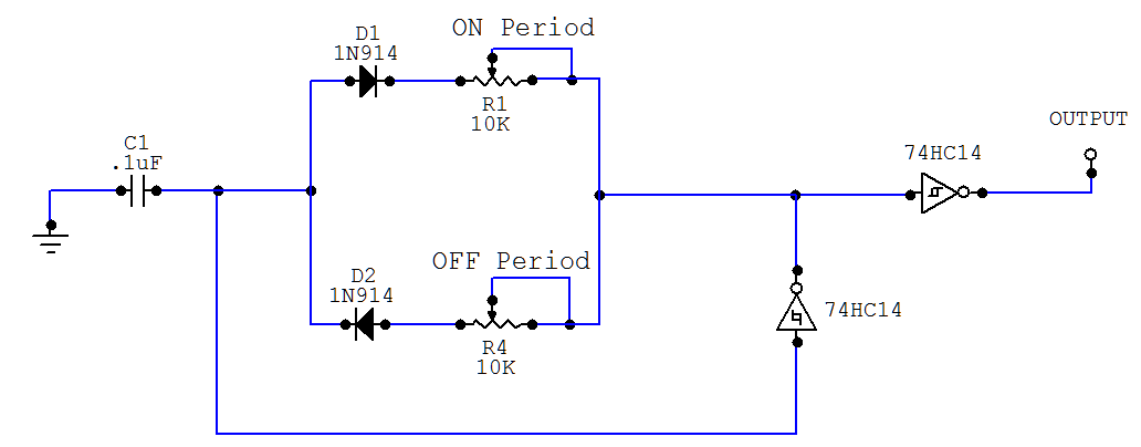

An alternative route is get rid of the series pot at pin 1 altogether, put a 10K pot in series with each of the two diodes, and replace the existing 10K pot with a short circuit. The duty cycle adjustment will not be independent of the frequency adjustment, but the ON time of the pulses is adjusted with one of the pots, while the OFF time is adjusted with the other pot. So, at least, the ON time and the OFF time are independently settable, allowing you to adjust the frequency and duty cycle.
I'm not getting it. I mean Im not understanding it... can you please draw me the circuit what have you written..
Like this:

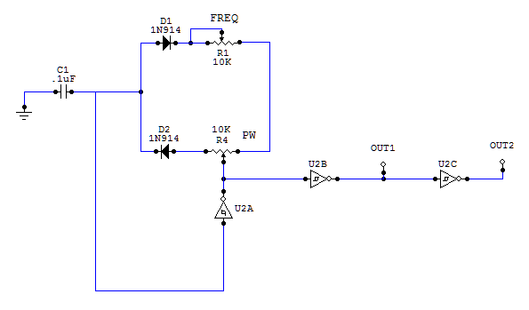

You can connect the pots as shown in this attached. The Freq and PW are independently settable. The issue with this configuation is that the duty cycle is adjustable from only 0 to 50% when the Freq is adjusted to the lowest value (0 to 100% when the Freq is adjusted to the highest value). The thing to do then is to add an inverter, as shown, and use the OUT2 to get the 50-100% side of the duty cycle.
I have just doing your circuit in my bread board and I'm getting this..
I set the fre 45KHz at 80 % duty. then I try to get 50% duty cycle at the same frequency(45KHz). if Im adjusting the 10KΩ pot for 50 duty cycle automatically the frequency comes to 50Khz...
and the frequency is not getting smaller than 28 or 27 Khz at all the duty cycle I have tried...
If you modify my post #16 circuit to use the 74HC14 it should work with R1=270k (or perhaps 330k) and R4 = 680k.
I set the fre 45KHz at 80 % duty. then I try to get 50% duty cycle at the same frequency(45KHz). if Im adjusting the 10KΩ pot for 50 duty cycle automatically the frequency comes to 50Khz......
Not perfect independence, admittedly, but not bad for a simple circuit. Different pot settings load the inverter differently and the inverter has limited drive capability. Even in the very first circuit you posted, the frequency would be expected to change slightly while varying the duty cycle.
Naturally, there are limits on the adjustment due to pot values and capacitor value.
BTW: I don't understand how you getting such a high frequency output with a 0.1uF cap and those pot values. It should be a factor of 10 less than that. Are the component values changed?
