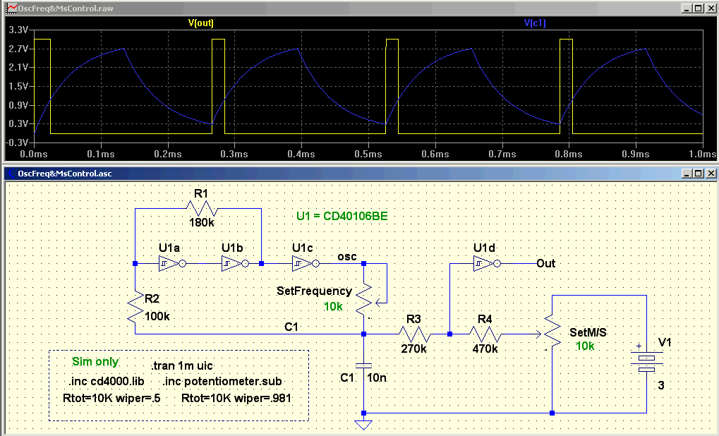

You can get independent frequency and mark-space control with a four-gate circuit. Mark-space ratio is adjustable ~ 8% to 92%. If I can attach the schematic successfully it's here:
Edit: I used a CD40106 because of its symmetrical Schmitt threshold values. You could use a 74HC14 instead, but you might have to tinker with R1 and R4 values to allow for threshold asymmetry.
I just done it on the bread board but the frequency always fluctuate a lot.....
and i do it with 74HC14...
1) How much is "a lot" ?
2) Does your circuit have supply decoupling capacitors?
3) If your 3V supply is a battery is it a fresh battery and not overloaded by other circuits?
4) What values are you using for R1 and R4?
