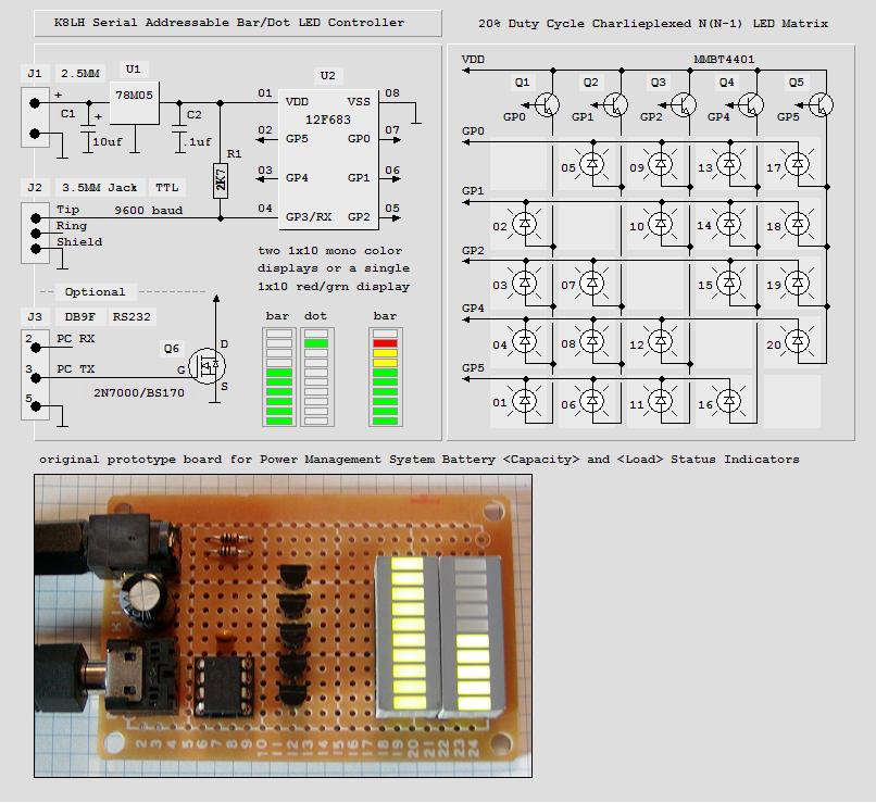

The hardware for a microcontroller solution is really pretty simple but the you need to be able to program the microcontroller (ouch).
Here's an example of an 8 pin microcontroller driving either 20 multiplexed mono color LEDs or 10 multiplexed Red/Green LEDs.
