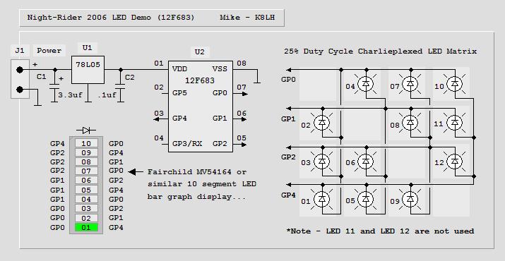

I used the search feature on the forum but did not find what I was looking for and was hoping someone here could help. I was looking for a print I wanted 6 led of differect color to chase one way then start over. Was looking for the simpliest circuit.

Here is a simple circuit to make the 6 LEDs chase back and forth:

Perfect just what I was looking for thank you audioguru. Couple of questions on it. Can you use different color leds with the right resistors, part list for diodes would be great and what is the operating voltage.
You can use any color LEDs. The CD4017 limits the current itself so resistors are not needed if the supply voltage is between 6V and 9V.
Any little diodes are fine. 1N914 or 1N4148 are good.
