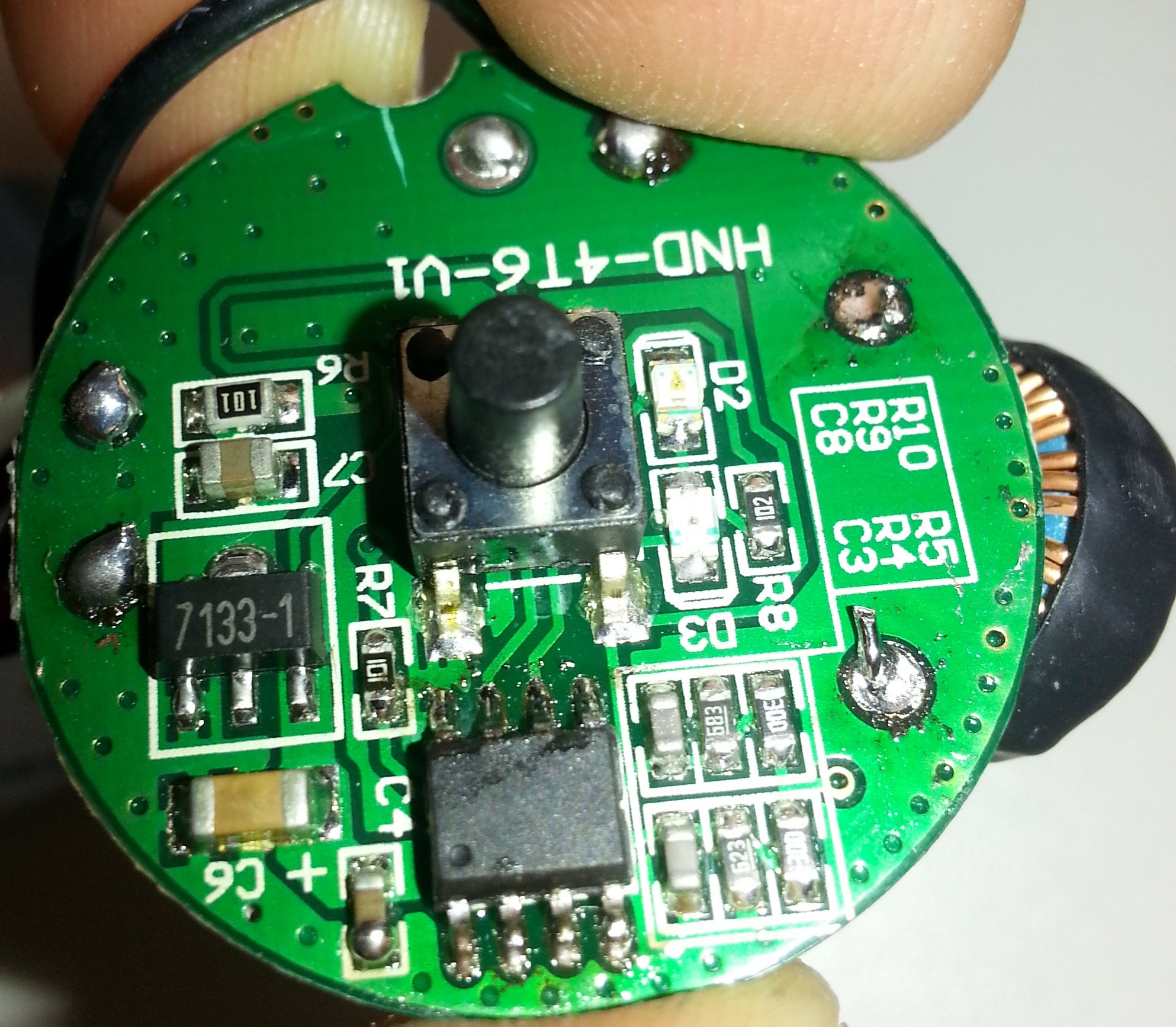

Underside

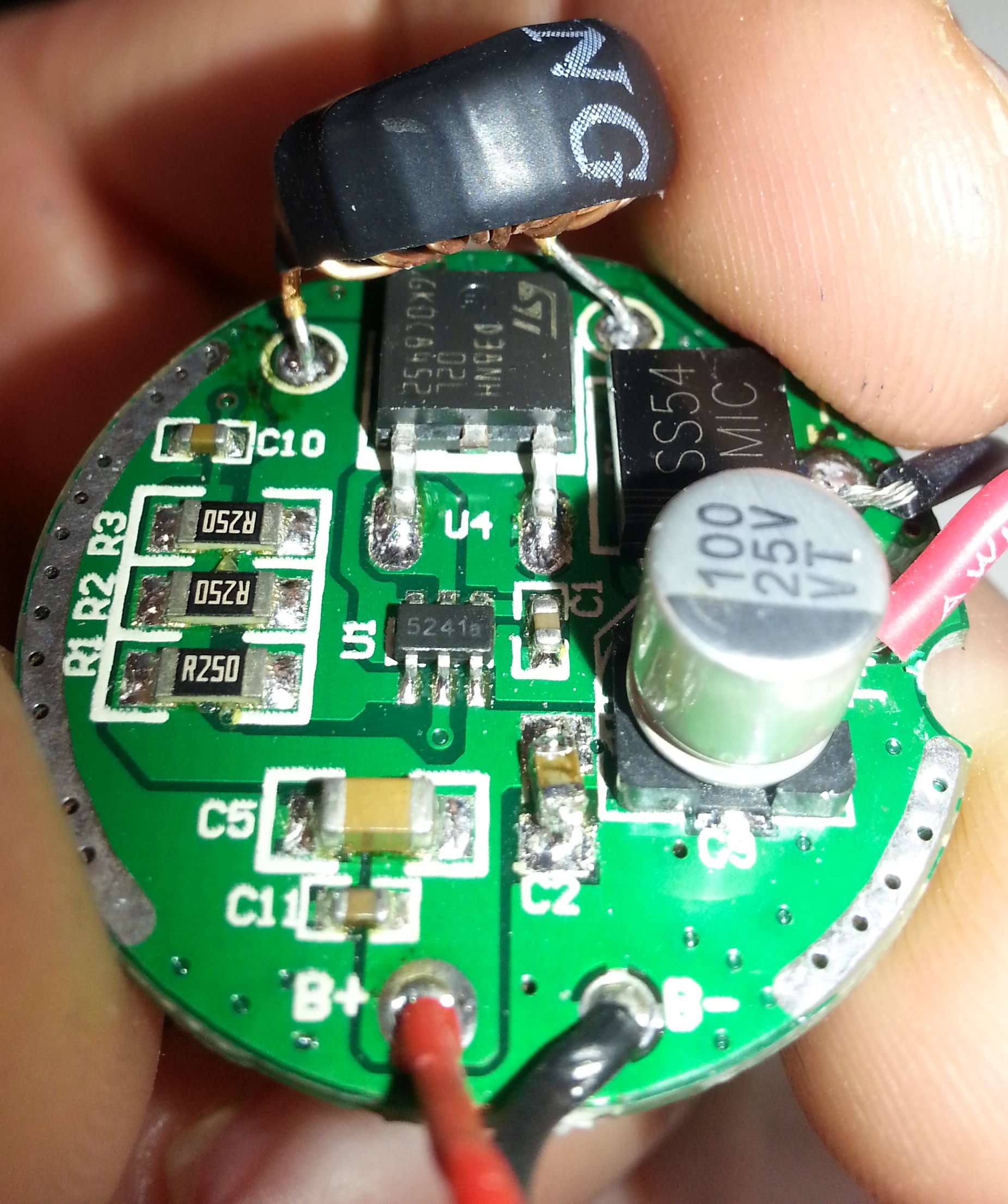

Topside
![20150105_150648.jpg 20150105_150648.jpg](https://www.electro-tech-online.com/data/attachments/79/79097-e369b03614d9f48555459aa62e45afff.jpg)
The topside contains the LED drive circuitry while the underside is the mode select and undervolts logic

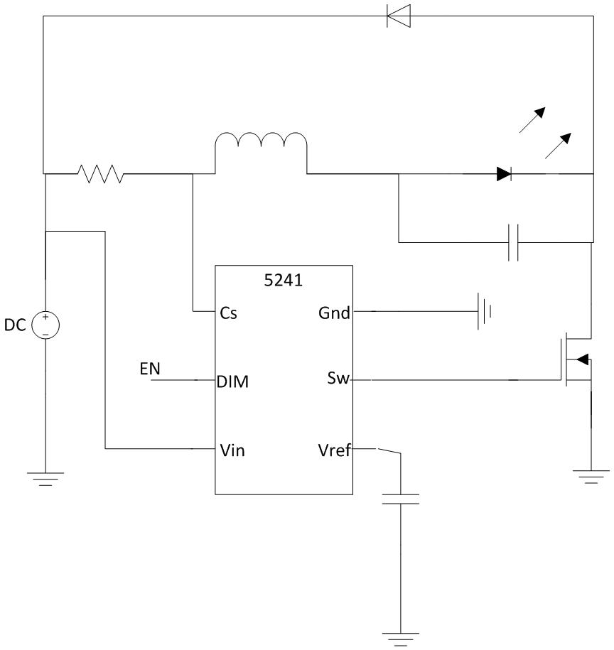

The datasheet for the 5241 driver tells us that it is a buck type constant current driver and gives the following type of circuit configuration
![Untitled picture1.jpg Untitled picture1.jpg](https://www.electro-tech-online.com/data/attachments/79/79099-f93e39a5b606fea80e1425a242d04573.jpg)
But this circuit topology doesn't stack up with test results.
For example I removed the main LED and the circuit still pulled a large current when switched to mode1 (LED on), based on the circuit above that shouldn't / couldn't happen.

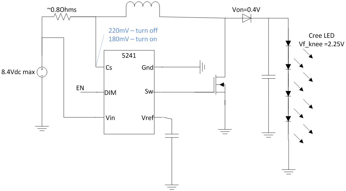

Further investigation and probing of the PCB revealed the actual circuit topology used, a boost circuit as shown below.
![Untitled picture2.jpg Untitled picture2.jpg](https://www.electro-tech-online.com/data/attachments/79/79100-118c4e989763670520daebc94f069f3b.jpg)
With a boost circuit such as this you can never turn off the LED while power is available, so that raised the question of what was happening in mode0 (LED off).
It turns out that the battery voltage is 8.4Vmax and the minimum Vf of the LED string is 9.3V at the point they visibly emit light. So in mode0 this circuit is just using the Vf of the LEDs to turn off the circuit while in mode1 the voltage is boosted. This isn't what the driver is designed to do but I guess it works.
This also explains why the circuit was drawing high current even with the LED disconnected, as the current feedback in the driver was adjusting the fet duty cycle to compensate.
I also discovered the undervoltage shutdown for the IC is set at 7V, so I've only got 1.4V of battery discharge! Not sure what's safe for a 8.4V Lithium-ion battery but 1.4V seems small to me.
