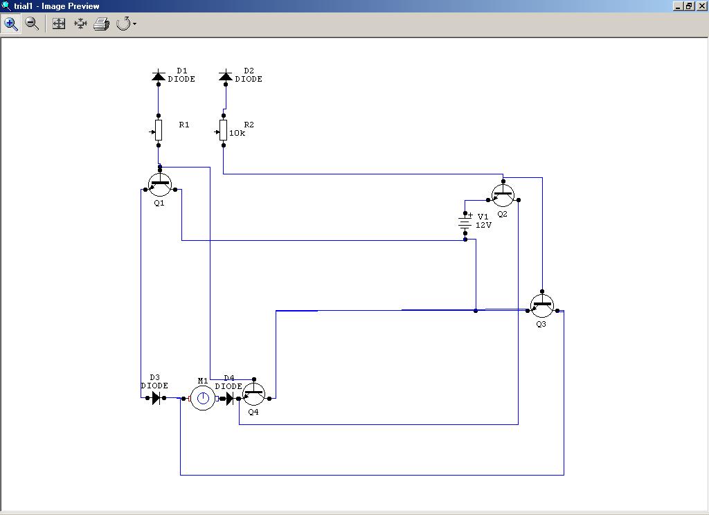

will this circuit work if so can you give me component values**broken link removed**[/url]

it is ment to use the motor output of a remote control car and use a far more powerfull motor. the input points are d1+d2.

As Nigel said, your circuit is very confusing. The components are so spread out that you need to pan back and forth, up and down to cover the whole thing. Because it is not all in view at once it is difficult to make sense of it. If you closed them up a bit it would help. I cannot get a printout of the complete thing.
Also, there is a convention in circuit layouts that wherever possible the most +ve rail should be at the top and the most -ve one at the bottom. It is then possible to see the voltage potential gradient in the circuit.
Signal inputs should be shown at the left and outputs at the right. Then it's possible to see fairly quickly what the circuit is all about.
With your circuit it is not possible to see what is supposed to be going on without redrawing it.
would it be easier to forget my terrible diagram :?:
it want a simple circuit taht means i can use a 12V drill motor as the drive for an existing remote control car unit.
Sounds like you need an h-bridge. i'll let someone more knowledgable tell you more about exactly what you're looking for. In the meantime, google search "h-bridge"
