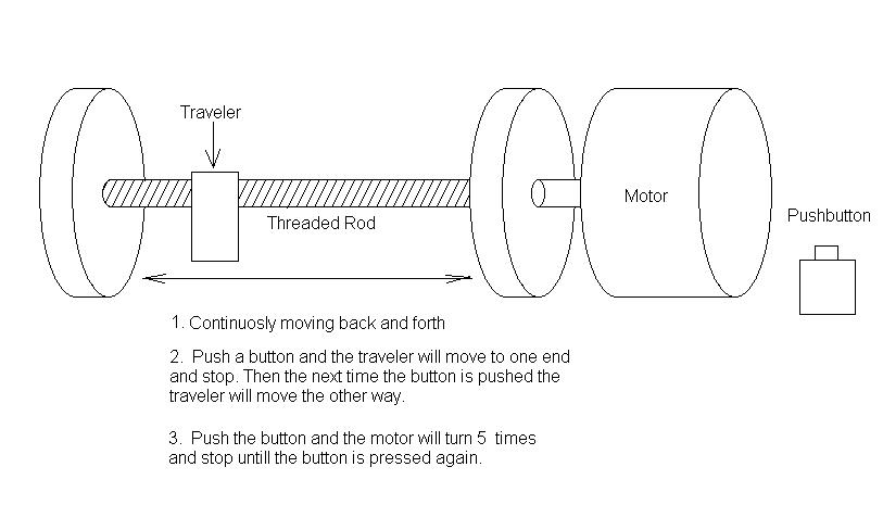

I need a little help with a circuit to run a motor attached to a threaded rod in 3 diffedrent ways. This is kind of hard to explain so I attached a simple drawing that I hope will help. Any questions let me know. Thanks for the assistance.

what kind of motor are you using? (Stepper, servo, regular DC ect.)
you'll probably need a microcontroller to do all of that, and you will possibly need some sort of switches to indicate where the traveler is located.
You may be able to avoid the switches by just using a stepper motor. You could just count the number of steps needed.
Sounds like a pretty difficult task.
I would love to use a stepper or servo motor but I'm not very familiar with them and the circuits that run them. What I have available to me right now is a regular DC motor that will run on 3 - 9 volts.
These are 3 different applications I'm workiing on. I was thinking that for the first 2 that micro switches might be able to be put on either the traveler or the ends (stops) on the thresed rod. I'm just not sure how the wiring would be. The third application I'm not sure how it could be hooked up. Just looking for something as simple as possible.

Yes, the first just needs end stop switches, and suitable wiring, to do it with a single button will require some logic circuitry - but to do it with a simple toggle switch is only wiring.
The third is FAR more complicated, you need to generate a signal from the motor representing the number of turns it makes, there are various ways of doing this, a slotted disk and opto-sensors is a common way. The rest of it would be greatly simplified with a micro-controller. As already suggested, a stepper motor would make it easier, as it moves a specific amount each step - again, a micro-controller would make it simple.

It would help a lot if you tell us what end use you have for this device.
For example, it reminds me of the electric ram I recently had to fix. the "traveller" was the ram rod and the screw within pushed it in or out of the housing. It had a novel way to determine when it reached the end of travel and stop. The screw was attached to the motor with a coupling that was slightly (spring) flexible, axially. As the "traveller" nut reached the end it would push the shaft one way or the other and this activated a micro switch, which in turn stopped further motor rotation in that direction but allowed rotation in the opposite direction. The neat part was that both micro switches were located at the motor end of the screw, essential for the ram application.
If you have reasonable axial loads (push/ pull) on your "traveller" then you should fit compression bearings to the motor/ screw coupling, most motors cope poorly with axial shaft loading if they are not designed for that.

This is nothing special or heavy duty. #1 is for a Christmas display that I would like to have a figure move back and forth continuously. #2 is pretty much the same except a button would have to be pushed for it to move in the other direction. In #3 the motor is actually attached to a small auger and I want it to turn only a certain number of times and then stop until a button is pressed again. In each of these the unit would only be about a foot by 4” by 4”.
Mike
One way to deal with the "5 turns then stop" might be to use a 5 to 1 gear reduction or timing belt drive. You'd be stuck with a fixed ratio but it's a way. I'd consider some kind of turns indicator on the shaft.
While there is a way to hard wire something like this with limit switches and relays (some of them latching, maybe) it's probably easier to do electronically - either with a PIC or similar microcontroller or ICs including flip-flops or similar devices that can "remember" and count. Reversing the motor is easy - a DPDT relay will do that - the rest is the challenge. You could mechanically toggle a DPDT switch but that is likely to be prone to failure.

This project of yours looks like a perfect time to get into pic's :D . For the end stops a micro switch at each end is all you need, this can trigger the pic to stop the motor and set it up for reverse. For travelling the five revoultions a magnet placed on the O.D. of one of the disc's and a hall effect sensor can be hooked up to a pic pin, then when 5 rev's have passed the pic can stop the motor and even return it to the home position. For powering the motor a simple H bridge would do the trick. All this can be done on a 16f628 and with a bit of thought it won't be hard to do.

Hey, I just got to thinking (what a concept!!!!) How do they get the door to open and close on a CD Rom drive? Isn't that kinda like the number 2 project I'm trying to do. How would that be wired up?

Mike, On the CD drives the door is opened mechanically (and shut) by the CD carrier, as it moves. The CD carrier is driven by a spindle which in turn is driven by a stepper motor.
Stepper motors are neat as you can drive them precisely, even doing part turns, but the motor by itself is useless. It needs a dedicated driver board which in turn needs a dedicated power supply. By that stage it gets complicated, some driver boards have on board programming for simple functions, some need a computer to supply the stepping sequences.
For your project an ordinary DC motor is quite sufficient. You control the (push button) FWD/REV action with a H-bridge (look it up) and you can control the 5 turn spec with micro switches as 5 turns would represent your 'traveller' having moved a certain distance. You could wire the micro switches to also control the H-bridge so the motor would move back and forth between the set limits until you stop it. If you want the back and forth bit occuring automatically a set number of times you need another micro switch (or optical switch) connected to a counter which resets the cycle after the set number had been done.

All the CD-ROM drives, and CD Players, I've seen (which is a considerable number!) DON'T use a stepper motor, they use a simple DC motor fed from an H-Bridge (to reverse it), and a simple limit switch at either end. The latching and reversing action is controlled by a micro-controller.
