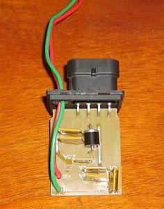

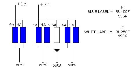

My boss understand nothing of electronics but he insists that he wants a protection circuit (named TER0608) for the circuit already mentioned here (car tracker). I have to tell him how the circuit works, but I dont even know some components in the circuit. Somebody can tell me what components are in the circuit?

Some fuses look like that.

I think the label should be enough....
Anyway, here is the photo. It is not that good.
The balck cylinder with a stripe round one of the ends is a diode.
The yellowish square things could be either capacitors of polyfuses but the look like poly fuses to me. You can test this using a multimeter, if they're capacitors they'll read open circuit, if they're polyfuses they'll read short circuit, Polyfuses provide overcurrent protection, they are an example of a positive temperature coefficient resistor, the hotter they get the higher their resistance gets until they barely pass any current. When your circuit is operating normally the low current running isn't enough to heat the polyfuses enough for their resistance to be significant, if there's a short circut a huge current flows the heating in the polyfuse causes it to get hot causing its resistance to rise which causes more heating until very little current flows. If you want more information look it up on Wikipedia.

You solved my problem, the component really is a polyfuse (resettable fuse). I made some tests yesterday and I tested de short circuit, sorry I forgot to mention that important thing. I just couldn't make it open circuit because I don't have a good source to do that at the moment.
