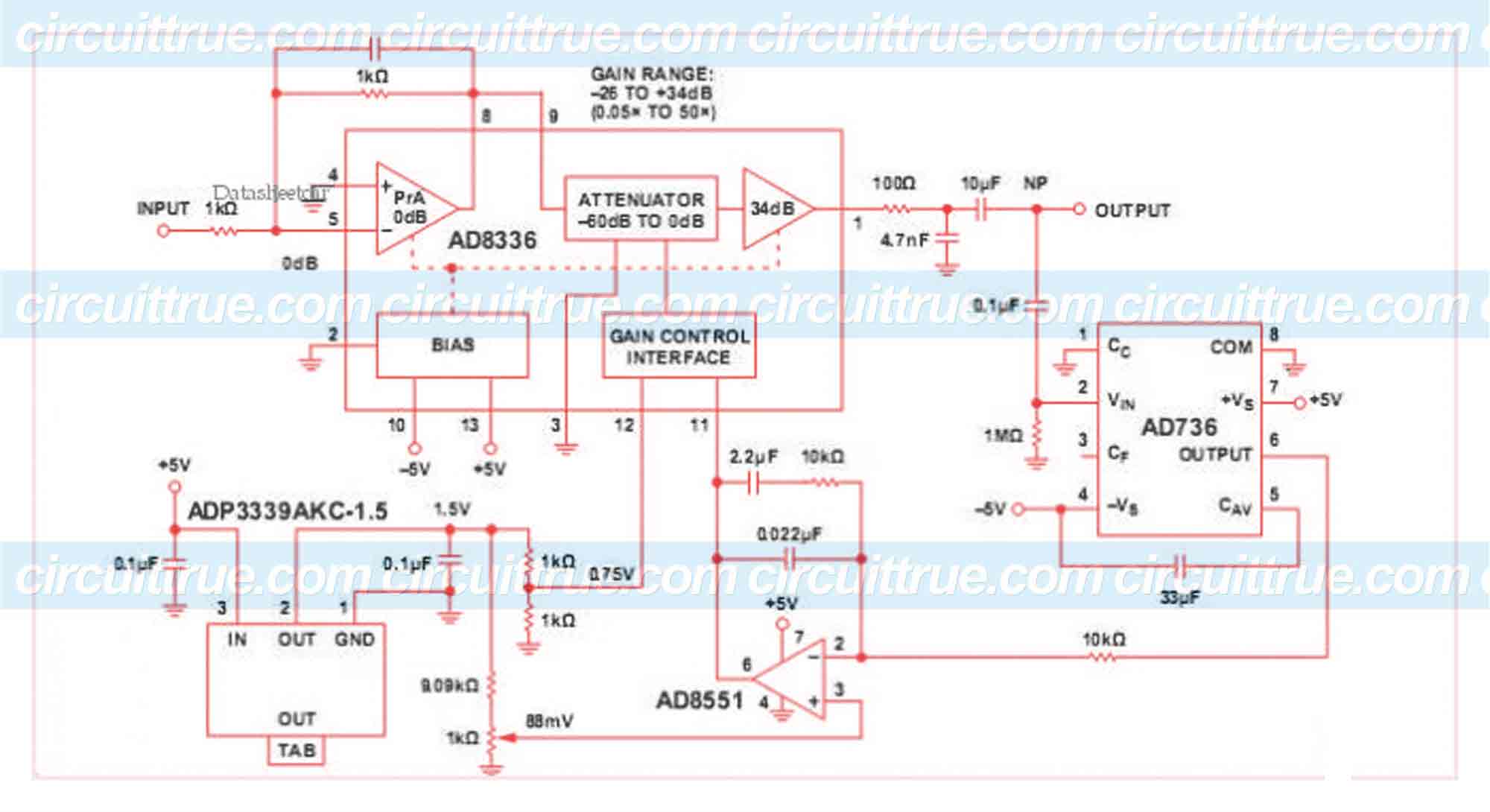

I don't have Pspice, and LTspice doesn't want to play ball with your AD8336 model :(.
Hi Alec
Thanks for trying. I know it wouldn't work with LT spice, and that made me switch to pspice.
P.S: Do you mind installing Pspice. Only if its not a trouble for you
Also, anyone else who can help me with this simulation in Pspice.
Will be really grateful for the help.
Sorry, I don't wish to clutter my already-crowded PC with Pspice. I don't even know how effective the 'lite' (free) version would be.

Kindly look through my first post to find the exact circuit I'm trying to simulate.

Hi eTech
Thanks for your revert. I'm posting the schematic that I currently have. I have added the libraries for the the components to my design by editing the simulation profile but even then I get errors that the sub circuits used by the AD8336 component are undefined (although the .cir file for the AD8336 contains definitions for the sub circuits as well). Similar errors come up in case of AD736. I'm clue less as to why the same library file does not cater to the sub circuit definitions as well. As of now there is no error in the input signal generator. Please help
P.S: I'm including the .cir files for the AD8336 and AD736 below and also the errors that show up in the system log when I try running the simulation.

ERROR(ORPSIM-16152): Invalid number
ERROR(ORPSIM-16049): Values must be monotonic increasing

Hi
Sorry...I'm familiar with pspice code, but I don't run pspice.
You'll have to find out why orcad can't find the the subckt files.
However, might be the "uselim" param causing problems again.
