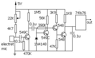

I'm writing my first message in this forum. I have a question for whoever wants to answer it: I've built a clap switch from a schematic I've downloaded from the Internet. Of course, it doesn't work at all. "Scopeing" here and there I've found the problem. Mainly that circuit works as follows: There's a microphone that receives the clap. The signal gets filtered and amplified through four NPN's and finally it's used as a clock signal into a flip-flop which toggles with each clap. The problem is that, after the amplifier section, the signal is not strong enough to excite the clock input as a logic high level. A mean, the signal should be a 5V pulse to make the flip flop change its output. I could find, when clapping, I don't get more than 0.2V in the clock input. I think a way for solving this problem is trying to reach 0.7V. With that voltage I would be able to make a simple common emitter amplifier work and then I would have those 5 needed volts into the clock input of the flip-flop.
So, all I ask for are some ideas to solve the problem. How would you convert a 0.2V pulse signal into a 0.7V, or even better, into a 5V pulse?

OK Here it is the schematic. Is not a Picasso but...
Thanks for posting the schematic. Unfortunately, everything after the first amp stage seems odd. I'll bet you have a better output at the 'C' of the first transistor than you do at the flip-flop input. Here is a circuit that will work.

"Unfortunately, everything after the first amp stage seems odd. I'll bet you have a better output at the 'C' of the first transistor than you do at the flip-flop input."
Odd? Does it mean "unusefull"? What is a 'C' of a transistor? The output (in this case, the collector)?
I know the circuit you propose. I didn't make it because, once ago, I made a simulation with Orcad and it seemed it wouldn't work (lol) But, please, tell me, how do you know it'll work? Like with English, I'm not the "Master of Electronics" :D so I can't really imagine why you know it'll work. One detail I would like to comment is that the output of the circuit will arrive into a PIC microcontroler which will afterwards control the relay. So I don't need anything afterwards the flip-flop.
Another question, how do you know, just having a look at the schematic, that transistors 2, 3 and 4 are unuseful?

The circuit seems of to me. I think you are messing up somewhere.
How did you check the voltage at outout of amplifier? I am sure you must have done it with multimeter. In normal conditions, the transistor must be in saturation, keeping its collector (C) voltage at Vce(saturation)= 0.2V. When you clap, the transistor goes into cut-off (for a very short duration) pulling the collector to 5V and immediately back to 0.2V. Thus you see only 0.2V at the collector using multimeter. If you want to see the 5V pulse, use a Digital Storage Oscilloscope.

Looking at the waveforms, I can conclude that there is a problem in your amplifier section. Have you tried adjusting the sensitivity pot? Even if the value of pot is kept too low, it may cause problem.

By "odd", I meant that the circuit was not what I expected. I expected a more common amplification process like each output feeding the next input or a push-pull arrangement. When I saw your schematic and looked at what was happening to the output of the first transistor, I thought that there MIGHT be a problem.
By "C" of the transistor, I meant collector.
I must admit that there is no way to really "know" if a circuit will work. Even with a simulation program there can be buggs. However, when building a simple switch with such a complex design (an amp can be a single chip or a single high-gain transistor), there is a high probability of failure. Knowing how a circuit will react is a combination of experience, familuarity with the parts being used, and the application of a simple design. That is to say that if you have a simple design that is built with common parts, you can use your experience to work out the problems. . . knowing it will work in the end.
As to the second circuit - count the parts. Look at their arrangement. Immagine how the second IC would work with a clap - rather than just any loud sound. It's not so much that I "know" it will work; it is that I have high confidence that I could get it to work.
Having said all that, I believe you will get your circuit working. I think your gain is being blocked by a transistor that is not working. Perhaps you could use that oscilliscope at each stage of amplification (one at a time) to discover a point where there is no gain.
