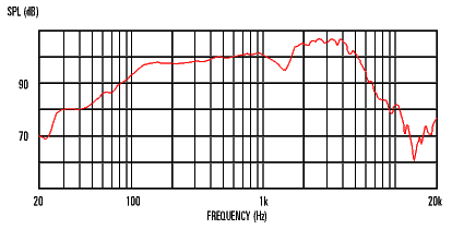

You mentioned a Celestion speaker for rock guitar music. Did you see its horrible frequency response?
Nothing below 100Hz.
A null at about 1.5kHz.
A peak from 2kHz to 5kHz then a sharp drop above so that all the important high frequencies are missing.
It makes a sound like a muffled buzzer, especially when its amplifier is clipping. [/b]Real[/b] music has no distortion and has wideband frequencies.
Maybe you have never heard a recording of a symphony orchestra. It should have no distortion and have wide bandwidth. If your amplifier and speakers are good then it sounds the same as live.
An amplifier with distortion has a difficult time trying to sort out the frequencies and makes millions of harmonics that cause FUZZ.
A modern low distortion amplifier has no harmonics that are caused by distortion and has a wide bandwidth to produce the harmonics of the music. The high frequencies of the music "sizzle".

You're focusing on ONE INSTRUMENT. When you hear music as a whole, it encompasses an entire band. The band as a whole will cover the entire spectrum. But each instrument alone by itself will not...and you wouldn't want them to.
I used to run sound for a living...and like most sound engineers you end up having to pull certain frequency bands out of certain instruments (like shelving 80Hz and below out of guitar and vocals because there's nothing down in that range that's usable to those instruments) in order to place them in the mix where they belong. Drums are mainly sub low frequencies and high frequencies. Bass guitar the same. Guitar and vocals fit in the mid band with vocals extending into the high pass band. Together as a whole they will encompass the entire spectrum.
If each instrument covered the entire 20Hz-20kHz spectrum, you'd have instruments burying each other in the mix. The fact that they DON'T cover the entire spectrum in the mix is what allows the human ear to discern one from the other when they're played together. ;)

In regards to Celestions and their "horrible frequency response"...that is the sound of rock. "Horrible" is subjective...it's an opinion. It may very well be horrible for the music you listen to, but for rock they are the speaker to go with. Again...different strokes for different folks. ;)
Correct.
Horrible sound is horrible. But severely distorted "rock sound" is worse.
Correct.
And again that is your opinion. I'm sure there are many others that would beg to differ. "Horrible" is a human derived thing. It cannot be proven...it is a matter of opinion. Just because you think something is horrible does not constitute it as fact that it's horrible. ;)
