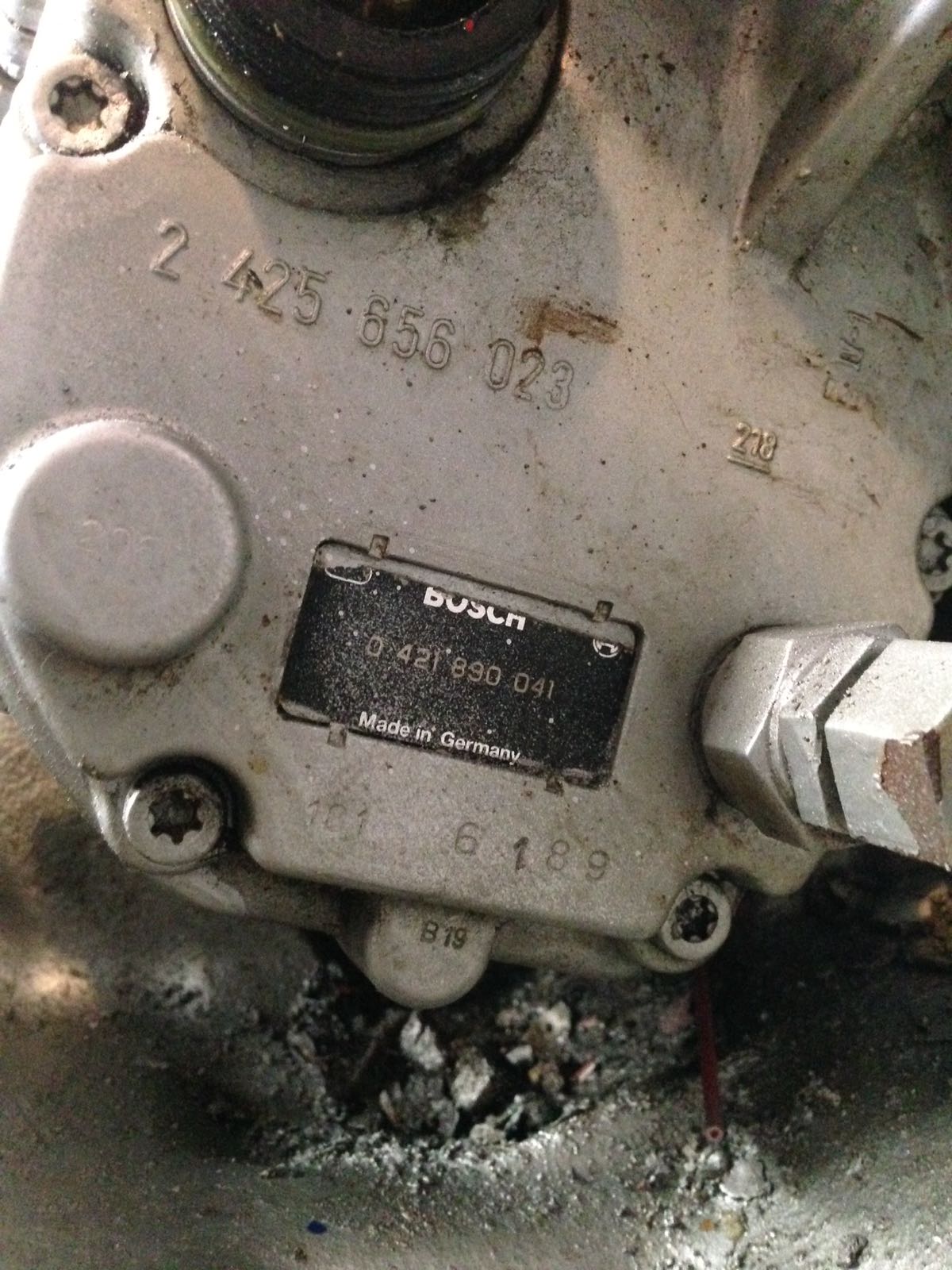

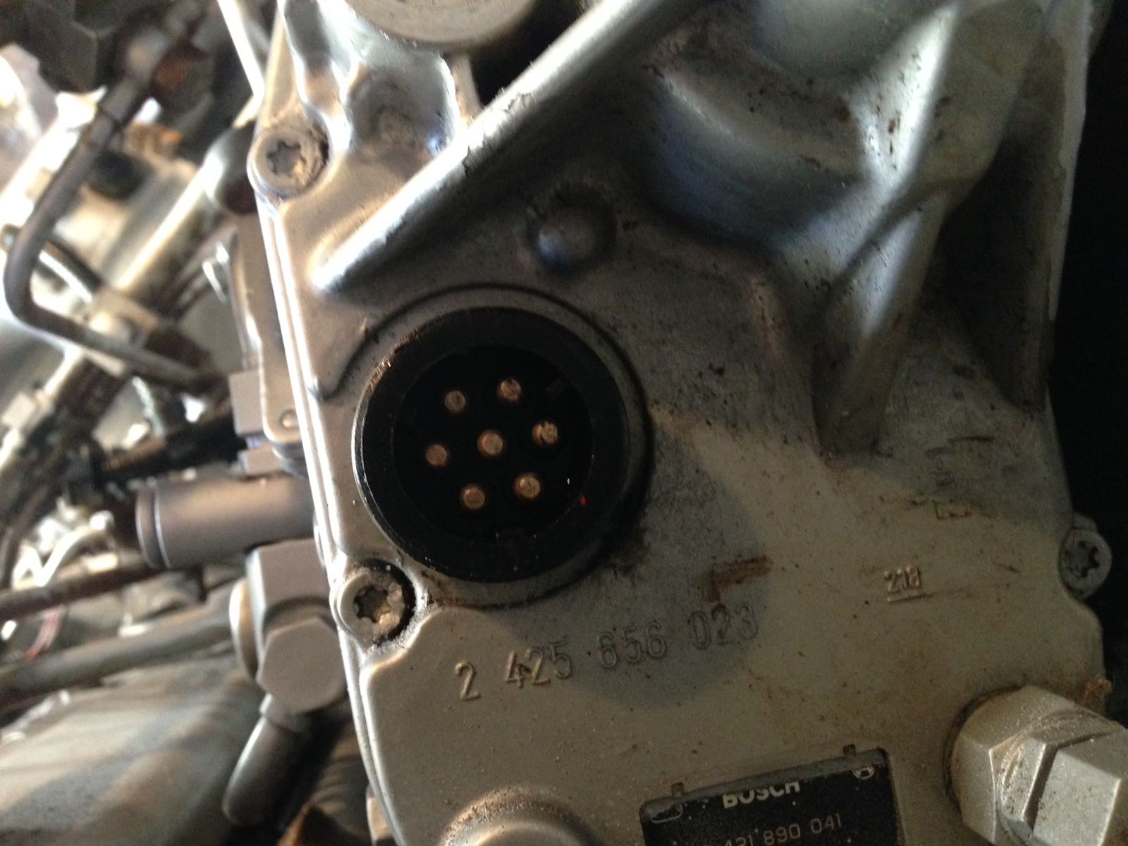

Now next step is to find a good and simplest way to manage the marine engines as my customer can´t assume new original equipment. The marine engines use a Bosch 24V injection pump, attached. Any good ideas? I have some idea but I don´t know if I´ll finish this project due to different reasons.
