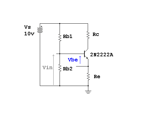

Lets see if they like the new circuit that they had been asking for :)
BTW Winterstone you said you did the circuit i posted with the emitter resistor in your post #21 but i didnt see that there. Perhaps you did not like that circuit, so here is a new one more to your liking perhaps.
I think that maybe audioguru and Winterstone will see the light here soon. I agree that proper biasing is a good idea for a practical circuit so that we can hopefully make the circuit work without having to hand pick the transistor for example. But the questions here are a little different as you will see. In the mean time, i have drawn up a new circuit that seems to satisfy audioguru and Winterstone in their unending quest for the better biased circuit. Now you both have one, lets see what you can do with it :)
Attached is the circuit you have been waiting for. It has an added emitter resistor and also now has two reasonable valued resistors on the base to bias it. The values are as follows:
Rc=1000 ohms
Re=100 ohms
Rb1=54970 ohms
Rb2=7000 ohms
and also:
Vbe=0.65 volts as before.
Vs=10v as before too.
So there you go, the circuit you've always wanted. Now calculate Ic. Or do you not like that circuit either?

Sorry to be so late replying to this op question. What is Ic was the question on post #1. With a 0.65V CVS (constant voltage source) directly connected to the b-e junction, the Ic value will be indeterminate for a short time, then the bjt will likely incinerate.
Placing a CVS right to the b-e junction incurs thermal runaway. Most practitioners are familiar with Ebers-Moll equations. If the b-e junction driver is constant voltage, then the Ic value based on the forced value of Vbe is simply given by E-M as :
Ic = alpha_n*Ies*(exp(Vbe/Vt)-1) - Ics*(exp(Vbc/Vt)-1).
This equation was published in 1954 and has been in use since. Gummel-Poon eventually replaced E-M by adding a factor for Early voltage, but for now we can use the above equation E-M.
For some reason this equation is usually chopped up into pieces. The 2nd term is almost always omitted, but if the bjt is saturated, the 2nd term is all-important. The b-c junction is also relevant since a bjt is really 2 bjt devices in 1. The "collector" (lighter doped n region for an npn) is the collector in the right side up bjt. The collector is also the emitter for the upside down bjt, where the "emitter" (heavier doped n region) is the upside down device collector).
I bring this up because w/o knowing base current Ib, we don't know if the npn device is saturated, or active. If in the active region, then the E-M 2nd term is small enough to neglect, so the 1st term suffices as
Ic = alpha_n*Ies*(exp(Vbe/Vt)-1). Here, "alpha_n" is the Ic/Ie value in normal (right side up) operation, and upside down device can be neglected. Herein alpha_n can be called just "alpha". So if active region is assumed, the 1 term equation holds. But the "Ies" factor in front, is the saturation current value of the b-e p-n junction, which varies w/ specimen and w/ temp as well.
The variation of Ies w/ temp alone, is far greater than part to part and temp variations due to beta (h[sub]FE[/sub]). In addition to variation, Ies has a positive temperature coefficient, herein called "tempco". As temp increases, Ies increases non-linearly to a large extent. So if a CVS is connected directly to b-e junction, we get Ie and Ic per Ebers-Moll. Since current through the device raises its temp, the junction temp increases due to power dissipated.
Ies also increases due to temp increase, which greatly raises Ic. At higher temp, Vt does increase, making the exp(Vbe/Vt) smaller, but not enough to offset the increase in Ies. Thus bjt junction temp increases, Ies increases, Ic increases, power dissipation increases, temp increases, Ies increases, Ic increases, well you get the rest.
We have thermal runaway. This is why constant voltage is never directly connected to a bjt b-e junction. Thermal instability and runaway are inevitable. The circuit in post #1 can never be employed, regardless of application, i.e. signal gain, switching, log amp, etc.
Later in in this thread, some posters illustrated resistive divider types of biasing schemes, that should prove beneficial. The key to designing a bjt stage whose behavior is predictable and thermally stable is to control Ie, the emitter current. Ic = alpha*Ie is the transistor action equation. Alpha is around 0.99 +/- 0.01, so bjt behavior is very stable when alpha is employed as the control parameter.
Using Ie to control Ic is the way pros do it. Using Ib to control Ic is not good, because of beta variation. Ic = beta*Ib is thermally stable, i.e. a CCS (constant current source) forcing a base current value results in an Ic value dependent on beta, which has specimen and temp variation.
Using Vbe to control Ic is never done for any industrial application. I believe this question is the basis of a more theoretical discussion as the circuit in post #1 is not usable at all. I will elaborate if needed. Cheers.
An antique 2n2222A transistor can have a very wide range of hFE from 75 to 325 then I think the emitter resistor value should be 1/10th the collector resistor value, not 1/100th.
A more modern 2N3904 has a much smaller range of hFE from 100 to 300 and can use a small emitter resistor value.
Hello,
MrAl, may I direct your attention to post#16 of this thread, where I have analyzed/calculated exactly this circuit you want me to calculate now?
Do you remember that it is not the first time that I have asked you: Why don`t you respond to my postings?
Perhaps you haven`t read them?
May I add, that I really don`t understand your ironic attitude ?
From a technical point of view it is not too important which circuit I like or dislike. Technical properties (performance, exactness, stability) are the points that matter only.
But I am very happy that - finally - you have arrived at the biasing scheme that I have promoted several times in this thread (see again post#16).
With kind regards
W.

I am not sure what you are talking about here, is this for the new circuit? I had already stated that the values are as follows:
Rc=1000 ohms
Re=100 ohms
Rb1=54970 ohms
Rb2=7000 ohms
and also:
As predicted you now no longer like the emitter resistor even though it matches your specs, and now you attack the type of transistor too. I dont understand that at all.
Winterstone:
I see no analysis of this new circuit ANYWHERE in this thread. And in post #16 you apparently have done a simulation not an analysis, and that is a different circuit because it has different values.

Winterstone:
Perhaps it would help to read my post #16 a second time.
I did NOT "apparently" have done a simulation - I rather have calculated (and this word even appears in post#16) the circuit.
For your understanding I will summarize what I have done:
* The classical design starts with selection of a suitable value for Ic (in my example I have chosen Ic=1mA) and a corresponding amount of feedback (example: 1 V DC feedback with Re=1kOhm)
* Based on these values: Calculation of a resistive divider for the two cases: Vbe=0.65 and Vbe=0,7 Volts.
* Finally, checking this design using simulation.
* Result: The calculated resistor values allow Ic=0.92 mA (Vbe=0.65V) resp. Ic==0.96 mA (Vbe=0.7V)
* Summary: The classical method to bias a BJT (resistive divider with dc feedback) allows a design that is very stable against parameter tolerances and other unwanted deviations and uncertainties.
That was the goal of this exercise.
What do you want me to do in addition? To use "different values" (as proposed by you) ? I am not your pupil.
Rc=1000 ohms
Re=100 ohms
Rb1=54970 ohms
Rb2=7000 ohms
and also:
Sorry. I looked at your schematic yesterday but it had no resistor values and I mistakenly used 10k for the collector resistor instead of 1k.
But why not use a modern 2N3904 that has a smaller range of hFE instead of the antique 2N2222A (in an old metal case??) that has a wide range of hFE?
Also, the modern 2N3904 datasheet has many more spec's and graphs than the antique transistor.
Hello Winterstone and audioguru,
