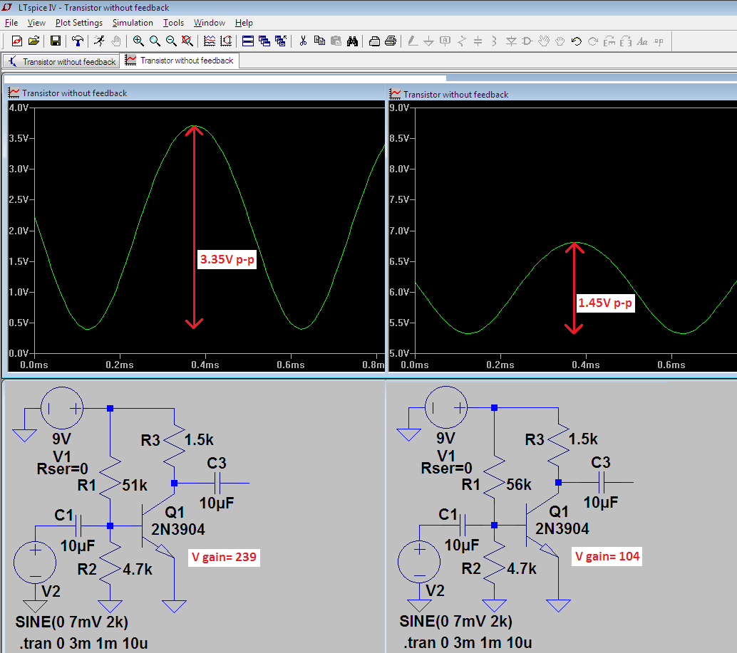

I think with a higher hFE the voltage gain increased because the transistor was biased away from cutoff.
When near cutoff (low hFE) the exponential gm causes the gain to be reduced. With a high hFE then the transistor is operating away from cutoff and is more linear with a higher gain.
I show the transistor without feedback and with slightly different biasing causing it to be near cutoff and away from cutoff.
EDIT: The signals are measured at the collector.
Hi. :-)
I see a circuit, and I see an analysis, but what is it you're trying to claim exactly? Higher hFE should not increase gain, perhaps?

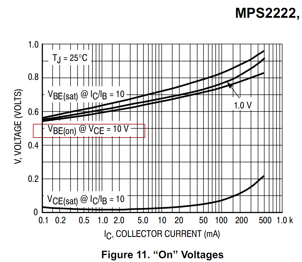

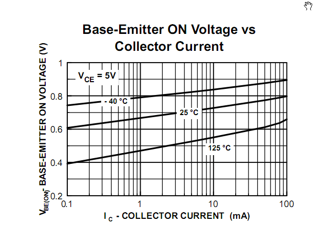

We have a 2N22222A transistor and 1k collector resistor (Rc) and a base emitter voltage (Vbe) of 0.65 volts. This is powered by a 10v supply source Vs. What is the collector current Ic ?
You have to find the saturation current Is, and it is not in the data sheets. However, you can apply a voltage at the base terminal, say 0.2 volts, and read the current of the collector. Then apply the formula iC = Is*exp(VBE/VT) and get a value for Is.
What Eric did was he found spec's on the data sheet that specify the collector current with Vbe.
No he didn't. He found the point on the β vs Ic curve that matched the product of β and the Ib he calculated. There is no Vbe vs Ic anywhere on the data sheets.
Jony130,

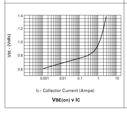

Interesting question arise. For example if we use a Shockley equation (Ic=Is*(e^(Vbe/VT)-1)) to find ( determined) the collector current for a constant Vbe = 0.65V the collector current should also be constant? Or maybe I missing something in Shockley equation?
No, you are correct. The trick is to keep Vbe constant and compensate for temperature changes.
OK so for RB = 518KΩ and Vbe = 0.65V and I assume Is = 10x10^-15 and VT = 26mV and β = 50.
Is can vary between 10^-15 to 10^-12 amps. That is a 1 to 1000 range. How can you assume an Is unless you measure it like I outlined above?

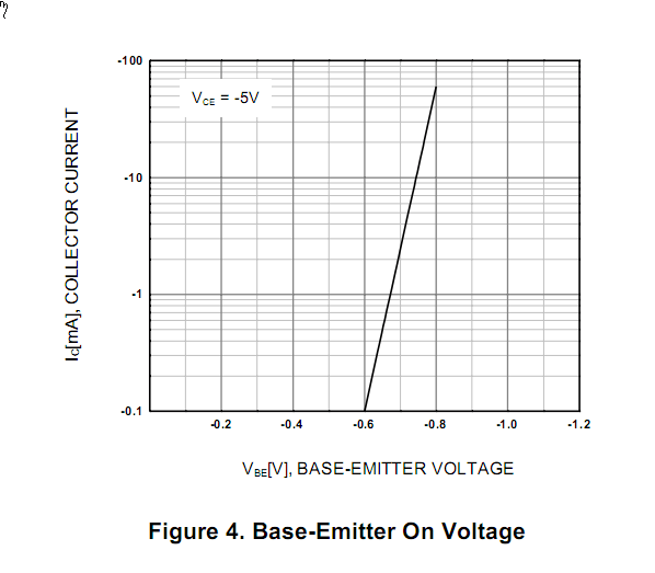

hi Ratch,
Many transistor datasheets do show Vbe versus Ic.
E.
They are for "typical" devices. But there is a wide range of Vbe that is listed in the text of the datasheet since each transistor is different.
The datasheet for the MPS2222 shows that Vbe is a minimum of 0.6V and a maximum of 1.2V.
You cannot buy a "typical" transistor, you get whatever they have.
No one said you can buy 'typical' transistors.
Its the Vbe curve thats shown on the the datasheet which was being questioned, nothing more.
Please read the posts before replying.

hi Ratch,
I know how to create a Vbe curve,
As a test trial I have plotted the 2N2222 Vbe using LTSpice, I will post later, up to the elbows in over riding priorities at the moment
Eric
