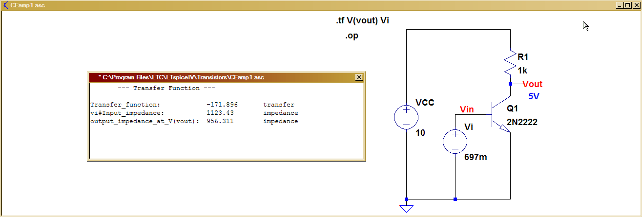

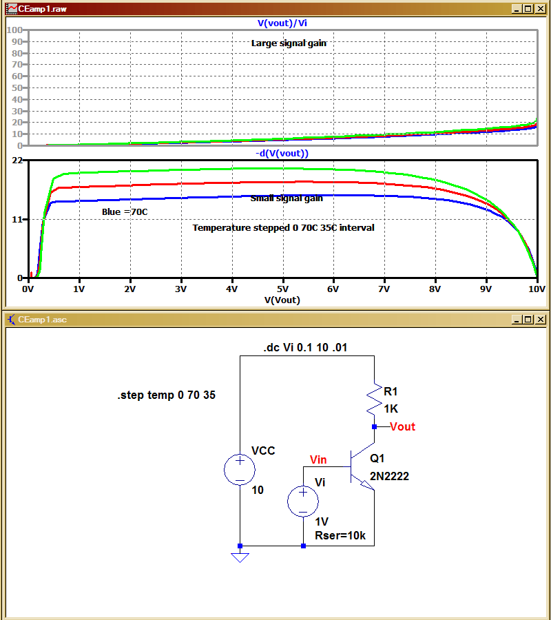

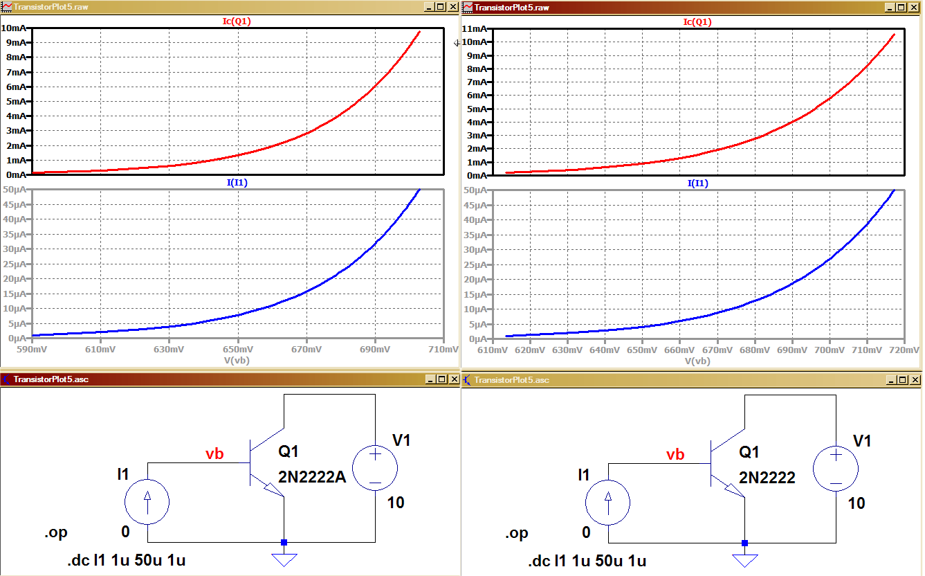

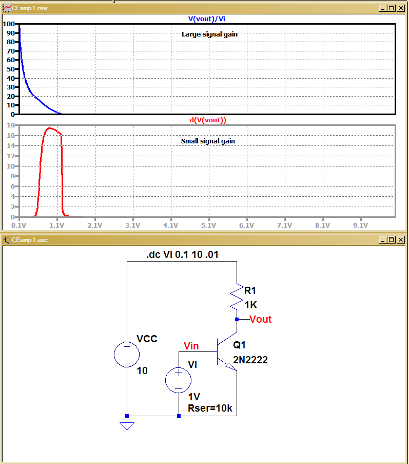

Eric,
I did a reasonable search on the net for a Vbe curve of the 2N2222, but not an exhaustive one. Anyhow, Is is easy to calculate by taking two simple easy measurements.
Ratch
hi Ratch,
As stated earlier here is the image for LTSpice plots of a 2N2222 and a 2N2222A, Vbe values.
Eric
Eric,
I do not quite understand why you seem to consider that a 2N2222 transistor is a 'special' case when used in Al's first posted transistor circuit.??
If he had say, used a 2N2222A or some other low signal transistor, for which there are many posted Vbe plots.
Easy question to answer. The data sheets and yourself indicate that the 2N2222 is a general purpose low power transistor. The data sheets listed in the link below call it a switching transistor.
I would appreciate a link to just one site that gives a Vbe vs Ic graph of a 2N2222(A). I checked the link below, and only two or three manufacturers or distributors even had graphs for that transistor.
http://www.datasheetcatalog.com/datasheets_pdf/2/N/2/2/2N2222A.shtml
Your argument against the method used to solve the circuit using the datasheet would not be viable.
My argument was not against the method used, but Al's description of the method. Any way an Is value can be obtained is fine with me.
Another member keeps rambling on about 'typical' transistors, we ALL know that the datasheet plots are for typical devices, what else would the transistor manufacturer quote, 'non typical' devices, I do not think so.
I think he meant to say something like "typical devices within a particular model family".
The information in a datasheet is provided as a guide for the 'typical' performance of the device, so that the designer has a point of reference.
And also max and min parameter limits.

Yes thanks to Eric for doing the spice simulation and the plots so we can take a look at that too.
I also found the required data sheet that i am looking at in more detail now, so Ratchit here is the link:
https://www.electro-tech-online.com/custompdfs/2013/06/PN2222A.pdf
That's not the same data sheet i have but i think the Vbe vs Ic curves are the same.
I have also now had time to calculate values for the non ideal transistor constants and am looking at that in more detail too now. I should be able to post equations soon.
But what i see in the W. Hill post is not quite the same thing. I've done that kind of design for ages now and i have promoted that technique years ago, but that is not the same as using the Shockley equation. The fact that we can force a voltage across the emitter resistor is a much simpler way to bias the transistor. It basically steals the idea from the "constant current" transistor circuit which we all know and love :) In other words, create a constant current circuit and then allow the base current or base emitter voltage to vary with the input signal and we know we get a change in output with amplification because of the Rc/Re ratio. That's not Shockley, that's more toward what Claude had mentioned. It's certainly easy to prove that if anyone is in doubt about this. So basically what this means now is we have another bias method in addition to the Shockley and Beta methods.
The curve fitting i did for the 2N2222A came out quite well, with a max error of about 5 percent in collector current so im pretty close now but need a little more time due to other things in the house at the moment.
If Jony is reading this and cares to do a few more measurements, what we need here is a set of measurements of Vbe vs Ic, with collector emitter voltage say at least 5 volts and hopefully not vary too much.

Two more plots from LTS for the 2N2222 transistor CE amplifier.
E
