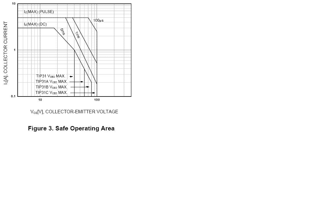

Your choice of little TIP31C and TIP32C transistors as output devices will probably blow them up quickly. The peak current is nearly 100V across 8.2 ohms (many speakers have an even lower impedance at certain frequencies) which is 12.2A!
Also, these little transistors have a very low Safe Operating Area.
Now you are using full darlington arrangements for the outputs along with their double-junction voltage loss. A better arrangement would probably be is to use NPN-PNP combinations, with an NPN emitter-follower driving a PNP common emitter and vive-versa. You know what I mean?

The peak current is really ≈50V/8ohms (≈6 amps), but it is still too much current and power for these transistors.

I don't think he's ever suggested using TIP31/31 as the output devices?, he hasn't got the output stage designed yet (or at least not the webpage for it!) - I presume these devices are simply being shown in the crude overall theoretical diagram, not with any thought of their use!. Probably to allow a simulator to run?.

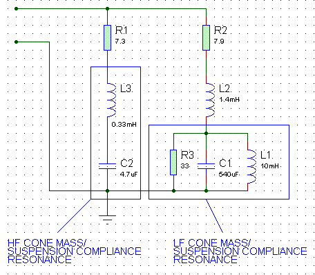

I found a speaker model **broken link removed**, which I sim'ed on Jef's amp. I ran an AC sweep to find the speaker's minimum impedance frequency, which was at DC and around 160Hz, and the maximum impedance frequency, which was about 27Hz. The maximum phase shift points were at 20Hz and 35Hz. I ran the amplifier at a gain of 11, with 80V p-p into the speaker (probably not possible with real transistors of the types in the circuit). Peak currents varied from 800ma to 6.2 amps. Even at the extreme phase shift points, currents in the output transistors were well-behaved class B waveforms. I can post them if anyone is interested.
This model obviously doesn't represent all speakers, but the waveforms were so clean that I believe the results would be similar for other speakers.

Ah-ha! Your speaker doesn't have a cabinet so it is just flopping around, the air pressure in front of it sneaks around its edge to fill the vacuum behind it. It isn't doing any work! Please tell your sim.
With a cabinet, it will resonate with a 2-pole response if sealed, or a 4-pole response if ported. Those extra poles will make it appear highly inductive and capacitive near resonance. At clipping, the transistors will have the 100V supply across them at the same time as a peak current of more than 12A. Those little TIP transistors will release their majic smoke, and probably short, blowing the speaker!
That is why 140W RMS into 8 ohms amps like this one is supposed to be, have many high-voltage and high-current transistors.
The model seems to be OK. Here is a model for a typical enclosed 2 way speaker system.

Audioguru, I am no audio guru. I'm just an old analog engineer with a lot of experience, but very little in audio. I was aware that I had no enclosure model in my sim, but had concluded from some web sites I visited that they were pretty much second order effects. If you know that they are important to amplifier power ratings, could you point us to some references? I have trouble imagining a speaker/enclosure network that would have 180 degrees phase shift between current and voltage, and still have 8 ohms impedance (I think that's what you are implying). Perhaps the back EMF effect you mentioned could explain it? When one measures the inductance if a speaker, does the effect of the magnet get included? I would think so, but I never thought about that before.
I agree that TIP31C and TIP32C are too wimpy for this application, and I also agree with Nigel that they were probably not intended to be the final selections.

Let me take away all doubt: I had no intention of using this transistors, i never looked up a datasheet, i just chose a random transistor for drawing purposes. I never thought this could lead to this kind of a discussion.
I MUST say that I feel it woul be a very bad idea to build this schematic an actually use it, its only pictured there to give a global theoretical overview of a three stage amp.
