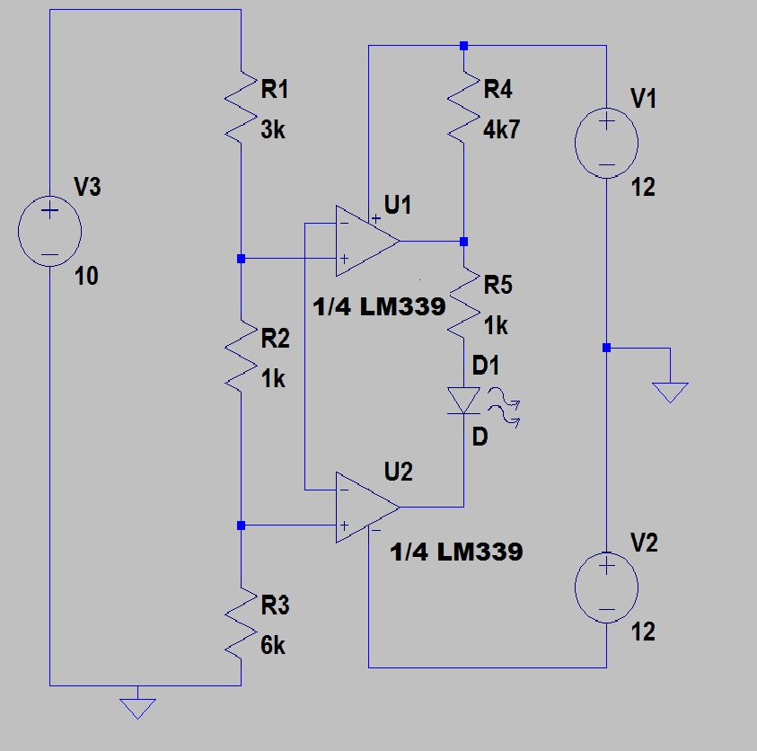

As far as the Ramura's problem of the circuit not working ... I'd like him to post his circuit.
See attached schematic.
Hi again,
Yes you are right Joe, i read the whole thing wrong :)
I also did not see the first statement up top.
I also just noted that they seem to be indicating two separate IC packages even though each package contains 4 comparators each.
The fact that it turns OFF with too low a voltage (too negative) means it can not be that the opto output is shorted.
Anyway, it looks like the bottom comparator is bad, being stuck 'on' and thus always applying a negative cathode drive for the input of the opto.

Correct me if I'm wrong, but I interpreted post #10 to mean that the faulty component is R4. That when R4 is increased to 90 Mohms (ie an open circuit in place of R4), CR1 will light. Thats why I said what I did in post #13, did the physical test whose result was reported in post #15, using the circuit posted in post #21.
You are missing the input to the comparators. You have the reference established, but no input signal. Indeed so. How else can we test the assertion made in post #10, of an open circuit in place of R4 (please correct me if my interpretation of that assertion is wrong) ?
Well if R4 is open how do you explain that we get the LED to turn on with some inputs and off with other inputs? I dont think the circuit would respond in any way at all with very high R4. That was what Joe was pointing out.
I only wish Joe had pointed this out in his post #11:( ... that would have meant I had no need to do the time-consuming physical test. Anyways, I'm glad that we are all in agreement, even if it took a short detour and a slightly round-about way to get there in the end :).
Well that's the most likely, or else we have to believe that the resistor R4 can fail in a way that is perfectly within a range of high resistances that cause only one comparator to switch from saturated output to open output (the upper one). It would also have to allow the correct turn off. That seems less likely. With completely open R4 though the two outputs should be saturated (about -14v out of both comparators).

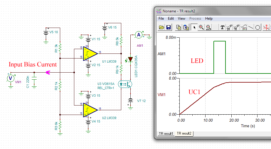

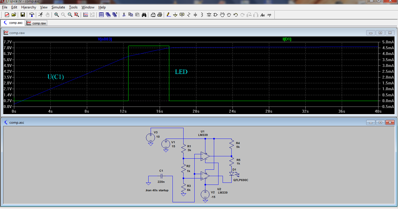

If the LM339 model is the same, the different simulation software give the same results, so there is no difference here.

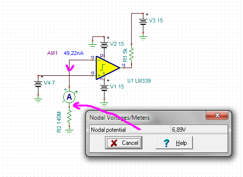

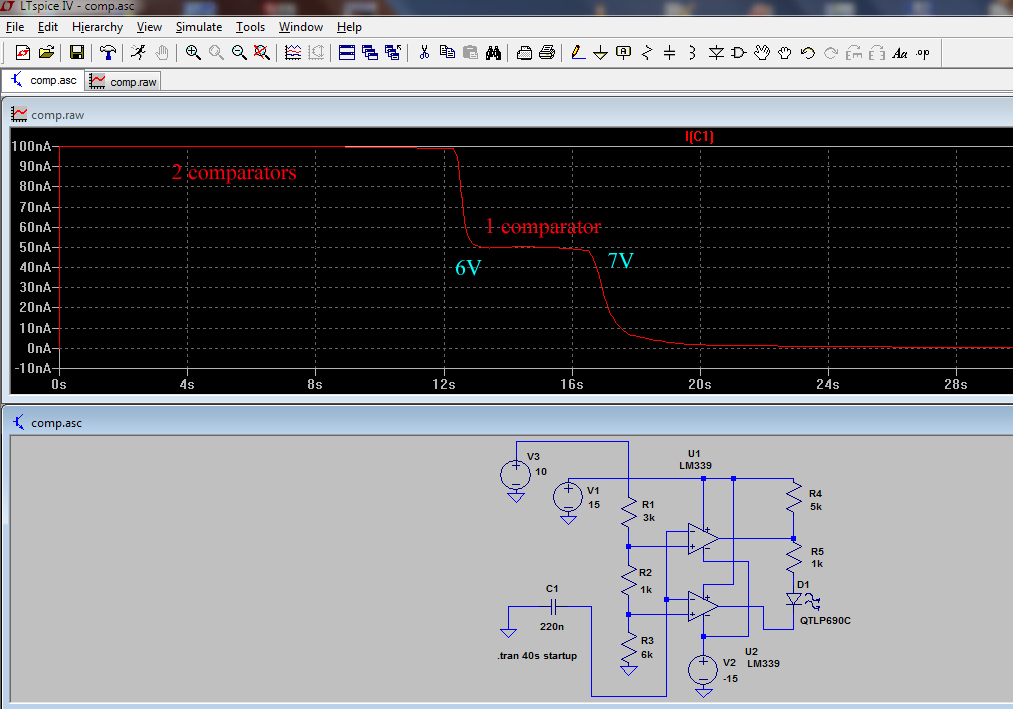

The main point that the input bias currents of the comparators generate voltage on the examined resistor. These currents are quite low so it needs a high value (but not infinite) resistor to have this voltage between 6V and 7V.
In practice some of them differ from the simulation because the specified current range is wide and it is something else by every piece (?-25nA-250nA). So the value of the resistor will be different but there is always a range where the voltage is between 6V and 7V. That time the LED is active.
This can be some hundred Mohms. So everything works fine, the comparators are not faulty.
The bias current in the simulation model is ca. 50nA. The indicated resistor range is related to this.
It is quite difficult to try it out with high value resistor. But you can use a good quality (film) capacitor instead of it. The bias current charges the capacitor. You can see the result here.

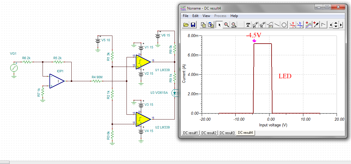

I will agree that nano amps through a hundreds of megaohm resistors will product the necessary voltage to energize the lamp. R4 would be the last of the suspects on the list.
The circuit as designed, you can sweep the DC from Vee to Vcc. The window is specified by the divider string. With that in mind, sweep the circuit with R4 at 90 Megaohms. You will find the LED energized from Vee to Vcc. The first part of the problem statement stated the LED was not energized when the input was more negative than the window, but was energized at zero volts.
If you want to build it, just remove the lower comparator and place the diode at the negative voltage. You should be able to replicate the problem statement.
If you change Vee or Vcc, you might want to recalculate the window resistor.
If I were troubleshooting the problem, I would sweep the circuit to confirm the specifications. R4 resistance being changed is low on my list of suspects. Confirmation of the others would take precedence.
The LED is not energized when the input is more negative than the window (6-7V), but is energized at zero volts.(?)

Yeah, but doesnt that switch too soon? I would think that "too negative" means -7v or more, but with the 90M resistor it switches at around -5v, which in itself would not be working then. -5v is not "too negative", only -7v is too negative. That's the way i see it.
But if you want to define "too negative" as -5v, then you have to tell us why they designed the circuit to switch at -7v instead of -5v.
If you insist, then you should also realize that it would be very hard to get the resistor to fail within a certain range of resistance even if we accept the -5v switch point idea. I guess it could happen though. Resistors i have seen from the past usually go out of tolerance, but not by more than 100 percent. If the resistor breaks for some reason then we have to believe that it still makes some contact. Could happen i guess, but this is still if we accept the -5v idea as being ok.
