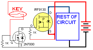

I have the same question for IRF9130 & IRF6215, I built a circuit for my buggy and at present, I have to turn it on and off, and I want to set it up so it turns on when key is on and off when the key is off and no power drain. I'm going to bench test it, but if someone KNOWS for sure already, let us know please.

Thunderchild,
The gate of a Mosfet draws zero DC current. It causes no DC voltage drop.
It needs smoething to discharge its fairly high gate capacitance for it to turn off quickly.
Kinarfi,
Your 2N7000 Mosfet is connected upside-down (drain and source are backwards).
The 2N7000 Mosfet has nothing to turn it off.

A resistor from the gate to the source will completely turn off a Mosfet.

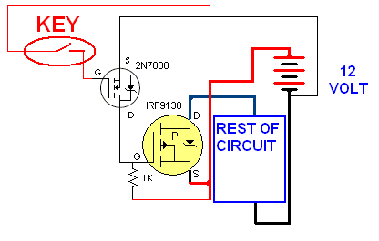

It's actually connected correctly, (unless I'm looking at the edited version) but the circuit is drawn so wierdly, that it's confusing. V+, B+, VCC and VDD should always be shown connected from the top of the diagram. V-, VSS and ground always shown connected at the bottom. Does need something to turn it off though.
Thanks, the first one never got edited, here it is redrawn with a resistor to turn off 2n7000, I just took what I had and deleted most of it and added what I needed, sorry for doing it wierdly.
Kinarfi
redrawn schematic, added 1 k resistor from the gate of 2n7000 to negative.
audioguru,
Judging by what you said earlier, I would guess that I need a resistor on each of these FETS also, correct?

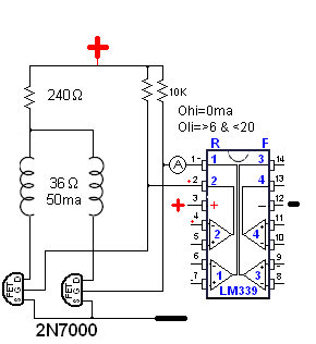

Earlier in this thread, it was said that I needed to discharge the FETs, in the attached drawing, do these FETs need to be discharged or are they discharged by the LM339? If I need to discharge them, would you make a suggestion please? If I put a resistor from gate to source, it also acts as load when the LM339 output is high and a series resistor with the pull up resistor when low, or is that backwards?

You have the Source and the load's power supply for your Mosfets at the same voltage (-) so they won't do anything.
The mosfets need a fairly high current to quickly charge and discharge their gate capacitance but the "low power" LM339 comparator has a minimum output current of only 6mA.
The output of an LM339 comparator goes low when it is active. A resistor from the positive supply to the output (a pullup resistor) makes it go high.

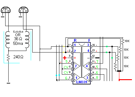

Earlier in this thread, it was said that I needed to discharge the FETs, in the attached drawing, do these FETs need to be discharged or are they discharged by the LM339? If I need to discharge them, would you make a suggestion please? If I put a resistor from gate to source, it acts as load when the LM339 output is high and lowers the output voltage and as a parallel resistor to ground with the output when low, or is that backwards? As I analyze it, a resistor from gate to source in this case is useless.
Thanks,
Kinarfi
Edit
Using a 12 volt supply, I also need to lower my pull up resistors to 2K to have 6ma min current. Correct?

You are driving an inductor that produces a very high voltage when its power is turned off. A reverse-connected diode should be wired in parallel with the inductor to shunt the high voltage spike into the power supply instead of blowing up the Mosfet.
Are you a politician? You keep not answering the question by changing the subject. The inductor is maybe 100 - 200 turns of wire from a small brushless motor hand wrapped around a reed switch and connected so one winding cancel the other winding to create and exclusive OR gate.

He is answering questions you have not asked yet, but will definitely cause you problems down the road.
Increase the gate resistor if it's lowering the voltage too much. A better, but more complex approach is to use a totem pole driver circuit. One transistor to turn on the mosfet, another to turn it off. This way you don't have the constant current draw from the resistor.
Best is to use a mosfet driver IC. They can have high side boost circuits, built in optoisolators, over current fault protection, etc.
I think the OP's question still hasn't been answered, so I'll give it a try. The answer is yes, the IC is providing a path to discharge the FET gate. The question then becomes, does the IC sinc enough current to turn the FET off quickly??? I could go through the datasheet and come up with an answer, but this is your design; your responsibility. If it turns out that the current isn't sufficient, then you'll have to try some of the ideas for increasing the drive. Good luck.
