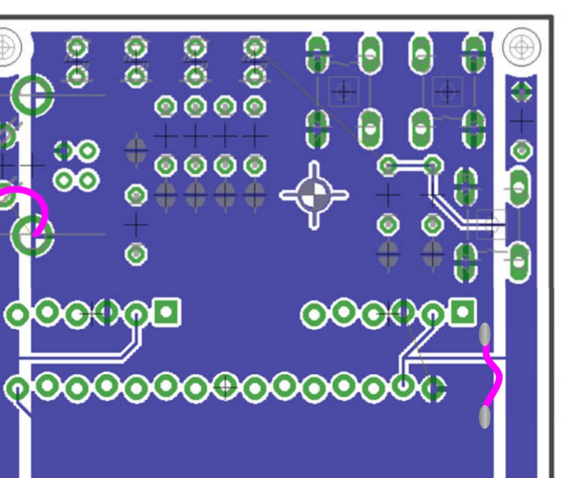

after reading post 96 I found several other issues concerning the 555 connections. Made changes and will recheck the ground.
Made all the traces .020
Sorry but the traces you pointed out are the 5+ . No problem with ground as there are 3 ground connections to panel stuff on the board.
Thanks for looking as it has helped locate other issues (555 connections)
The area I circled is part of the ground plane. Because of where you have located components and pads, and the isolation (clearance distance) to other traces, this "island" of ground plane has only one connection to ground, by the trace from pin 2 on the IC to the ground connection pad at the top of the board. It's desirable for the ground plane to be as continuous as possible, with no large marginally connected peninsulas.
I am all-to-familiar with breaks in the ground plane. On the original TAP-28 board, last minute changes to the header connectors meant there wasn't clearance for the ground plane to flow between the header pins. The left the top central area separated from the bottom central area in the drawing below. A jumper had to be soldered across the break for the ground plane sections to be connected and for the broad to work, as shown by the magenta jumper on the right side of the board.
Since I have experienced this problem, it's one I'm extremely careful about. I'm trying to pass some of my experience on for what it's worth [comment redacted].
The two ground plane areas on your board are not completely disconnected, but they are connected only by a 12 mil trace. Not good form and may well lead to problems particularly with an audio circuit.
I've tried to help. I'm done.
I appreciate your input, in fact I look forward to it. I wouldn't have seen the issue with the 555 connections.
Will see what I cam move to correct the ground plane issue.
