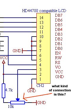

Hi all I'm wondering if someone could tell me what kind of a connection this is. I know they are showing a 10K resistor but how does VO (pin 3) connect to that resistor? It's shown connecting in the middle of the resistor, how is this possible???

You have to glue your wire right in the middle of the resistor, preferably on a black color band, which conducts better.
:p
Just kidding. It's a variable resistor/potentiometer, probably to adjust the contrast on the LCD...
ya I tried that Hot glue idea and of course it did not work very well! hehehehe. No really tho. Thank you for the help, i'm new to electronics and I know most of the circuit diagrams but had forgotten about this one. Thanks again.
