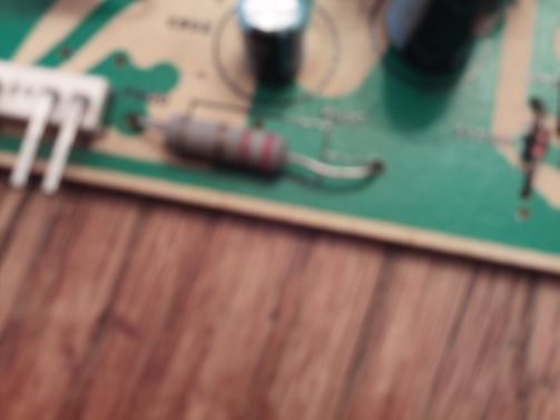

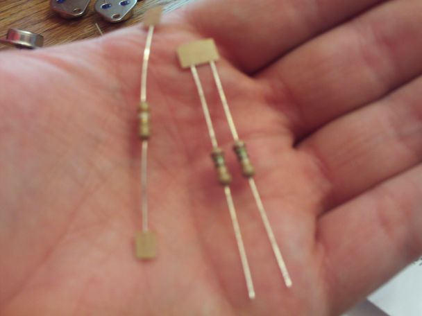

hey everyone i hope your all doing well, i need a little help with your knowledge, im fixing an old arcade monitor by recapping it etc and im needing to replace 2 diodes resistors or whatever they are with 2.2ohm 2 watt of the same thing, but im not sure which is which, im including a picture hoping you can help, thanks for looking
first picture is what im replacing and the 2nd is what i think im replacing with

pictures are not that clear but it looks like a 2.2 ohm resistor
sorry for it not being very clear it was the best i could do, is there any color markings i should look at to be sure the ones in the second are as follows, by itself is gold,gold,white,orange and the 2 that are together are brown,green,black,gold
make sure the colours bands are exactly the same, make sure the replacement is at least as physically big
the ones pictured in the 2nd pic are not the same as the one in the first, however i did get a kit with the monitor when i got it that has 2 of the same ones in the first pc though a little smaller and blue instead of grey but the color bands are the same and thanks soo much for your help :)
there are some flameproof 2 watt resistors that are smaller than the standard 2 watt size. if those came with the repair kit, they're probably ok. i've seen 2 watt resistors the size of a half watt resistor, the difference in heat dissipation being the body material and special coatings that vastly improve the dissipation over standard resistor types. they are very expensive compared to standard resistors.
