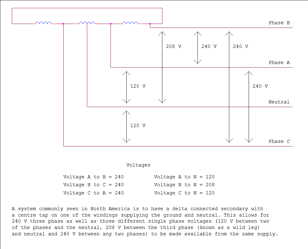

Based on what you posted I am going to venture a guess that your building power or at least your panel you measured is configured like the attached drawing. This is a 3 phase delta with a wild leg (sometimes called other names for the leg). That is the only way I can see you getting the numbers you see. That would explain panel neutral to one leg as 120 and another leg to neutral as 208 as well as leg to leg as 240 volts.
What I don't get is why the panel is configured that way. Generally you would have the two phases common to the neutral run to the panel for 120-0-120 rather than the high leg on one side giving you 120-0-208. The only need I could see is if they used 1/2 the panel for 208 volt lighting? Beats me? Additionally you mentioned two Brown wires while in a high leg configuration generally orange is used to denote the high leg (phase B in my attached cartoon). Not to say it is always done that way.
Anyway as tcmtech suggest what you could do is place the leg of your machine needing 120 volts on the 120 volt leg to neutral. You will still have your 240 volts line to line (phase to phase). You just need to be damn sure you get the right side or you will feed 208 volts to the 120 volt requirements of your machine. That or find the source for the panel (likely a transformer if a large facility) and run your machine off what would be phases A and C using the phase center tapped neutral. That would involve a new service line and disconnect. However, given the choice I would use tcmtech's suggestion.
Anyway, that is my guess as to why you see what you see. Don't take it as gospel. :)
<EDIT> After reading your post again when it comes to washer / drier systems the washer is generally 120 VAC but the drier uses 120 VAC for the motor and 240 VAC for the heater elements. Thus the longer drying time. Is this building commercial or residential? Anyway,if I am guessing right as to the configuration you will need 120 VAC for the drier motor. </EDIT>
Ron

Based on the responses here I tried pulling the power off each branch to replicate the 240v measuement I got when reading the two brown wires at the panel- and the voltage across the two hots on the back of the dryer read 240v... and right side to ground came out 120v...
*drum roll*
I though it was too good to be true when MRS CRAZYLEGS reared her ugly head right there on the back of my dryer... 215v and a punch in the face.
Ron
You can't hide from Mrs. Crazylegs... even though I seemed safe and home free, she was there waiting and lurking in all two hundred and eight shadows. It sounds dangerous and surely out of code but I considered lifting all ground and neutral from the panel and making a physical detached separate (from the mains) ground connection near the appliance. It was more an academic "what if" I wasn't foolhardy enough to do it - but I'm curious what the individual sides to ground might measure - would she still be there waiting?

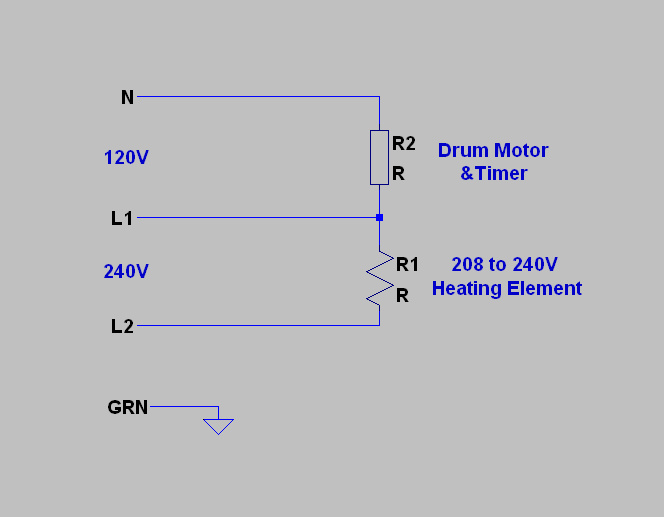

I just moved into a new building and I'm having some trouble adding a 240v line in for my stackable washer and dryer....
Isn't it as simple as wiring it as shown below:
You just need to make sure that the Drum Motor/Timer bits wind up connected to the Line that has 120V with respect to N. You should be able to tell which terminal at the rear of the Dryer is the one that powers the Drum Motor/Timer. That is the one to hook to the Line that has 120V on it.
The way you hooked it up the first time wasn't it :D
The other side of the heating element will take care of itself.

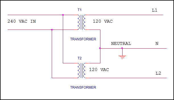

Ron,
While I probably can't convince the landlord (without paying for it) to run this separate line - I might be able to get them to swap at the jump point, the line that is currently high leg with the other "missing" hot line. I'm hoping it's as easy as that and there wasn't a specific reason for it in the first place.
P
Br find the source for the panel (likely a transformer if a large facility) and run your machine off what would be phases A and C using the phase center tapped neutral. That would involve a new service line and disconnect. However, given the choice I would use tcmtech's suggestion.
Ron
I had one of those when I lived in Italy to power my stuff off their 220 volt mains. The problem is this. You have a 5 KVA transformer with a 2:1 ratio. Thus if ran 208 in you would get 104 out or if you went Line to Line with the 240 you have you would get 120 but I am not sure how that would work out.
However the attached should work. You would use two transformers to do it like the one you linked to. That or find a 240 VAC isolation transformer with a center tapped 120 volt secondary. That is basically what I built in the attached. You can ground it where I show ground on the center tap. I suggest you ground it.
What tcmtech suggested should work? I'll have to look at that more in depth.
This is getting expensive but after you explained the location I understand why you see what you see. I have no clue why they did it that way.
Ron
Hi Mike,
It seems so... But I think the majority of the dryer controls run off the 120 side... the gas dryers don't have 240 so they make them this way so they can share common parts and reduce cost... I think the only thing getting the 240v is the heating element and I'd guess it's probably triggered by a relay run by the 120v side.
I can't read schematics very well but I did find these online:
I can scan a higher res if anyone thinks this would be of any value or help - they are kind of hard to read like this...

My reading of the diagram you posted confirms that if there is 120V between N and L2, it wouldn't matter if there was only 108V between N and L1.
